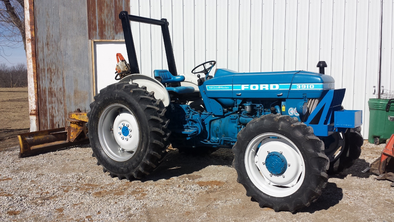

You didn't state budget.
I bought this tractor last December for $8500. I put an additional $2500 in it including new rear tires. It fits my needs perfectly. I too, didn't need an FEL tractor. Just a reliable, long term mid sized tractor. It takes a lot of pressure off my larger FEL tractor to do those simple daily chores.
47HP, diesel, 8F/4R shuttle transmission, 3cyl diesel, limit slip front axle, rear diff lock, draft control/position control 3pt, pwr steer, wet brakes, CAT II 3pt.
