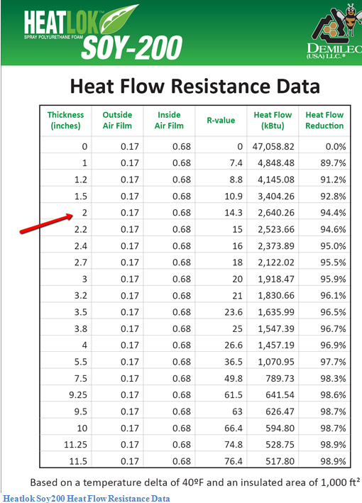

I don't know enough about spray foam insulation to disagree with you, but I would be very very sure that you are right before committing to so little ceiling insulation. From what I understand, the ceiling accounts for the vast majority of heating loss and where you see the biggest return on energy savings. If it where me, I would look into increasing the thickness of the roof and add fiberglass to the spray foam to get at least R60 by lowering the ceiling height.

I appreciate the advise Eddie however I just don't believe the cost vs return is there. Even talking to our installer he recommended using 4" in the ceiling as opposed to paying for the additional 1-1/2". One thing to remember about the spray foam is the elimination of air movement. If installed correctly you are creating an airtight envelope that just is not possible with fiberglass insulation. This is one of the biggest advantages of spray foam. Closed cell also acts as a vapor barrier. Here's a chart showing the heat flow resistance as the thickness and R-value of spray foam increases. There is just not much gain past our current plan of using 5-1/2" of foam.
Edit: Eddie - Please don't think I'm downplaying your advise. It is greatly appreciated. I am by no means an expert on insulation, I'm just going by what I've researched and my discussions with other builders. I'm always open to suggestions provided I can show a return on investment. I'd love to hear others advise, especially those with some expertise on spray foam.

I don't know how much difference it makes, but I noticed the foam chart is based on a 40* temperature difference. That is on the low side for heating in northern climates. For example, it's 4*F here at the moment. 4+40 = not warm enough :laughing:
I'm glad the OP shared the chart as I wouldn't have guessed at those percentages per inch of foam. My personal experience with a cathedral ceiling was not all that good. But, it was fiberglas insulation, not foam. Lots of heat goes up to those ceilings. Mine was 23' high, and not nearly as many sq ft as this one.

January is our coldest month here. In looking at the the average temp for our location we have an average high of 38 and average low of 18 for the month of Jan. The 40 degree difference is a little low but not too far off for our location.
Our cathedral ceiling in the timber frame portion of the house is about 1000 sq/ft so there is going to be a significant amount of heat rise. This is where I'm hoping the tightness of our insulation envelope is going to pay off with foam. We have a couple of large fans going up there as well to help keep the air moving.

I'm sure you will be fine with five inches of foam. I only suggest more because this is the only time it will be easy and affordable to max out how much insulation you have. I was just watching a Mike Holmes show on DIY Network and hey he was working on a house with 2x4 rafters. They added two inches to the rafters and spray foamed them to get five inches of foam. This was somewhere in Canada, and he felt that was plenty, so I'm not saying you are wrong, or it will be bad at all.

One thing to keep in mind is the R value of the wood, which if I remember correctly is 1. So you may have an R value in the foam of 38 in 2x6 construction, but for the 1.75" width of each 2x6 you only have an R value of 5.5 which can be significant across a roof/wall. Maybe not so important in Missouri, but is meaningful in Minnesota or Maine. Putting a 1" foam board over the inside would double the R value in the area of the 2x6's.
