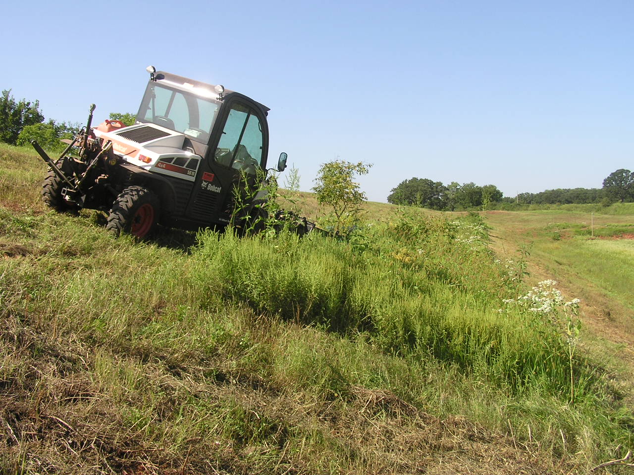

This is what 30 degrees of body lean looks like on a "26.6" slope.
View attachment 345534 View attachment 345535
Mowing it with the Toolcat.
View attachment 345536 View attachment 345537
xxxxxxxx
This is some serious pucker factor! :eek:
Serious pucker for sure, but if you imagine/estimate that the center of gravity (cog) is about 6" above the PTO, (probably lower with the deck down), it would have to tip a lot more before the cog crosses the vertical line that rises straight up from the fulcrum (the outside of the downhill tire). Granted, one wants a safety factor for the dynamic forces if you hit a bump or turn, but i bet it can tip almost twiuce that angle before it goes over. (I'll let you test that theory though :D )

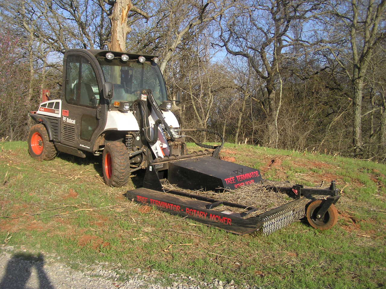

Yep, the cog is probably lower. The PTO is hydraulic and the engine is under the passenger seat.
The 7' brush hog weighs 1800 pounds. If it loses traction, it just slides downhill!
In heavy brush I curl up to raise the front mower wheel and put more weight on the Toolcat's front axle.
