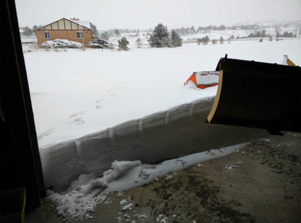

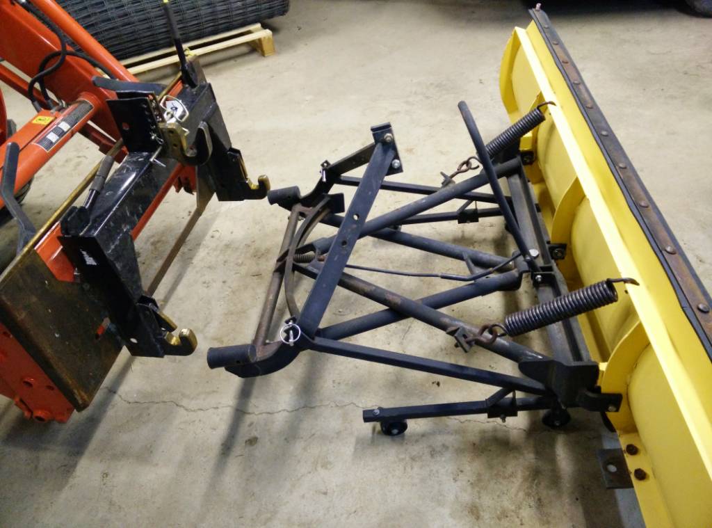

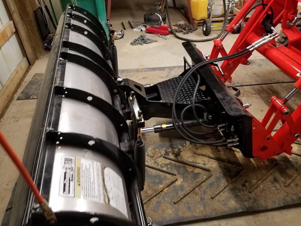

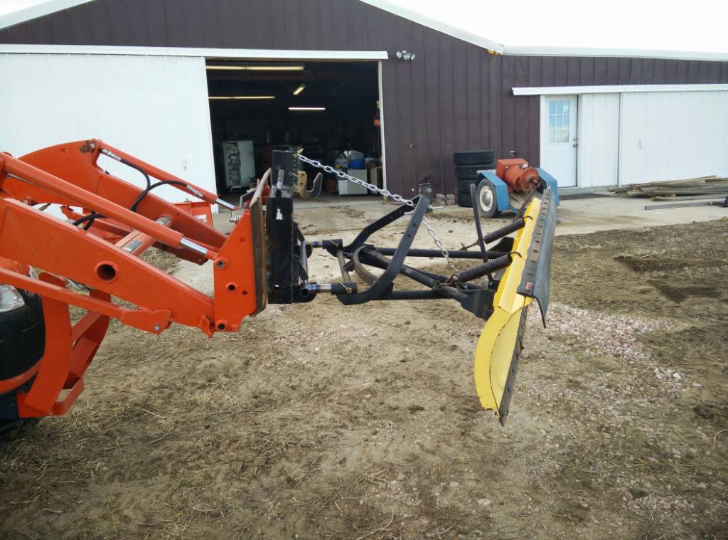

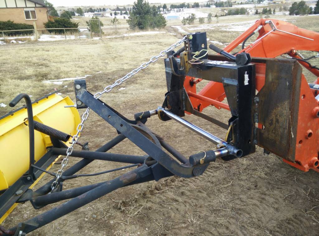

The small snow plow I picked up for my old L3200 had around 15 degrees of side to side tilt natively. I built the SSQA to 3pt adapter which had lots of vertical float. But the hosisontal float was OEM design & somewhat irrespective of the angle. Its tipped over in the photo with snow.
My new new SSQA plow for my new L4060 (old one ran off with the L3200) doesnt have any float in any direction. Not much snow to plow with it last year but it did ok. I may rebuild it for some vertical & horizontal float, but I'm not desperate to do so, yet. IMG_20150117_153817.jpegIMG_20150117_153836.jpegIMG_20141102_161237.jpegIMG_20150222_102438.jpeg20170110_213656-1.jpeg
