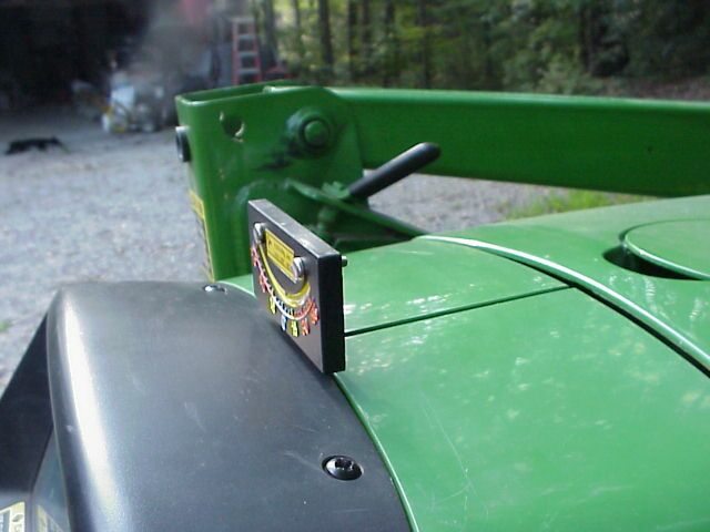

Attached is a photo of my mounting of a tilt meter. I didn't like the bracket that came with the meter (it was just to big). I just bent up a piece of sheet metal to fit the slot, and under the instrument panel and down to lock it in place. I slotted one hole for vertical adjustment.

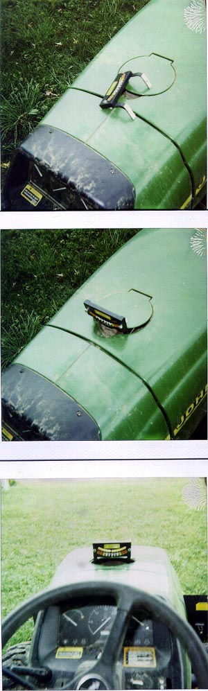

Okay, let's see who's done the WORST installation of a tiltmeter on a 4300 (or on anything for that matter.) /forums/images/graemlins/grin.gif
While I'm still thinking about an ultimate location, here's what I came up with as a quick solution. Requires no drilling, no tape, no modifications whatsoever.
I'm not sure if this is sheer brilliance or sheer insanity. /forums/images/graemlins/grin.gif
If anyone likes the idea, maybe they would consider making a mount that is customized for the fuel cap door....?
Best....Bob
p.s. Sorry about the filthy tractor.. just got done working and haven't washed yet. Also, my wife cracked up when she saw the weird mark on the hood, and realized it was my finger over the lens of the camera. /forums/images/graemlins/blush.gif

Jim -
THAT is one clean installation. I may have to re-engineer mine! Is the mount just wedged in under the dash cover?

Steve,
The bracket has a 90deg bend toward the instrument panel, goes under the lip of the panel cover and then down about 1/8". Tightening the panel cover screws secures the bracket . It takes a little measuring, bending, checking the fit, bending, checking, etc. I made the mount base narrower than the upper part to minimize the effect of the curvature of the cover.
No holes were drilled in the tractor as with my other modifications.
