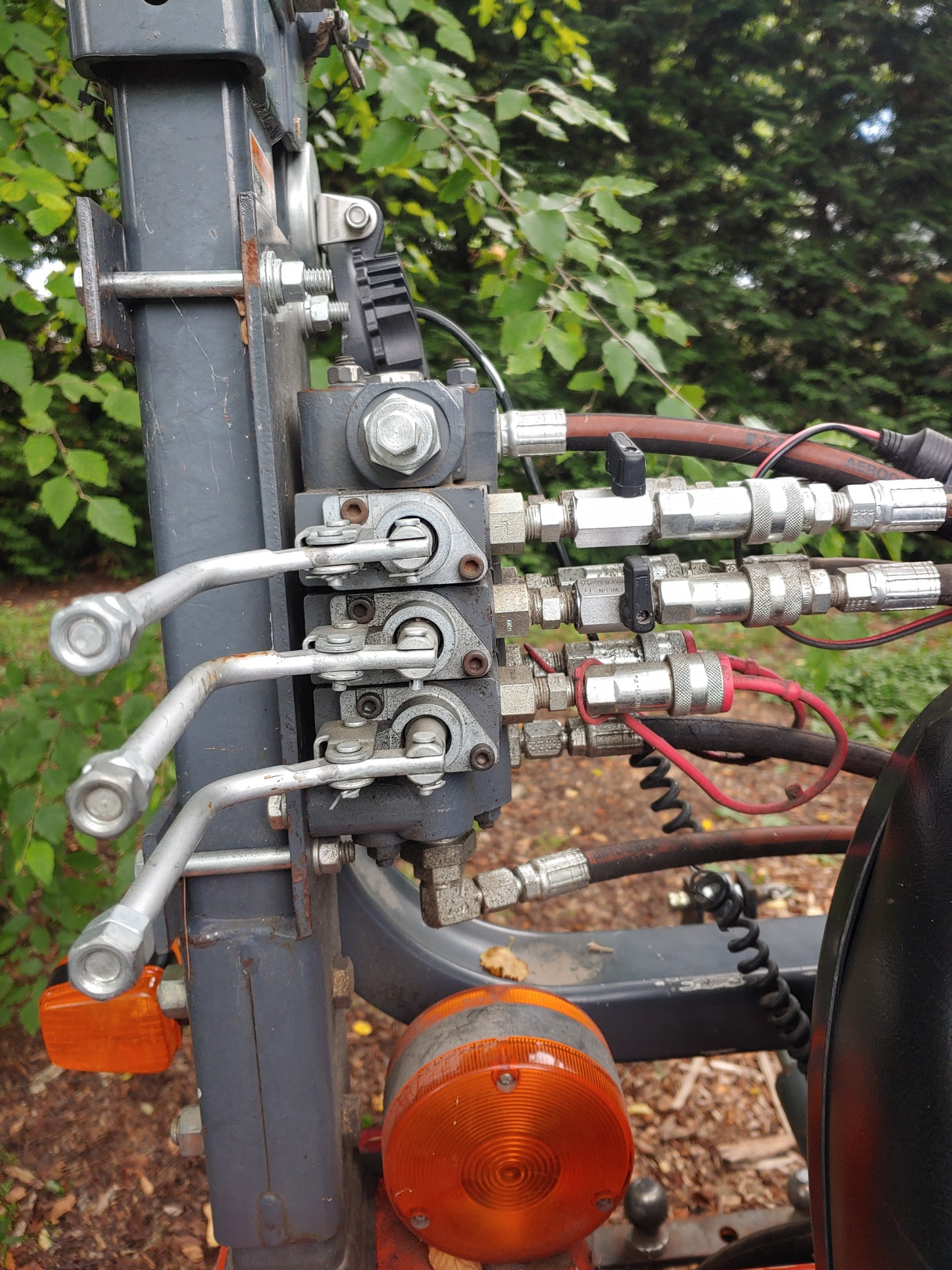

My valves leaked down so I added this ball valve right at the valve so I can easily turn it on and off, got it at the local hydraulics place for about $5. I open it when I need to use the valve, close it when I'm mowing or using an implement.
That's an easy one. You just throw it inline on all the rear remote hoses?
Half the hoses, it's only needed on the hose that's pressurized by the weight of the implement. Here's mine:

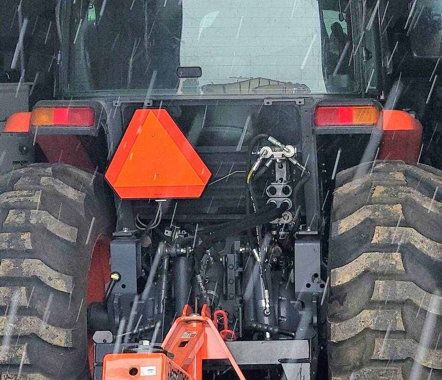

I've had around 7 valves on the 3 rear remote slots on my L4060hstc. The 1 on my toplink will leakdown in a bit over an hour these days. It's the best one of the bunch. I have no lockout on that so float still works. The sidelink has a DPOV valve on it to prevent leakdown. That breaks float though. I never used float much on my sidelink, but couldn't deal with lack of float on the toplink.
Did you get a new side link that has a DPOV on it or did you get a DPOV separately and mount it somehow?
Dealer put on a DPOV valve mounted above the 3 remotes. Looks ugly & they didn't put in QDs, but it was under warranty as they couldn't get valves that worked properly in. I never take my TnT off, so it's not that big of a deal. The top holes in the 3 stack QD holder are now empty.
