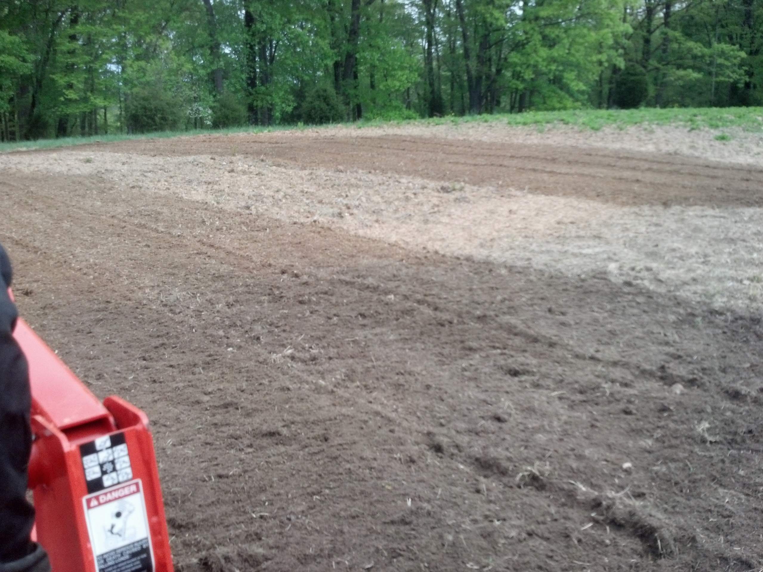

The only time I use my turning plow is for breaking new ground. After the land is turned I allow it to break up during the winter. I used to use a disc to prepare the land for lists/beds. Now I use the tiller. I have a 72" tiller. It takes no time to get the soil ready for planing using the tiller. My disc waits for larger project than the garden. Here is a food plot I prepared that way.

Buy the tiller...forget the plow. With the tiller you can bounce over roots and rocks or obstacles and the surface will remain fairly smooth. A plow will leave clumps of dirt or roots and grass and be difficult to smooth. If I was doing hundreds of acres of hayfields in the stony glacial till of New England, I would own a tiller and never touch the ground with a plow and harrow. I have done both and in soil like yours the tiller wins without exception.
