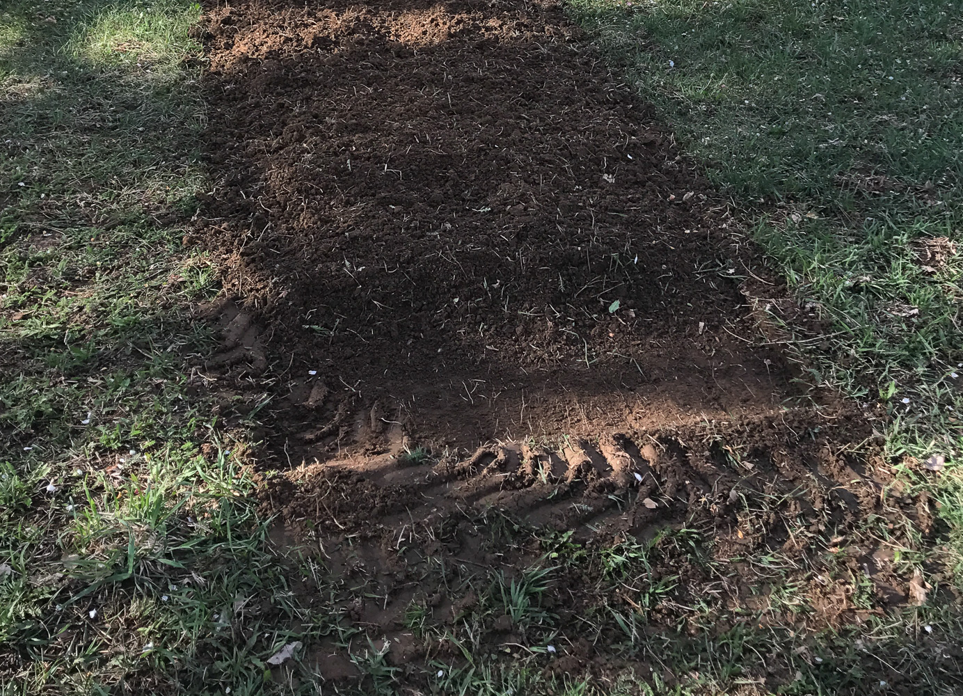

I received my compact tiller last week, and am ready to get going with the garden prep -- however, need some advice on tilling and amending the first time! My soil is 60% Sand, 20% Clay, 20% Silt. It's rock hard when it's dry. Surprisingly, I haven't found many rocks in this soil, since I moved in a year ago.
The primary area I'll be working with my Massey Ferguson SCUT is 80x30. Last summer I worked a patch of it - about 1/4 of it by using a single bottom plow (for the first time) and hand tilling it. The ground was rock hard at the time, and it required a lot of work. Ultimately, I'm looking to break up the entire area and till in about 1.5-2" of compost.
Over the past two weeks, we've received several inches of water, either though rain or snow. It last rained maybe 4 days ago. No rain on the forecast before next weekend. The ground is no longer frozen, and our typical last frost date is May 10, though I'd like to get some cool weather stuff going soon. The attachments I have are a single bottom plow, a 48" tiller, and next week I should receive a subsoiler/potato plow.
My questions are:
- what to do when (given current state of moisture)
- how many passes to make
- how to be sure I'm not over-working the soil
- when to apply the compost (and any natural fertilizer) in the process
- if I need to have some period of time between passes and planting (possibly with a final pass) to kill any weeds/grass
That's a lot, so thanks in advance!!

I would plan for about April 23rd or so and till it deep as you can about 1 mph. Then add the amendments you want and till perpendicular to the first direction before planting at about 1.5 mph. That should do it.

Unless you have a lot of trash to turn under, I would skip the plow. When you get the subsoiler, try it out across the patch and you will find out real quick if it is too wet. When you can pull it at 12 inches and the soil breaks into chunks, then do the patch with 18 to 24 inch intervals, then consider tilling twice. The second tiller pass should get you down about 8 inches. Should be good to go. Compost should go on after the subsoiling.

I tried tilling a test patch yesterday, and the tiller seemed to do well with the moisture in the soil. However, even with the feet all the way up, I could only get 2.5 inches deep with a single pass (pic below). Does this sound right? I wish it could go deeper on a single pass. Perhaps I'll have to make 3 passes with my tiller.
Here is what I'm thinking - let me know
This weekend: either till first pass 3" or plow to start the weed killing process
Next weekend or the following weekend: run subsoiler. till down to 7 or 8" (2 more passes). Add 2" compost. Till final pass at 90 degrees (and faster) to turn in compost. Make rows.
4 weeks from now: plant

Either the subsoiler or plow will be handy to loosen the soil to allow the tiller to cut it up. If there is a lot of trash, i.e. ground cover, the plow will turn it under which will be nice. If this is the case do not till it back up - just let it rot. Do understand that rotting plant residue does consume nitrogen though but how much is available in your soil is relative to what its uses have been in the last decade. that is to say if it has been growing grass or similar don't worry about it and plow it under and you will be fine. If it has been cropped with nitrogen hungry crops like corn you will be short.
Time to work the soil - as soon as it is not muddy. If it is in a well drained area you do not have to wait for the farmers to get rolling as they have to wait for a whole field to be ready.
Working it deeper than 9" in your soils is not necessary unless you have a reason to believe it is over compacted, i.e. heavy traffic or corral situation or whatever.
MPH for the deeply tilling it is somewhat irrelevant. The bottom line is that you have to go slow enough to let the tiller dig deep enough. Some have added some weight to their tiller but I tend not as that increases other stresses. If you loosen the soil by plowing or ripping the tiller should dig down. When you till it should not be bringing up mud - if it does it is too wet. That mud will become hard clods and difficult to break up. Better to wait until it tills nicely than creating a mess.
Raised beds i would not recommend in your area unless you intend on heavy watering as raised beds provide great drainage and do not tend to hold the water around the plants.
Don't make a big deal out of this. Loosen the soil till it (with amendments if desired) and plant it and enjoy this first year. The soil will help itself through natural processes and next year will be better.
