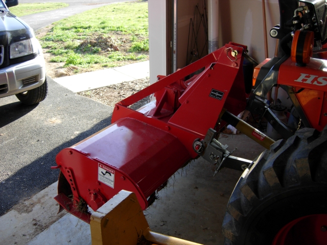

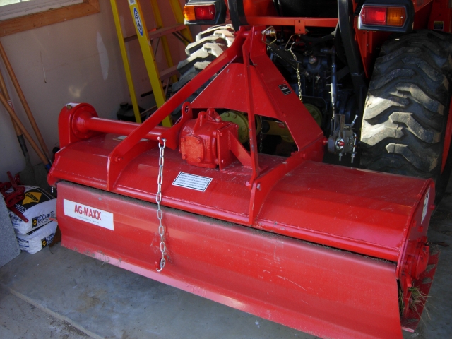

I looked at a lot of tillers before finally deciding on one. I ended up buying one from Iowa Farm Equipment. It definitely wasn't the cheapest but it's American made and very rugged. The people were very nice and the shipping was fast and easy, and not too expensive. I was looking for:
1. Rugged because of all the rock I have
2. Gear driven
3. Slip clutch again because of rock and debris
4. Not a cheap Chinese import
Check out Ag-Maxx at Iowa Farm Equipment.
CCM also seems to be a very good option.
BTW...I originally bought a cheap Chinese import and it lasted about 5' before the gear box exploded.
