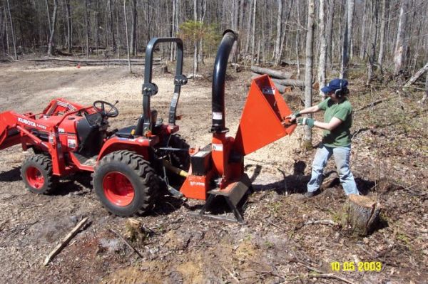

RobertM,
Sorry to take so long with your question. I have a Bearcat model 73454 that is a perfect match for your and my B7500. Does an excellent job. (see attached)
