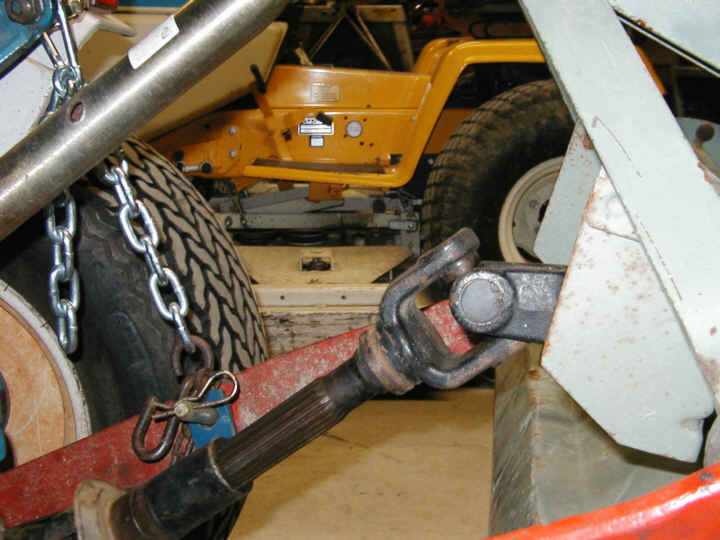

I recently purchased a Yanmar 1303 tiller to use with my 1220. Everything is about what I expected with a little hitch. The PTO shaft is only engaging about two of the six inches on the splined shaft and if I add a 4" PTO extension the shaft is at too extreme an angle when raised to rotate.
It looks like I'd be OK if I only engage the PTO when the tines are just about to contact the soil and as the tiller is lowered, I get more PTO shaft coupling.
Should I be looking at some other options?

Thanks for the suggestions, let me try to explain a little better.
The Yanmar tillers use the quick connect option on both ends of the PTO shaft, in other words, the button is depressed and the shaft is slid on the tractors PTO untill it locks, and the same quick connect is on the tiller end of the PTO. When I use the four inch PTO extension and raise the tiller, when turning the shaft by hand there isn't adequate clearance in the universal, but the splined PTO shafts are fully engaged. When I remove the 4" PTO extension, the universals have clearance (just barely) but only when the tiller is almost down on CONCRETE. It will be 8" inches lower when I'm tilling. I'll post a couple of pictures tonight, I'm sure that will illustrate the problem more clearly.
I run a 4 ft brushhog and 5 ft finish mower without any PTO problems. The distance from the tractor to implement PTO connection is probably twice as long on either of those.
I'm already running 32" lower arms, can't get it out there much further.
I'm even more concerned because of the lack of a shearpin on this setup, in reading the Yanmar posts, it was common for them to have the quick disconnects on both ends of the PTO and no shearpin. so when I hit the king of all boulders what happens? Yea, I know, something gives! /forums/images/graemlins/blush.gif
Good thing I've got a month before it's dry enough to till in NE Ohio /forums/images/graemlins/grin.gif

Here are a couple of pix that show the problem. I could resolve the poor mating of the PTO by lengthening the spline side of the shaft (Weld some bar stock inline) or I might just give it a go the way it sits. Its too bad the tiller side of the PTO is splined and won't accomodate a shearpin.
It's always somethin /forums/images/graemlins/confused.gif
If I put a slip clutch inline, the universal angle increases, thats a bad thing! If I hit the King of all boulders without a shearpin or slipclutch, thats a really bad thing. What to do?

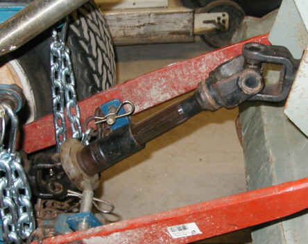

Here's another picture.
Curt

I have this problem with my Mitsu. and a JD tiller, if you shorten the top link it will help both.
