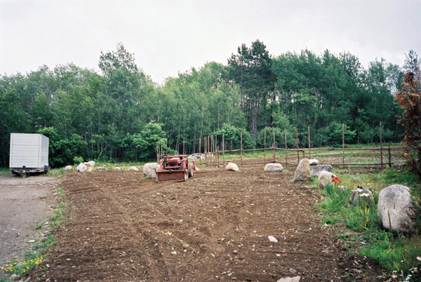

Attached pictures of glacial moraine clay drumlin with lots of rock on which a 11 PTO HP. tractor and rototiller was used for cultivation. One picture shows a crop of rye that was planted.:D
My toy tractor would not have been Able to do anything with a disk. :D

I went through the same thinking as you, and ended up with a KKII tiller. I used to use a small tiller behind a JD 112 garden tractor, and before that, my dad had a rear mount on an old Wards Chor-Trac 2 wheel walk behind tractor. If you plow and harrow, you're gonna be making multiple passes anyway, so what's the big deal about having to make multiple passes with a tiller? Make your first passes shallow- that'll tell you what you got, and if there's big rocks, the tiller'll bounce off them easier. Just be ready to raise her out of the ground if it starts to buck and bang.
