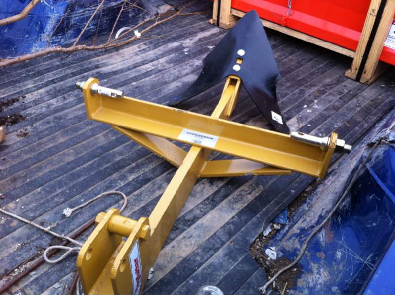

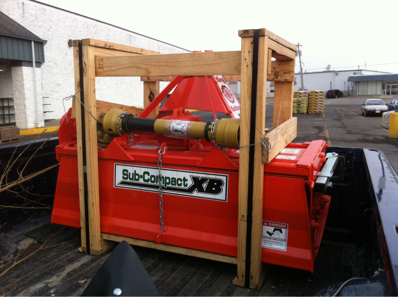

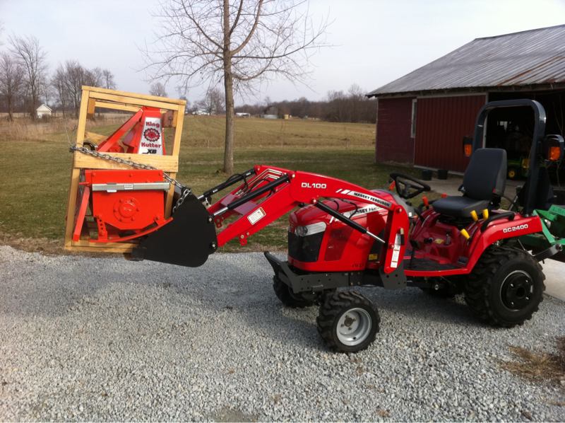

Finally got some of my new stuff in. Still waiting for my cultivator to come in. Initially I was kind of disappointed at the finish on the units. They gave the appearance that they had not been treated kindly during transport. A lot of dings and gouges on them. Also the paint job itself on the tiller showed runs. I guess we will see how it does in the dirt. Hopefully very soon.
That tiller should do a fine job for you.
As far as 'dings and scratches', you ain't seen nothin yet. Wait till ya use it.
Just buy a can of paint to touch it up with later on.
is that a tiller? it looks BIG!! for a GC :confused2:
It sure is, supposedly it's just right for the GC. Haven't had a chance to decrate it yet, but I should be able to soon. Got my cultivator on Monday, it was by far the most beat up. I was supposed to receive a new one, but instead they sent NOS from another store. Beat up and really rusty. No problem, they gave me 2 cans of non matching spray paint to make up for it. Grrrrrrr
