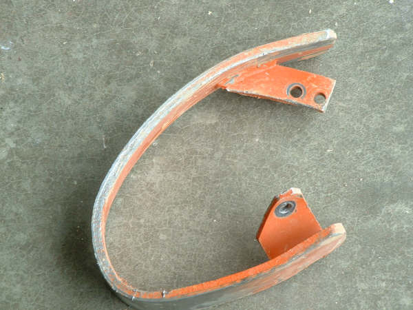

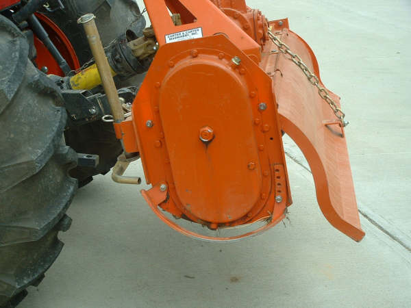

Last weekend I was using my roto-tiller to help a neighbor put in a new 2 acre lawn. Up to this point tilling the hard clay soil about 3 inches deep hadn't even been loading the engine. Everything was going great: radio on, AC on, making quick progress. Then suddenly the something killed the engine. I was scared that something really bad had happened. I got out and looked at the tiller, pto, and tractor and couldn't see anything. So I restarted the tractor and raised the tiller our of the ground to check for any big rocks or big roots. When I pulled forward I got a surpise: I saw a bent piece of steel laying in the dirt. I got back out for a closer look and realized that it was the skid plate off the tiller.
Here is a picture of what it is supposed to look like.

The slip clutch on the pto must be set to tight because it never slipped. Luckily the pto shaft, universals, and tractor were ok. I looked at the tines and they appeared un-effected. So I was able to finish the job.
The steel skid plate was bent by the tiller like it was rubber. It is about 20" long, 1/2" thick and 2.3" wide.

It appears that one bolt worked loose and the other got sheared off when the skid plate started to bend.
I wanted to make a new plate but I looked through my scrap steel and didn't have anything close to the size I needed. So I tried to un-bend the old one so I could use it until I was able to fabricate a more permanent fix.
When I straightened the old one out I drilled out the holes for bigger bolts and torqued them down really good.
Here is a picture of the temporary fix.

Gene, I was just to quick for ya and got between your post, I don't know why the old unbent shoe won't work fine its maybe not as pretty as before but it is a tiller and its bound to get uglier as time goes by from what I understand they are abusive of themselves and the tractor when used in rocky or hard clay ground. I'd try it that way for a while and see if anything rears its head but I bet your fix is as good as needed.

Thanks for the advise. I was tilling hard clay ground with lots of softball sized rocks and the tiller was taking one hell of a beating. It is amazing that nothing else worked loose. You are probabily right, I should leave the repaired shoe on and just use it. Tilling isn't about being pretty. I should have taken a picture of the tractor and tiller when I was done with the yard. It was covered with a heavy layer of dust and looked more brown than orange.
