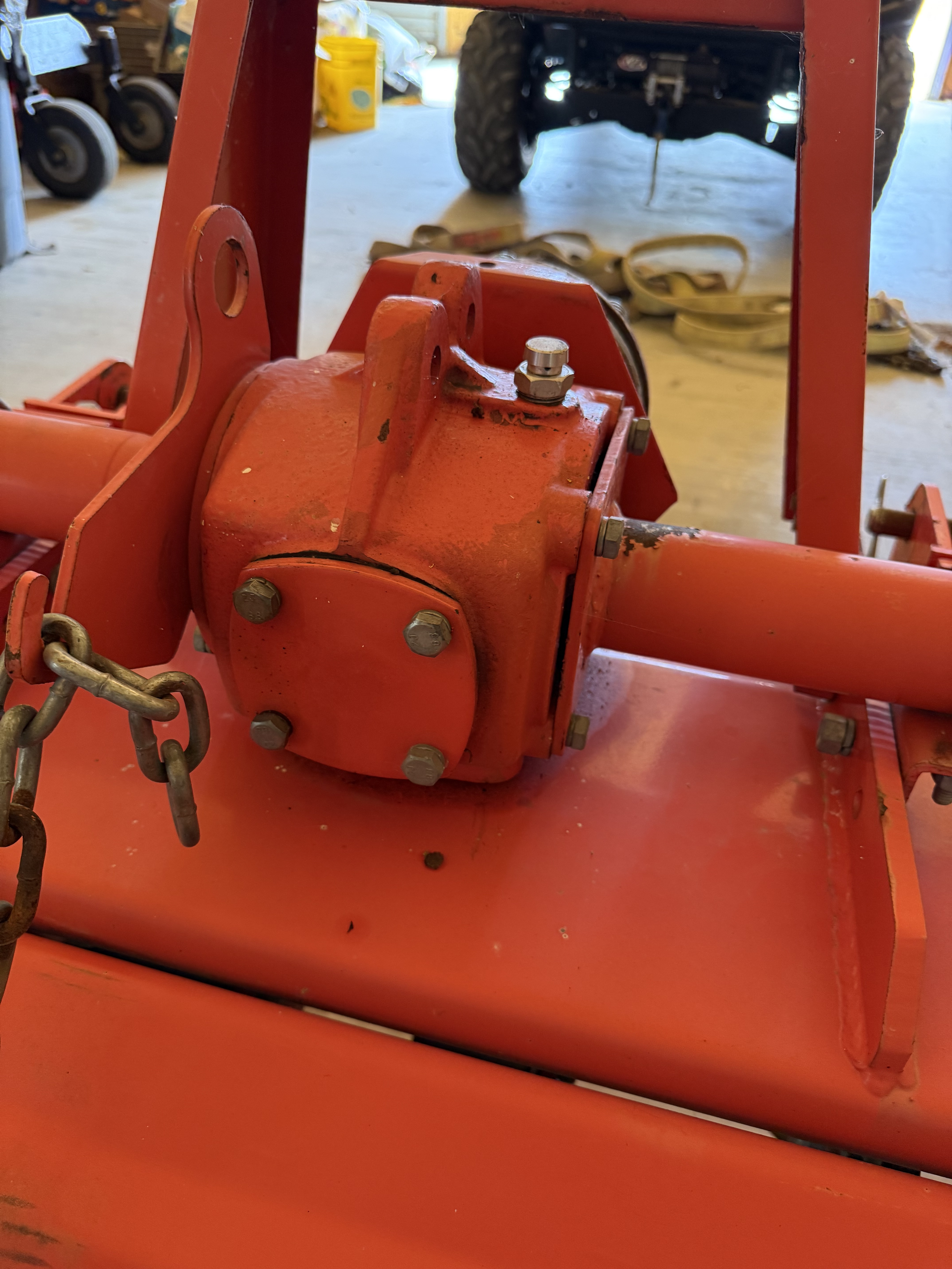

I’m pretty sure the gearbox on my tiller has an internal problem. I’ve never gone into a gearbox like this and if someone has, I would appreciate conversing with them on exactly how to proceed. Mine is a 70 inch tiller by TMG industrials thank you.

As far as faults, we're just guessing here. You should have 2 gearboxes that may have different symptoms.
Broken teeth? Gears pushed apart so they don't mesh properly? Bad bearings or bushings? Oil leaks?
   / Tiller gearbox repair
This is the gearbox. I’m fairly certain there is gear damage inside if I take the PTO input shaft and turn it the times were turned, and then the shaft will start to slip and you can hear teeth, not mashing inside. I know I can remove the rear plate, but I’m certain whenever I take that off there’s gonna be a beer bearing suspending the input shaft gear so I don’t know how to proceed from there to be able to look inside the gearbox cavity to see what’s wrong. Do I just punch out the input shaft forward remove the seal and punch it out then pull the bearing. Is it a pressed fit bearing I just have not been able to find anybody that has actually done a repair on something like this and being my first time to do it I just was hoping to have someone say this is what you Gotta do
   / Tiller gearbox repair #6
Having been through a few hundred gearboxes I can assure you they're all similar. yet all different. You have to start somewhere. Take the back cover off and see what that shows you. I suspect you will need to actually remove the gearbox to make repairs which will probably involve the tube and shaft to the outer side gearbox as well unless you can remove enough of the left side framework to allow the box to separate to the left. I can't tell enough from the one photo to make that call.
   / Tiller gearbox repair #7
Also save your oil. That may help you discern what is going on. Chunks of metal? A little metallic reflections? Does a magnet pick up anything interesting.
