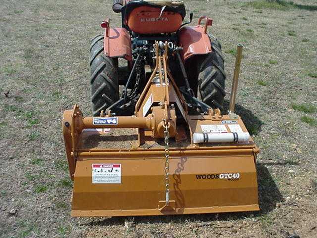

/ TILLER FOR BX #2

/ TILLER FOR BX #16
The Woods GTC40 has a double chain drive as well as a slip clutch. I did have to cut the shaft originally to fit my B6100E, then I had to cut another inch off to fit the BX23.
BTW - the mounting points are adjustable to fit different lift arms as well as to offset up to 6". See Pic:
http://www.geocities.com/wjbaker1/Woods5.jpg
I stopped by my local Woods dealer to inquire about a post hole digger. During the conversation he mentioned that he sells the GTC40 for $995 this year (versus $985 last year). So the price is still awesome.

/ TILLER FOR BX #19
Yes the price of $995 on the Woods GTC40 includes a slip clutch. It can be offset by adjusting the hitch pin bracket. This is done by loosening the 2 nuts and sliding the bracket:
Touch base with your local Woods dealer 7 get a price. Then shop around with a couple other Woods dealers. They do have different discounts based on how much Woods merchandise they purchase.
Bill.
