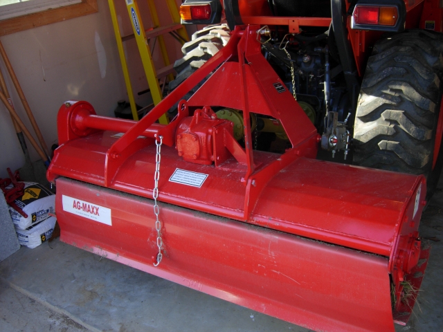

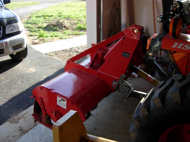

   / Tiler - Rotomec, TSC, or ? #5
I recently purchased a Ag-maxx from Iowa Farm Equipment. It is very solid and seems to work great. The 60" fits fine behind the wheels on my L3400.
