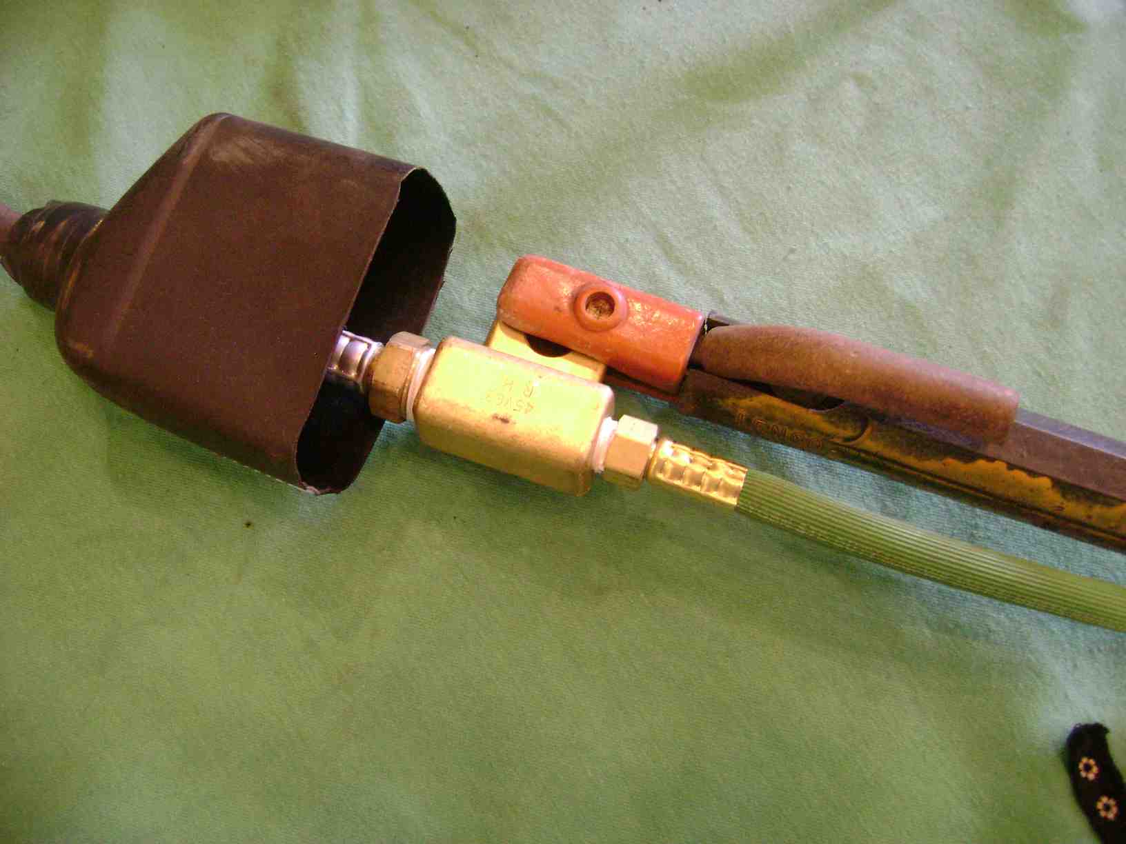

For any of you members who would like to know how easy, and cheap it is to get set up to Tig weld using your stick welder. Here is a link to a sticky over on WeldingWeb. TozzieWelding does a really good job of explaining how easy it is. For The Can I TIG With My Welder People.
All you need is a air cooled scratch start Tig torch, with cup, collet, collet body, and tungsten. Flow meter, with short section of hose, bottle of Argon. Power lug.
Ebay has some really good deal on this equipment.
TIG Torch SR 17V 25R 150Amp Air Cooled | eBay
HTP Argon CO2 MIG TIG Flow Meter Regulator Welding Weld | eBay
X-ray quality welds are made every day with these Tig rigs!

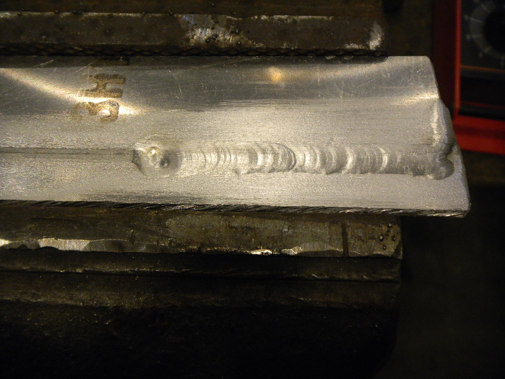

You can even weld aluminum with a Tig rig. But you can only make short welds, when the metal heats up no way to back off the amps. But it does work in a pinch. ;)
Is your pic of DC- with Helium, or with AC and argon?
I started out tig welding about 3-4 years ago with just the stinger clamped on the tig torch like Shield Arc's post #1.
Then I bought a Miller High Freq spark box to do aluminum on AC, but no foot control and no on/off control.
Then I bought the big Airco tig with foot control - on aluminum (and steel less than 1/8") I like the foot control too much to go back to the spark box. :)
Now I have a few DC tigs as well as the Airco...it's a sickness :laughing::thumbsup:
/ Tig welding on the cheap.
DC- with helium.
Dave wasn't there a thread on WeldingWeb where someone was saying you can weld aluminum with DC- with argon. But it has a very small window where the arc will start? Seems as I remember you were involved in that discussion. :confused3:
/ Tig welding on the cheap. #6
DC- with helium.
Yep, I've done it, but on DC+ (not DC-) but the tungsten heats up super fast, so an 1/8" tungsten will only let me weld about 1/16" thick aluminum without blowing up ;)
Trying it on DC- was an exercise in frustration btw - for me anyway.

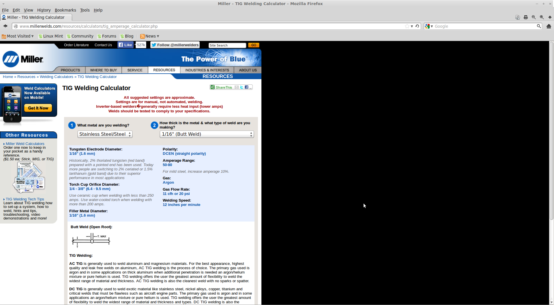

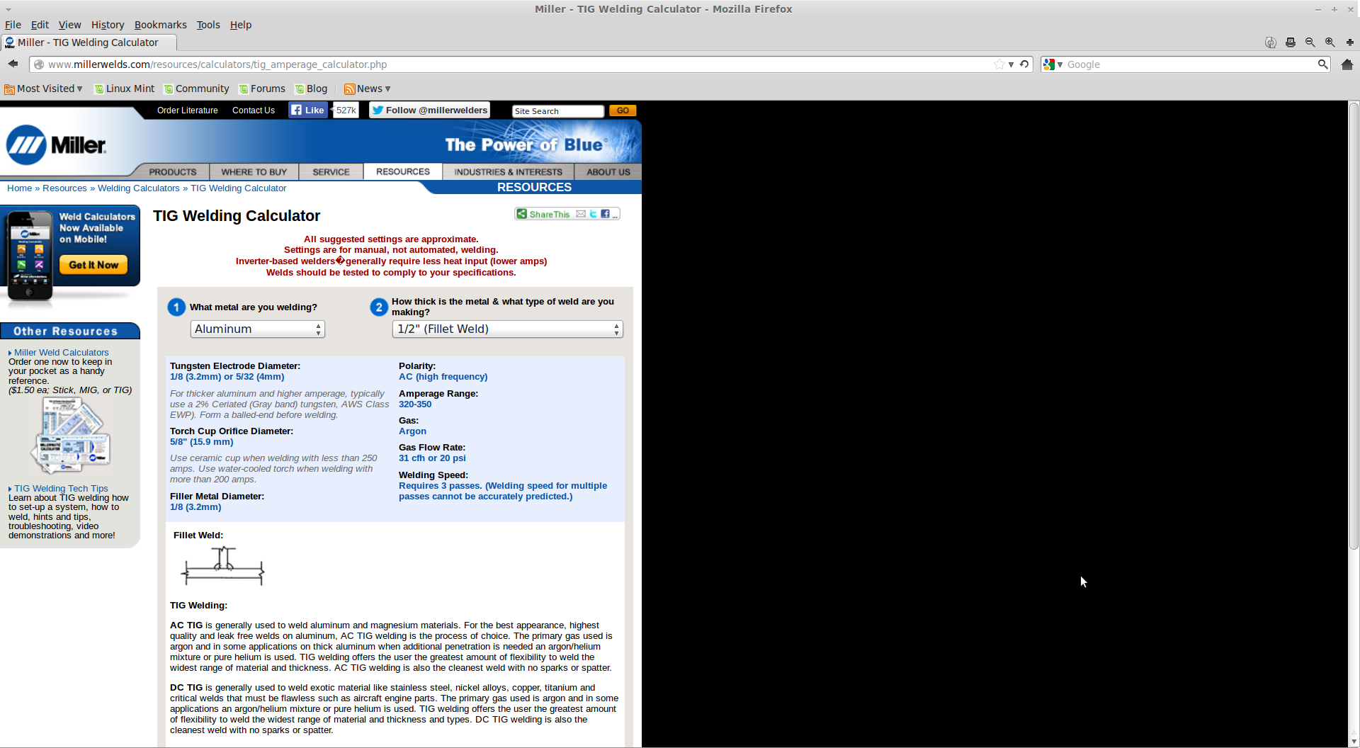

Tig works fantastic for thin material, I don't really know if there is a thickness limit or not. Seems like at one time somewhere I had to Tig weld 3/4-inch thick aluminum. I guess it gets down to if your hand can take the heat, and the machine has enough horse power.:laughing:
I quick look at Miller's calculator, it says you can Tig weld aluminum up to 1/2-inch thick.

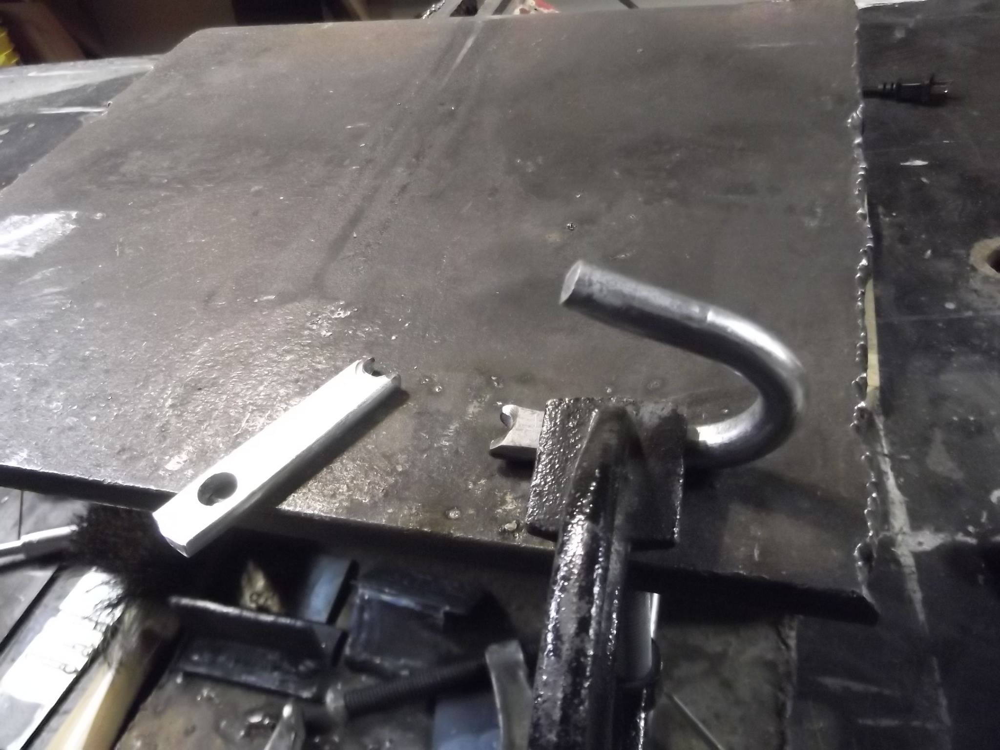

Here are a couple of things I repaired with TIG, that I took photos of. I have repaired many other household things. These are all small things, because when it gets big I can stick it!
Here is some chain I made for a project out of drop ceiling hanger wire.
IMG_20131018_115507_563.jpgIMG_20131018_114918_529.jpgIMG_20131018_105129_520.jpgIMG_20131018_104229_173.jpg

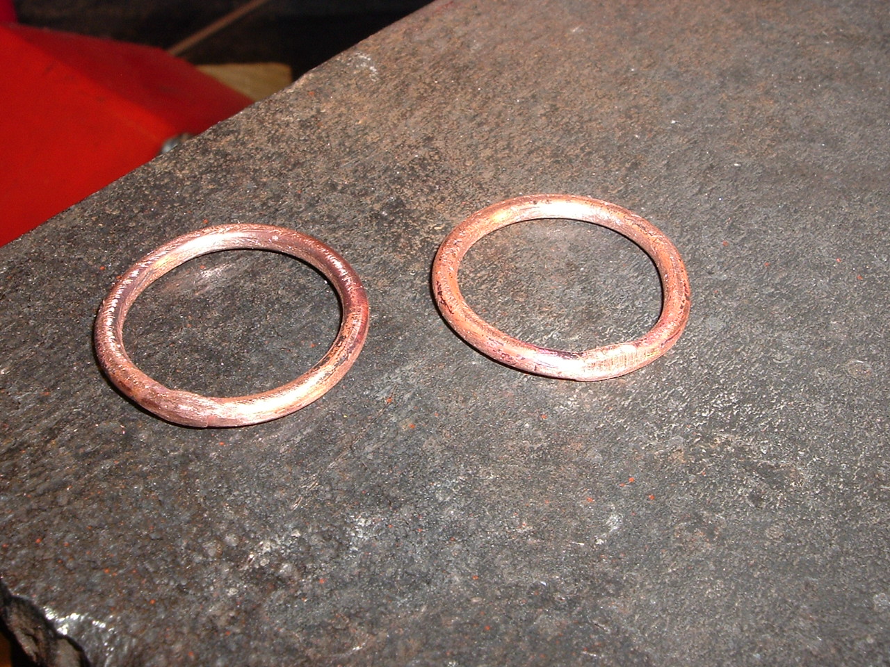

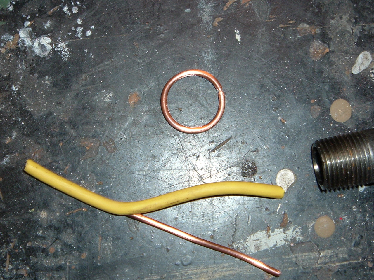

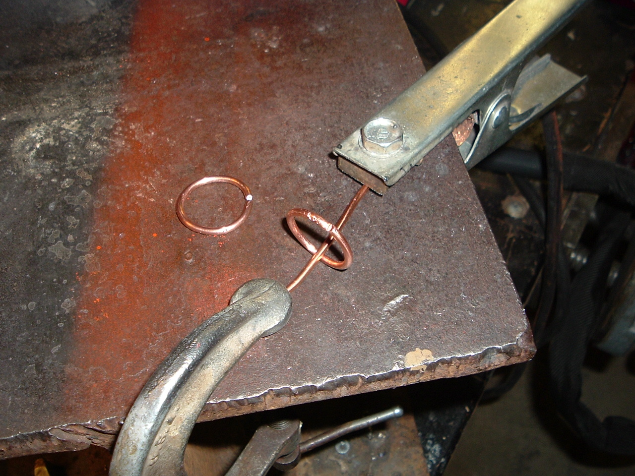

here are some copper crush washers I made from #10 copper wire
Here is a broken hook I repaired with TIG
While this grab hook probably could have been TIG ed on, why do it when you can be more sure to get it stuck on with stick and some 7018?
IMG_20121117_170314_242.jpgIMG_20121117_165303_772.jpgIMG_20121117_162438_547.jpgIMG_20121117_162424_854.jpg
