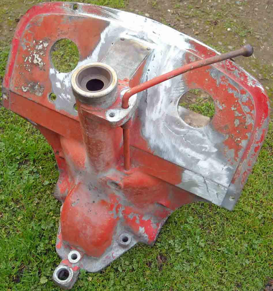

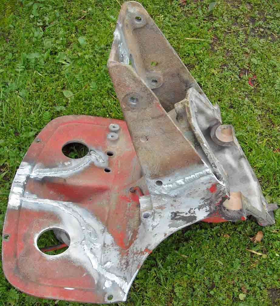

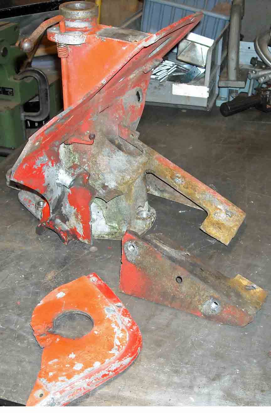

I got my first TIG welding lesson a couple of weeks ago. A friend
was nice enough to give me some hands-on exposure and guidance
with his welder.
Anyway, here is a project he just finished. It is the instrument panel
and brake/clutch pedal shaft support. I am surprised to find that is
is made of cast aluminum and has broken in several places. There
are numerous fatigue cracks spreading outward from the guage holes.
68 years of vibration, no doubt.
According to the weldor, the casting was fairly pourous and rich in zinc.
After several hours, this is the result.

I have foubd it benificial to heat cast aluminum parts to about 300F prior to welding in order to keep thermal cracks from forming. They usually form right down the edge of your weld bead.
