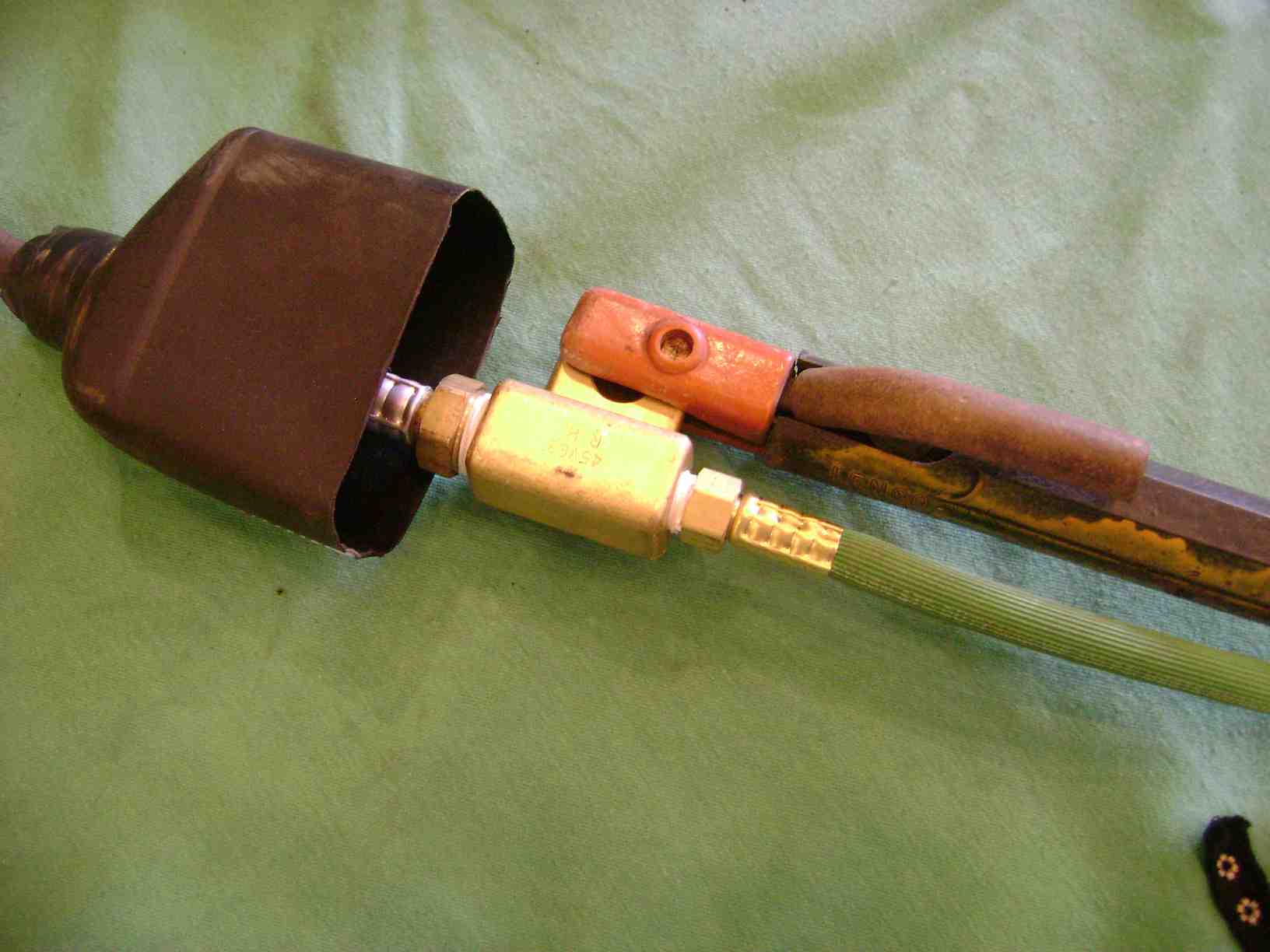

With shipping so high it might be best to buy the Tweco fittings locally.
I tried the auto lenses that go inside a regular old hood, they're OK, but what I don't like about them is, if you have to move your heard around something while your welding they shut off! Don't know if the more expensive auto hoods do that or not, maybe they have more than one sensor, don't know. But I'll just stick to the old school hood with a Lincoln Super Visibility lens.
https://weldingsupply.securesites.com/cgi-bin/einstein.pl?PNUM::1:UNDEF:X:94251226

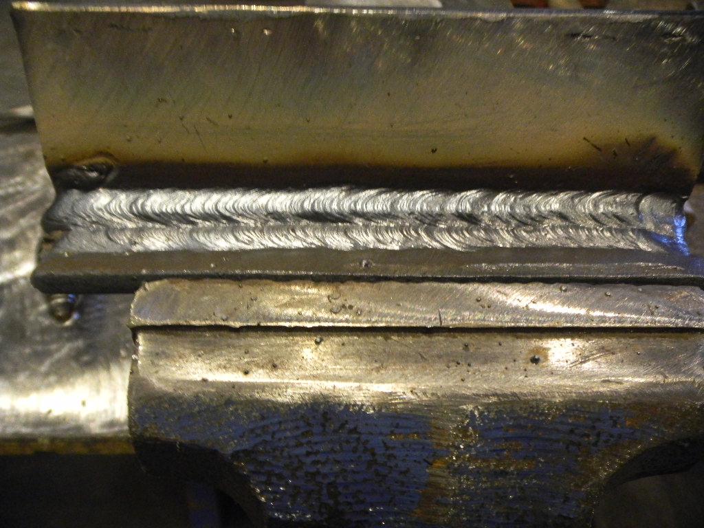

All this talk about AC, so I tried some 7018 on AC this morning. It doesn't seem to wet out like on DC, and I just can't get by that sound. :laughing:
/ Tig break test. #48
I think 7018 is a dc rod, 6011 works very well with ac. I assume the sound you are talking about is the 60hz buzz, right?
/ Tig break test.
#49
I have a Lincoln Weldirectory right here in my hand. It says Jetweld LH70, Jetweld LH 73, Jetweld LH 75 MR, Jet-LH 78 MR, all 7018, all can be run on AC, or DC+.
I'm sure it is the 60 hz too. That's one thing I really like about my Dynasty, you can adjust from 20hz to 250hz.
