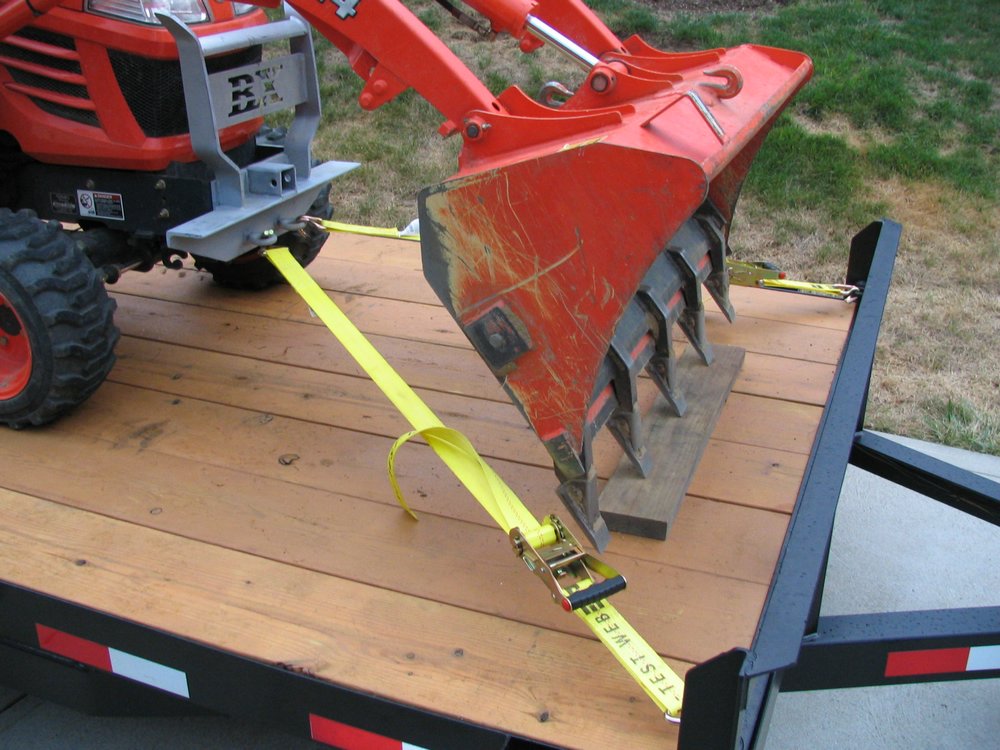

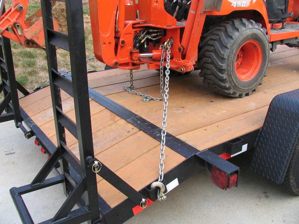

I 2nd the notion that a few "additional" tie down spots on the tractor make things much easier. As mentioned in another post, I use chains in the back and straps in the front. I personally get a better "feel" from ratchet straps that I do with the screw type binders.
I used to haul 6000 lb trenchers all the time and not matter how tight we made the screw binders, 5 miles down the road the chains always loosened up a bit (not a ton but some). But that was probably because we only used two chains (one looped around the front and one looped through slots in the back). Using four separate tie downs did help.
