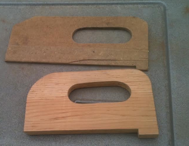

As you realize you are very fortunate to still have the most of your full thumb so please build yourself at least one of these push shoes and use normal operating procedures.
To make construction simple cut a strip that will be designated as shoe heal material. If replacement is ever needed saw the old heal off. Heel is glued on with Elmer's rather than cutting it out.
If you know of anyone that truly can't afford a push shoe I'll make them one free of charge.

The shoe is the best design, much, much better than a push stick IMO. I didn't bother with the finger cut out, Didn't like my fingers being "trapped" in the hole, but either way it works great.

Are you saying that the heel is glued on when you first make it or only when the heel needs replacing?
If glued on from the start, why?

easier to make, but not critical. You can cut it in at first and then glue on replacements. I just make a new one. They are made from scrap.

If you'll make two, one of each method, I believe you'll quickly see why the heel is always glued on rather than cutting out.
But of course if you need one immediately by all means cut it out rather than waiting an hour or two for glue to dry.

The thin shoe pictured is masonite and yes, always cut out. I keep a couple of differing thickness and heal depths at both of my saws.
