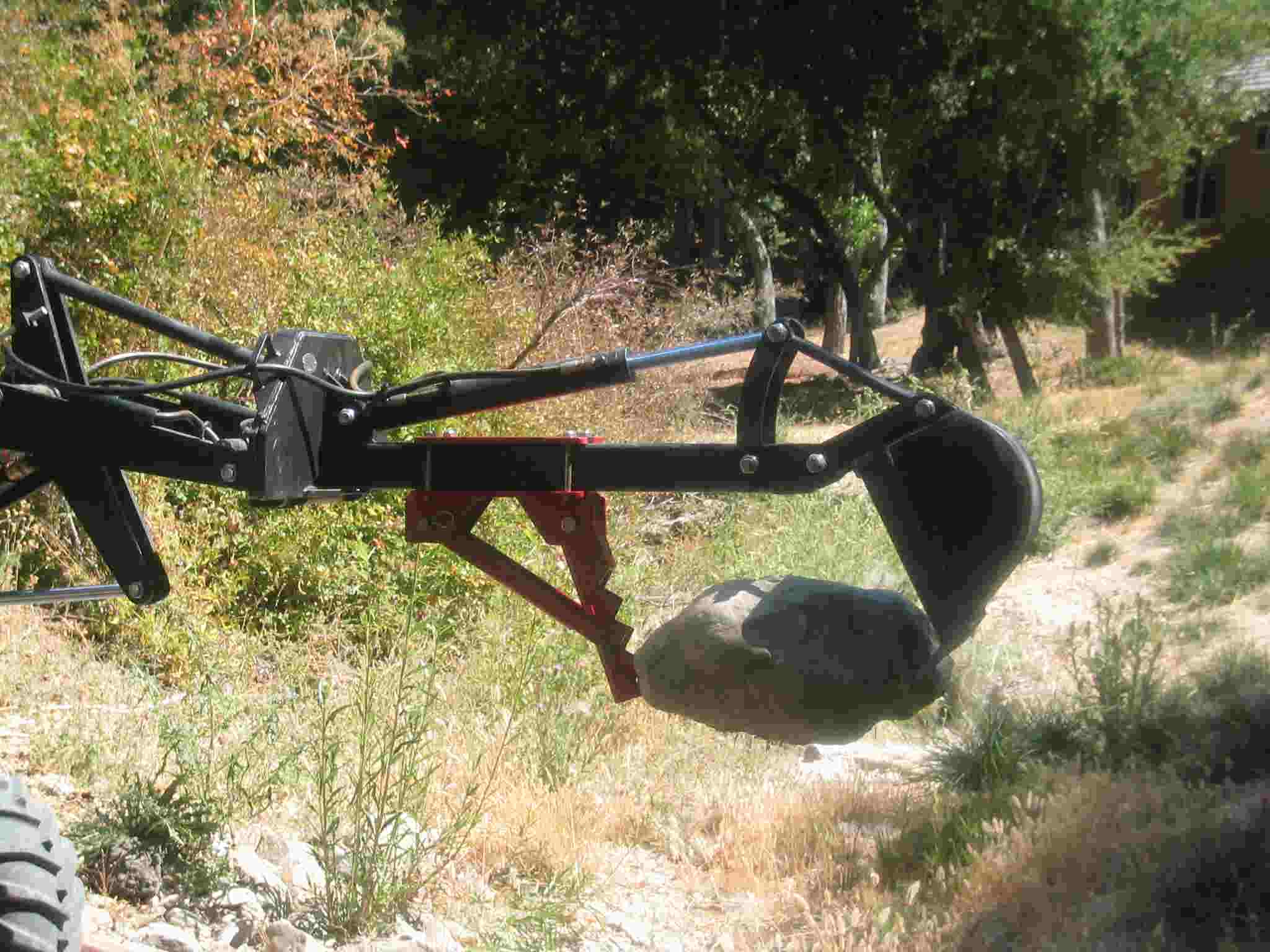

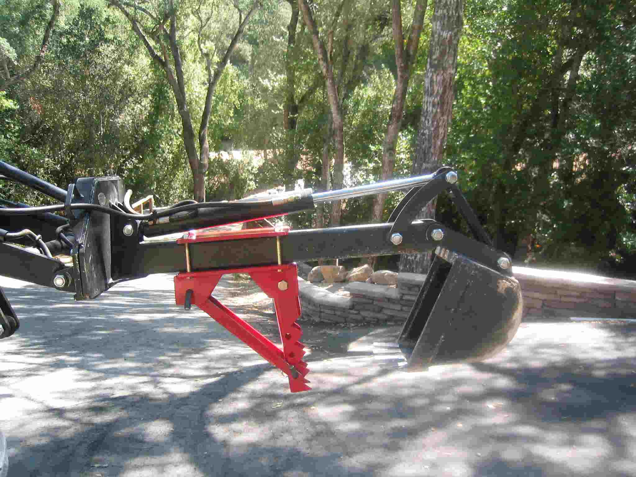

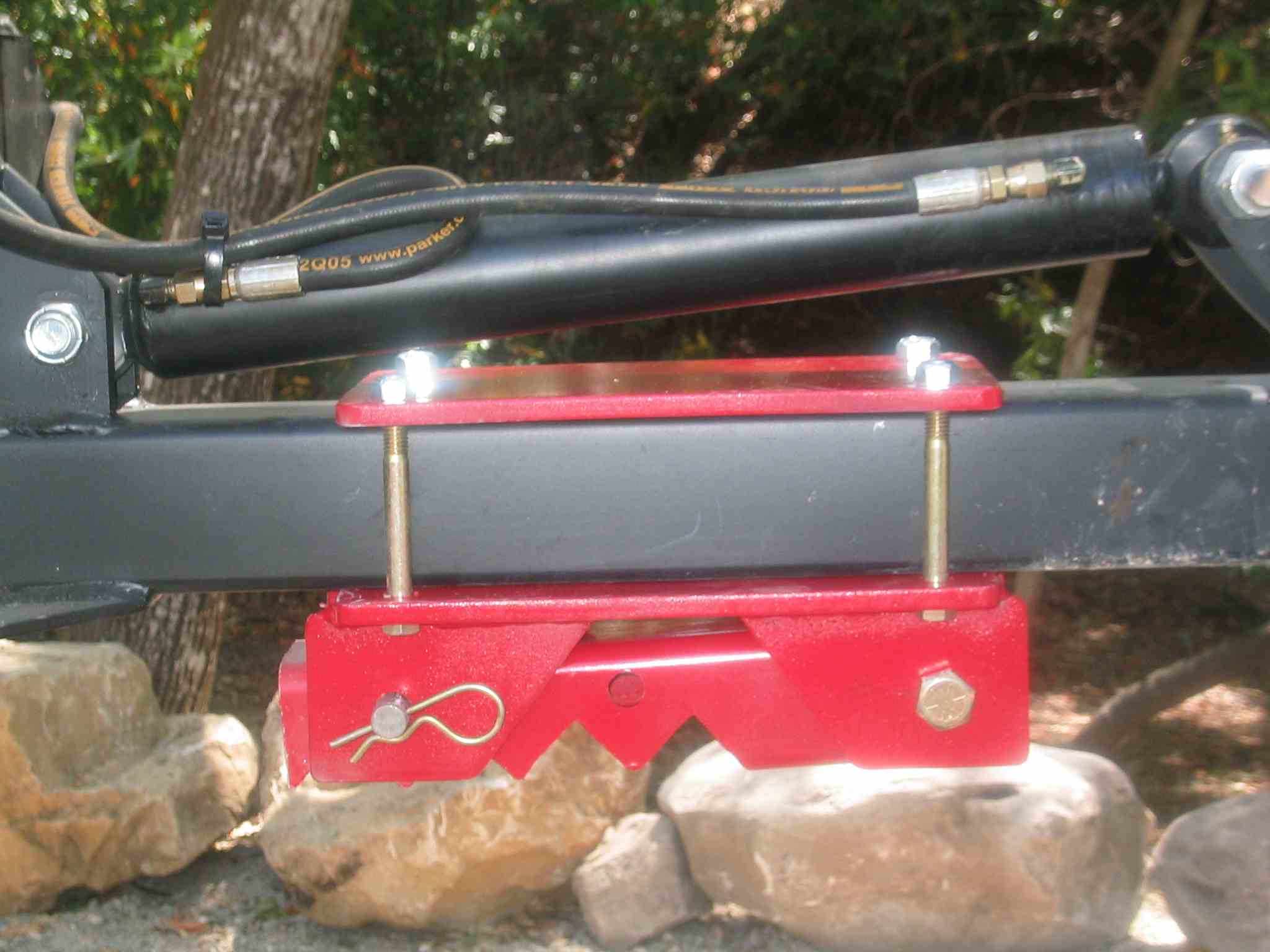

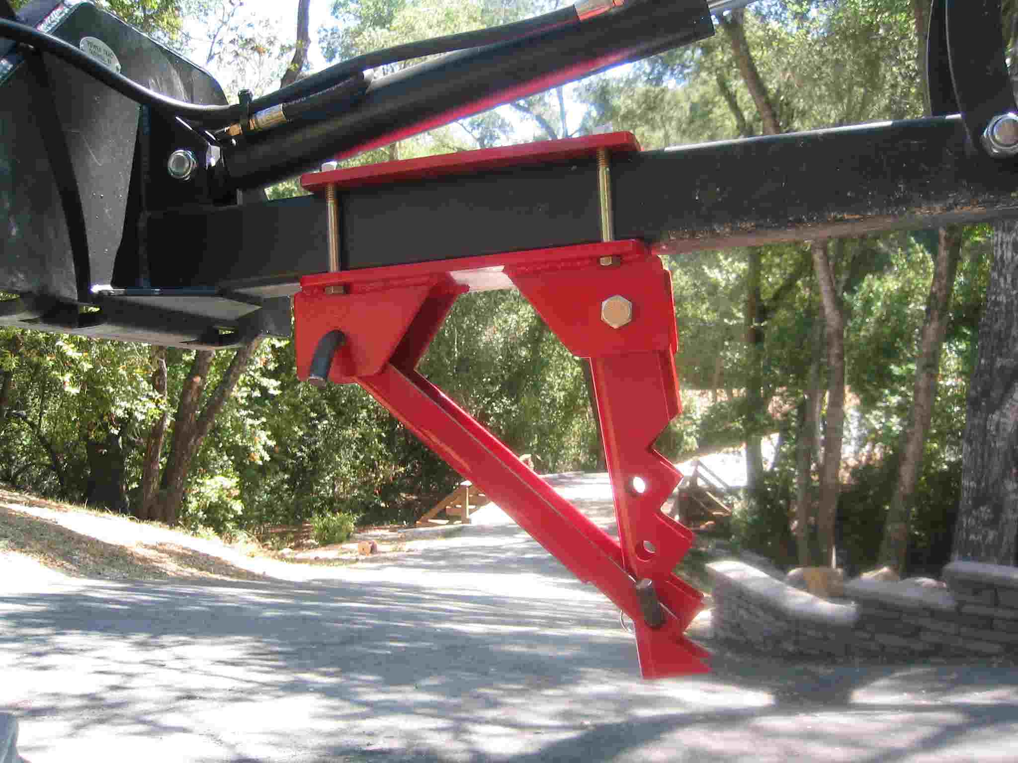

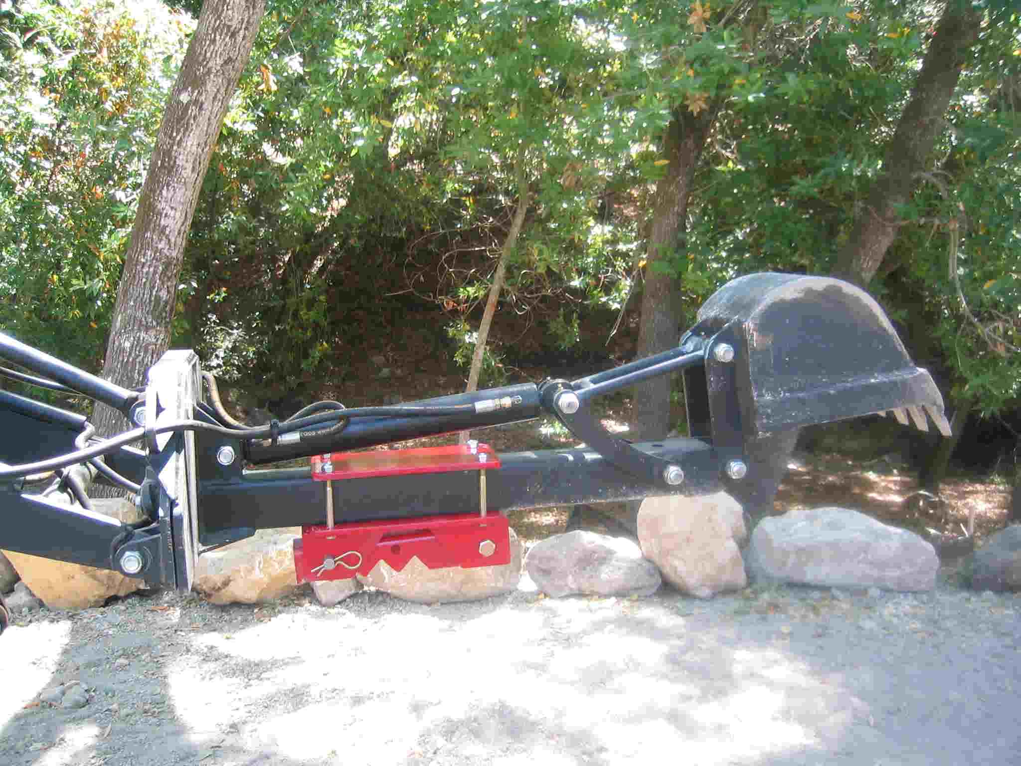

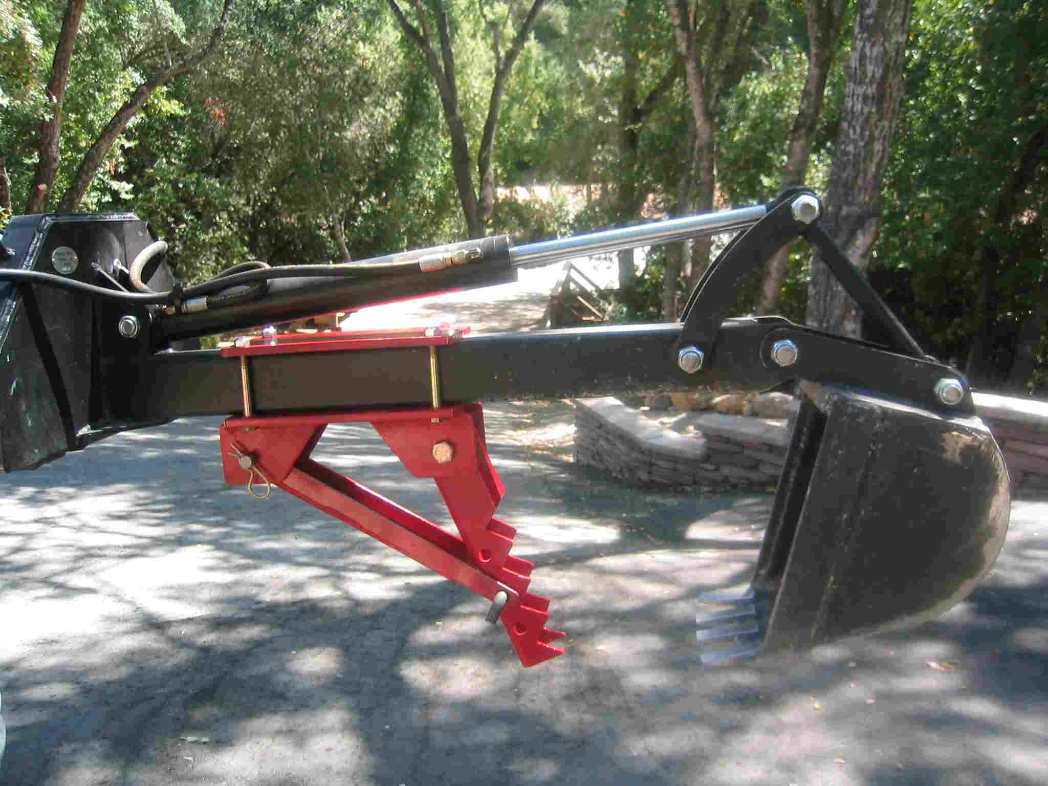

Attached are pictures of a thumb that I had made for my hoe. I did not want one welded to the hoe so I designed one that bolts on and folds back out of the way without removing. So far tests have been successful but I may want to later make a longer thumb but that should be easy since it is simply a two inch tube with notches cut. It is pinned on so is easy to remove.

great implementation. I like the way it folds up when you are not using it.
