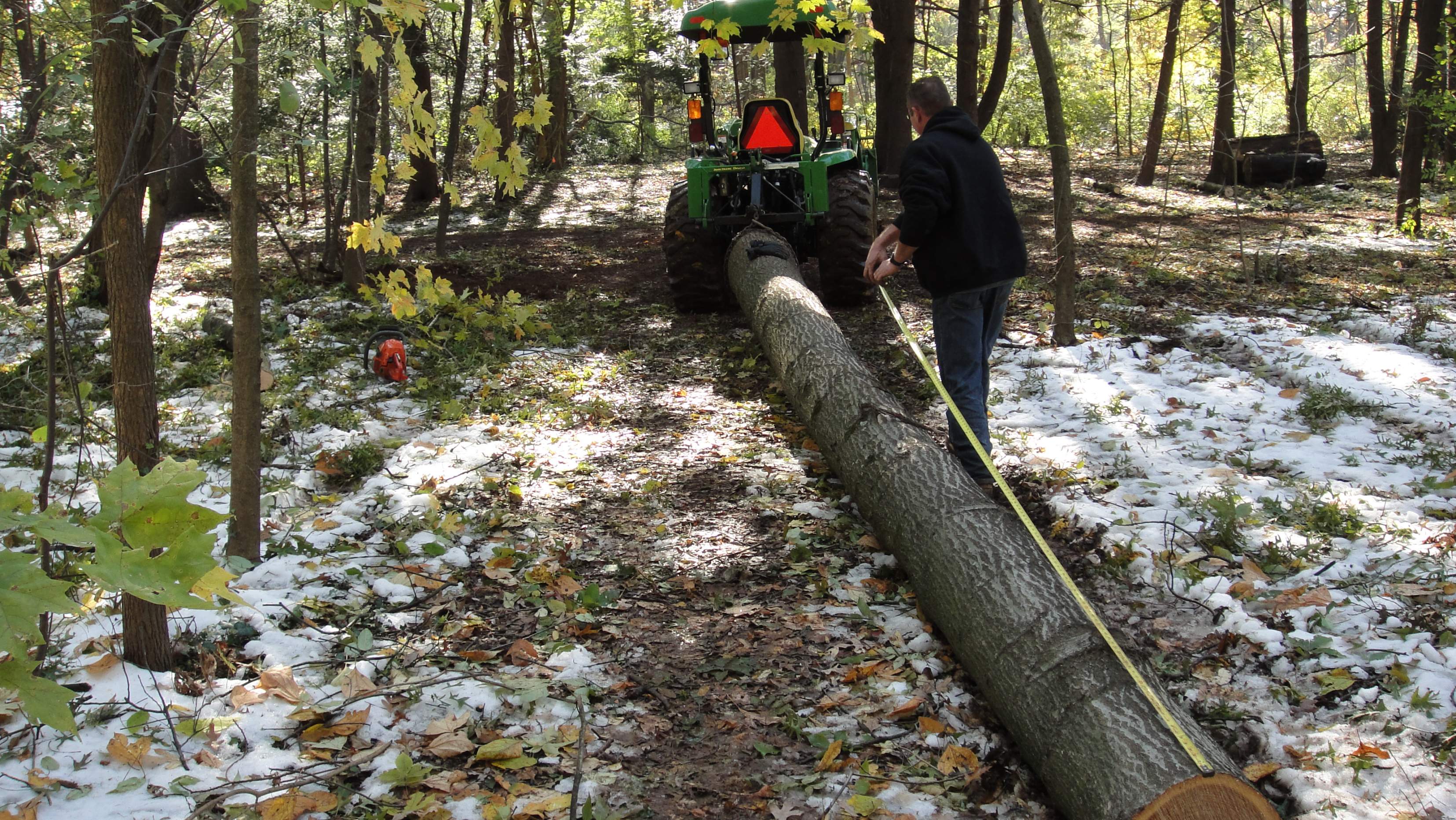

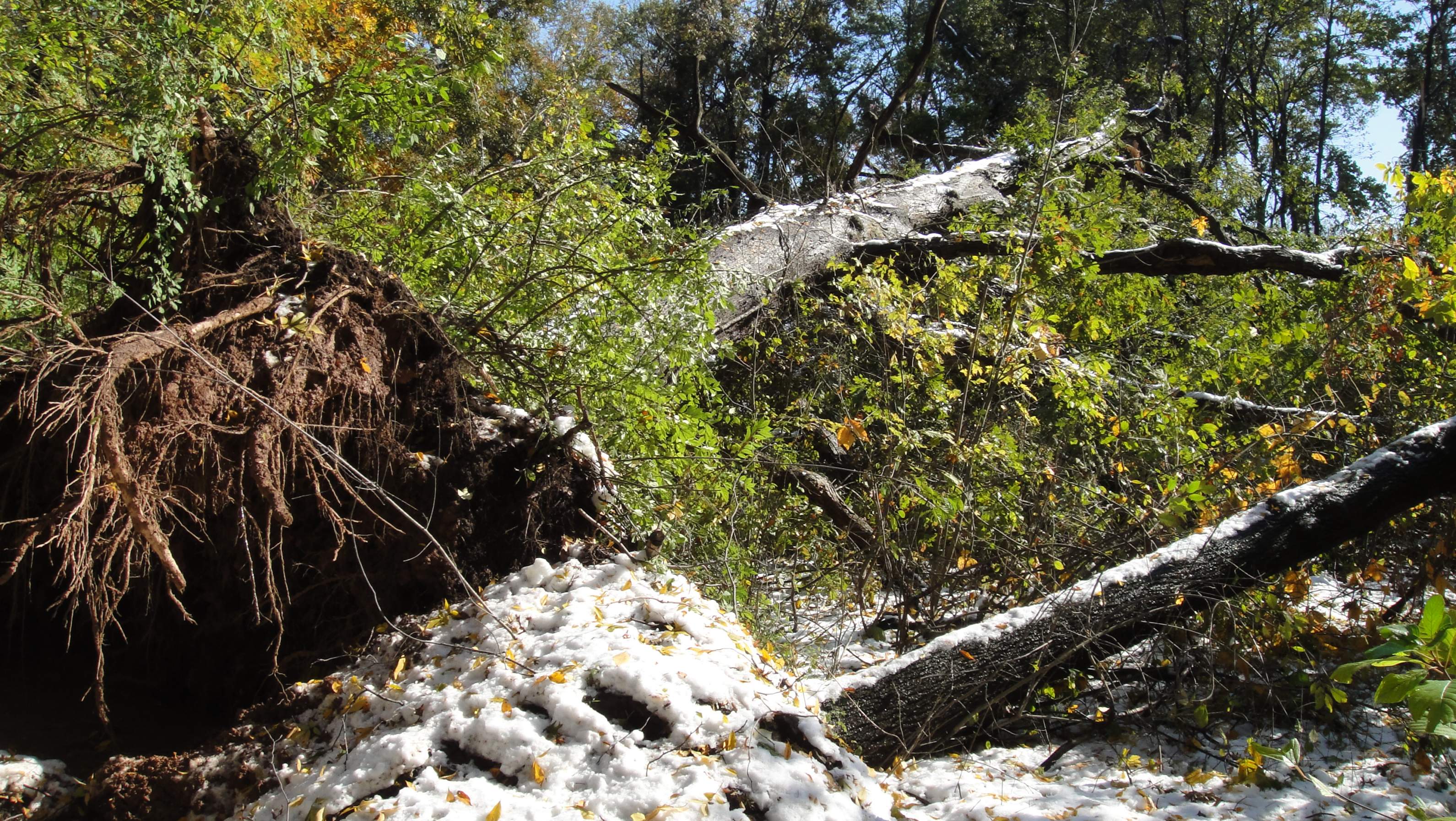

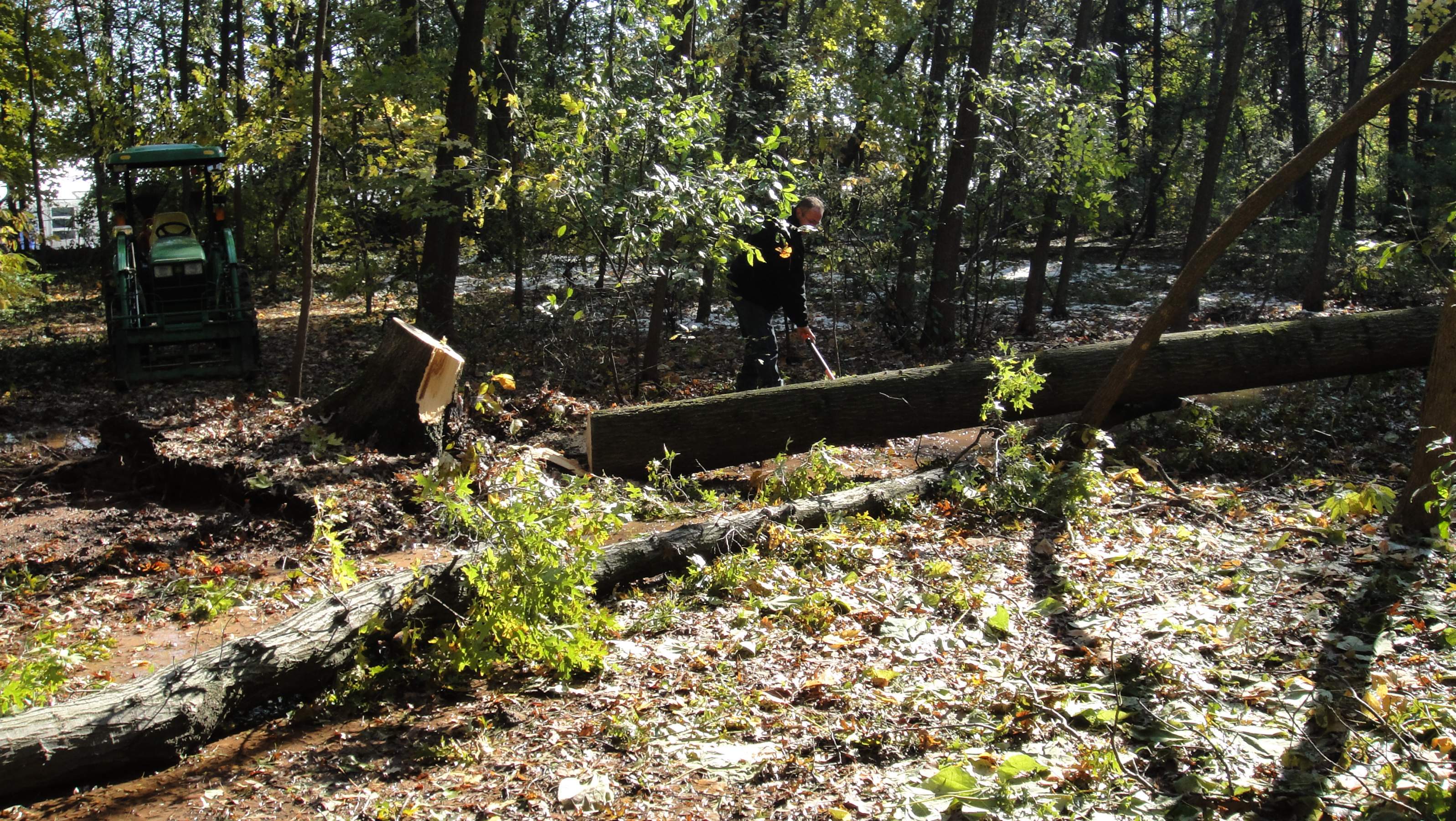

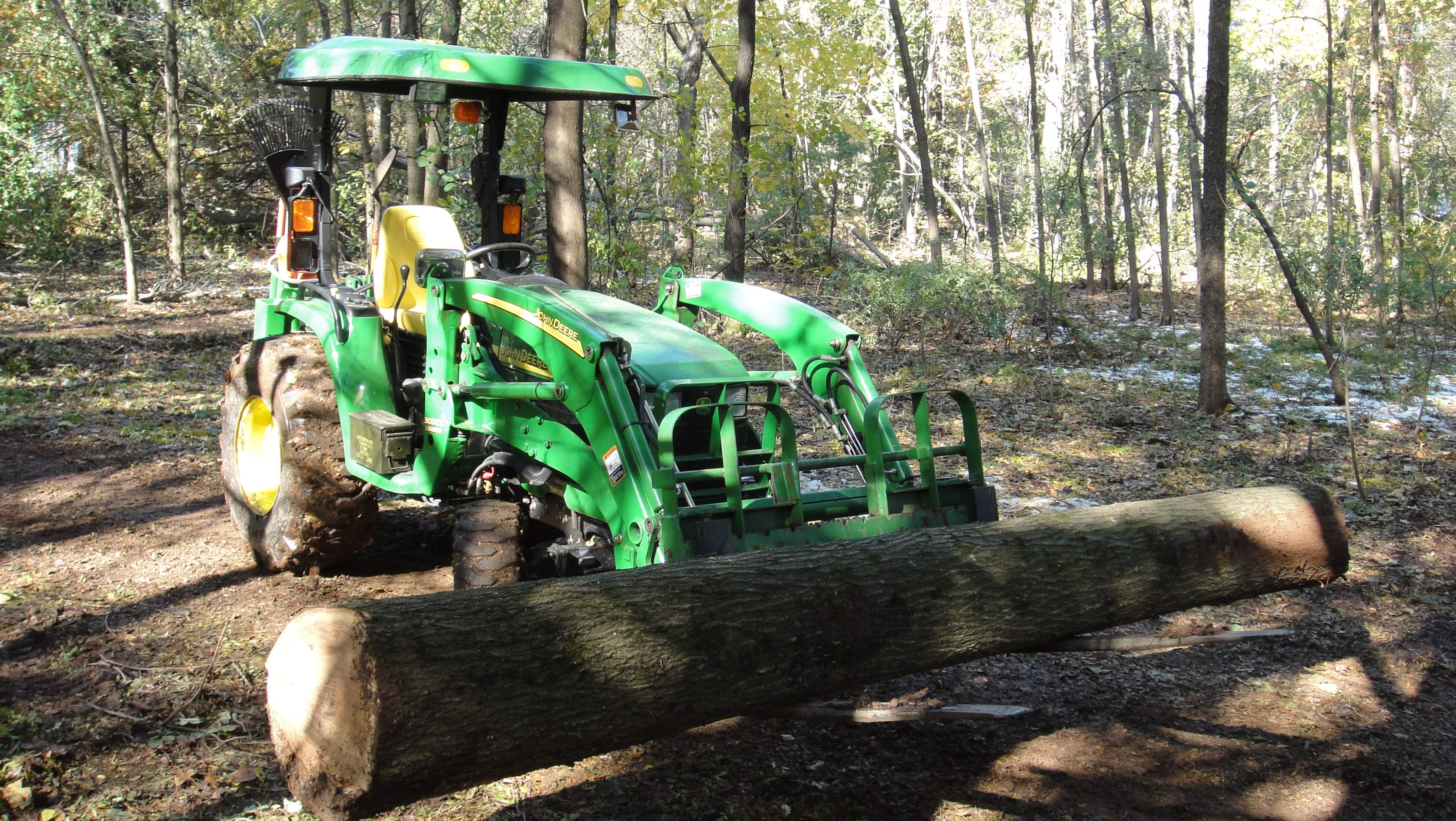

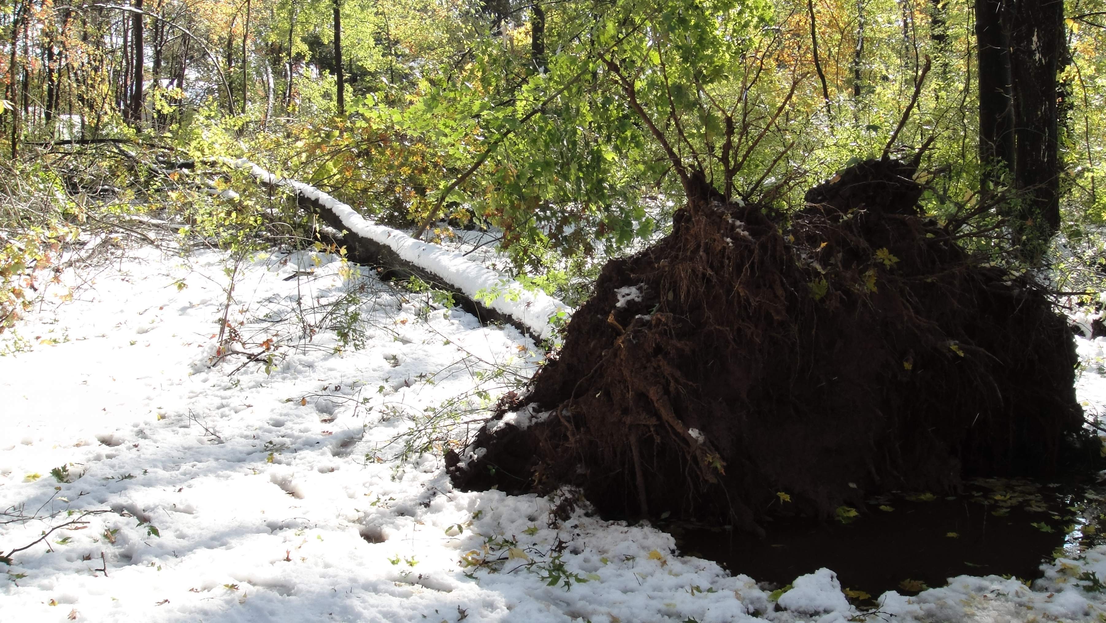

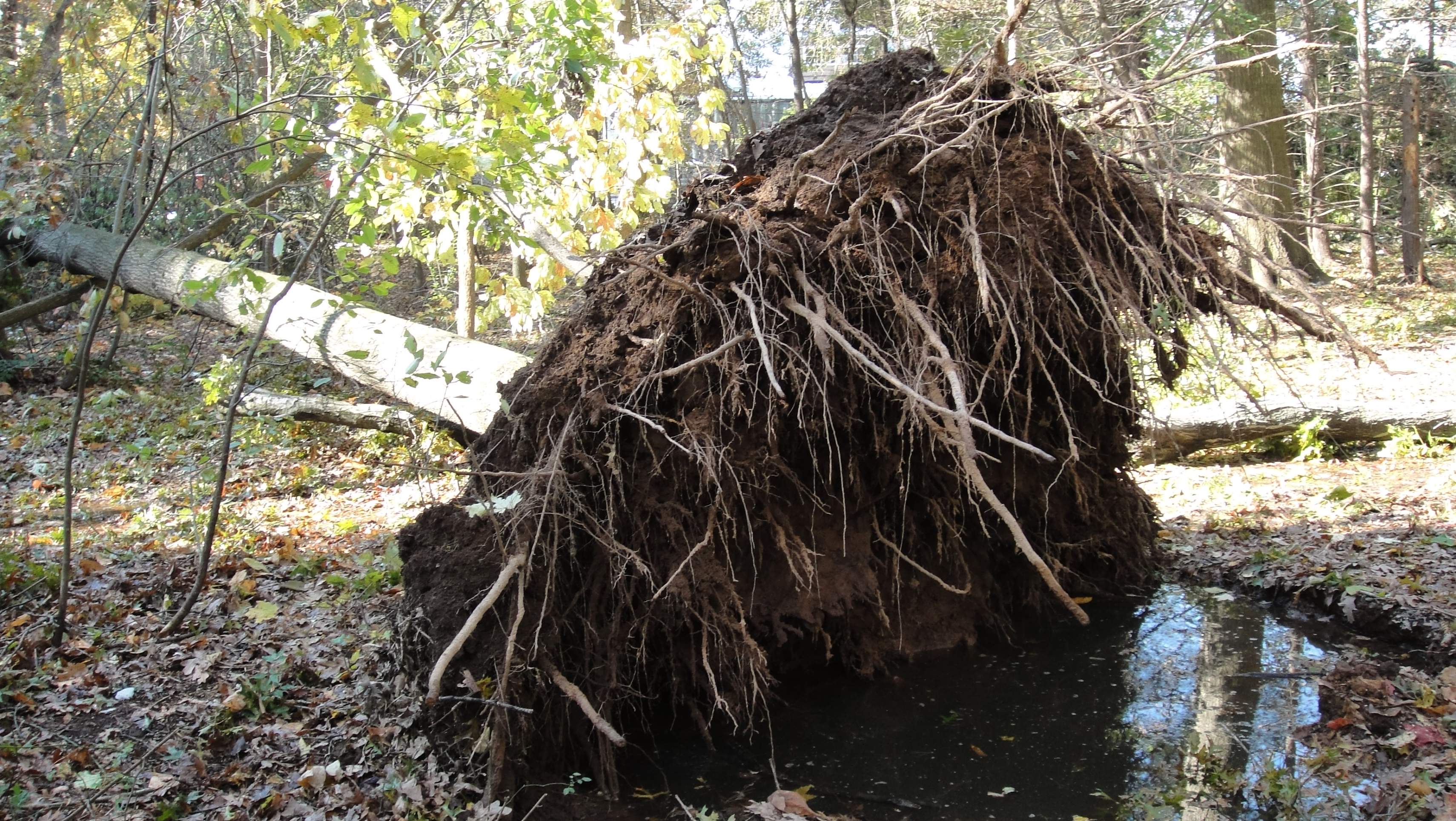

Some of the trees in my yard,
The first pic is a 36"+ white oak with a 20" hickory tied together at the roots, This was on my neighbors property, but fell in a drainage channel I maintain so I cut out the hickory. Wasn't sure what was gonna happen but nothing moved on this one. That long red oak about 20+" you can see how the whole root/stump stood back up in the hole. Got a nice log out of it but cut it in half anyway, just for firewood. maybe I should of saved it. not sure what if anything it would be worth. 20feet/20inch red oak
