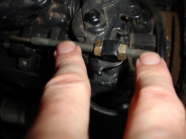

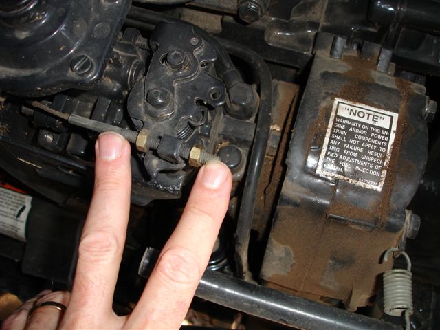

The two nuts on my throttle cable shook loose.
How do I adjust them? What I did was move the throttle all the way to full throttle (engine off, peddle "floored") then back it off just a hair so that the throttle would not be "maxed" out, then tightened the two nuts.
Is this the right approach? Is there a better way?

Yikes... thats the connection at the injector pump.. right? I'd get a 2nd opinion on that from a diesel mechanic ( not me ). Got to be carefull with the injector pump. I'm surprised there was no locking nut.. or pal nuts...

Okay, now you have scared the you know what out of me. What can go wrong? What damage have I done?

I don't think you've done any damage. I just think you should get some advice on how to re-set the connection ( if it even needs any special attention ). Remember.. on a gas car/tractor.. your throttle lever controls a governor which controlls a butterfly, and thus fuel/air. On a diesel, your hand/foot throttle is controlling fuel delivery level.. ( I'm not explaining this well.. but I'm not a mechanic either. hopefully a real one will be along in a few minutes.

Whew! I do not want to break it. What I did was use both the hand throttle and foot throttle to see what the maximum travel was for the cable. Then I set the cable so that the maximum throttle was just slightly less than what the maximum is. That way, I never hit the "maximum stop". The way I have it setup, it the governor has another 1/16 of an inch to go. I never use the last 1/16th inch. All of this is just an educated guess. I have never done this before. But I did stay at a Holiday Inn Express!
Thanks for your comments. Hope a diesel expert shows up soon :D .

You need a maintenance manual or CD to know for sure. However, I would have been inclined to set the throttle linkage at the idle end of the rpm scale. Set the position for the right idle speed (probably about 1,000 rpm) and then lock those nuts on each side. I'd think that there's a governor to ensure it doesn't overspeed.
