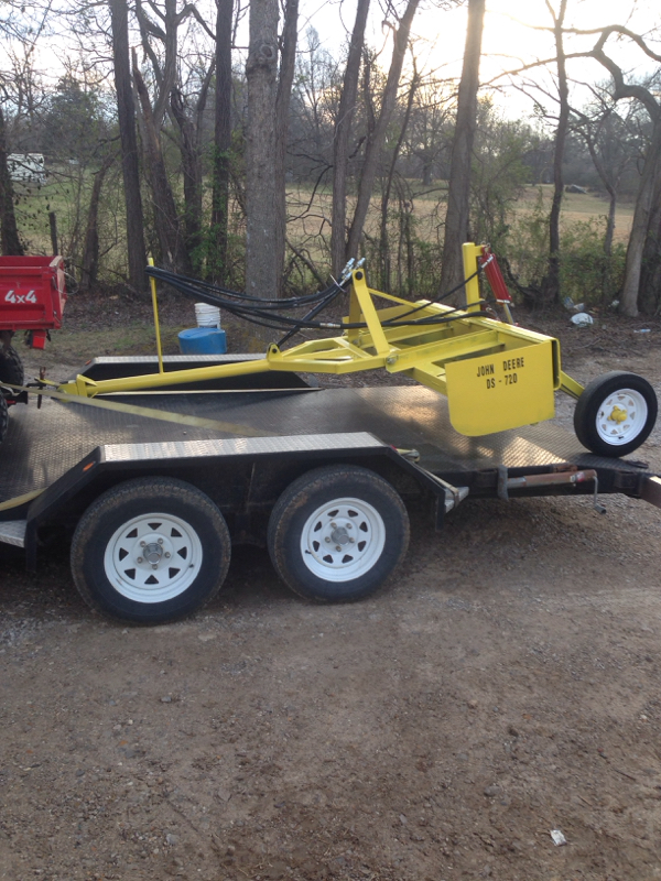

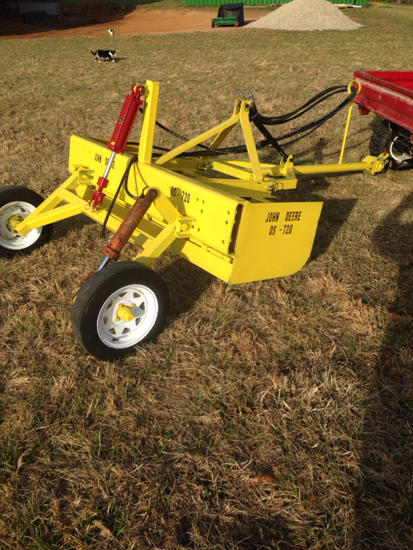

Well its home and hope to try it out tomorrow IF the weather holds out. Still have to paint the tilt cylinder i noticed it leaking the other day so figured i best replace the seals now and it would be good for a long time. Also found some black vinyl stickers laying around and decided to break up the solid yellow paint a bit.

Well it sure is Purdy....... Let us know how it works. Suppose to start raining here this evening sometime. Don't know about over there.

Any more on how things are working out? I wish this site had a like button, but I understand why it dont too. If I missed it and you explained it, I apologize, but did you make it so when the wheel hyd cylinder is extended all the way, that the blade is perfectly level? Thanks.

I haven't been able to use the box blade yet, i had the tractor in the shop and then it rained and is to wet. :( As for the wheel tilt, I built mine so that when the cylinder is in mid stroke it's level, it allows me to tilt it in both directions.

I thought that's what you did cause I remembered talking about it. :thumbsup:

I finally took some time to shoot a few short videos of the box blade, not much but all I have right now. One is dragging a small garden to knock down some high spots and fill in some lows, I set the blade to just touch when I started and never touched it again till I was finished. The other is cutting dirt in front of my storage area and dragging the dirt in to bring the floor up to grade prior to spreading gravel.
