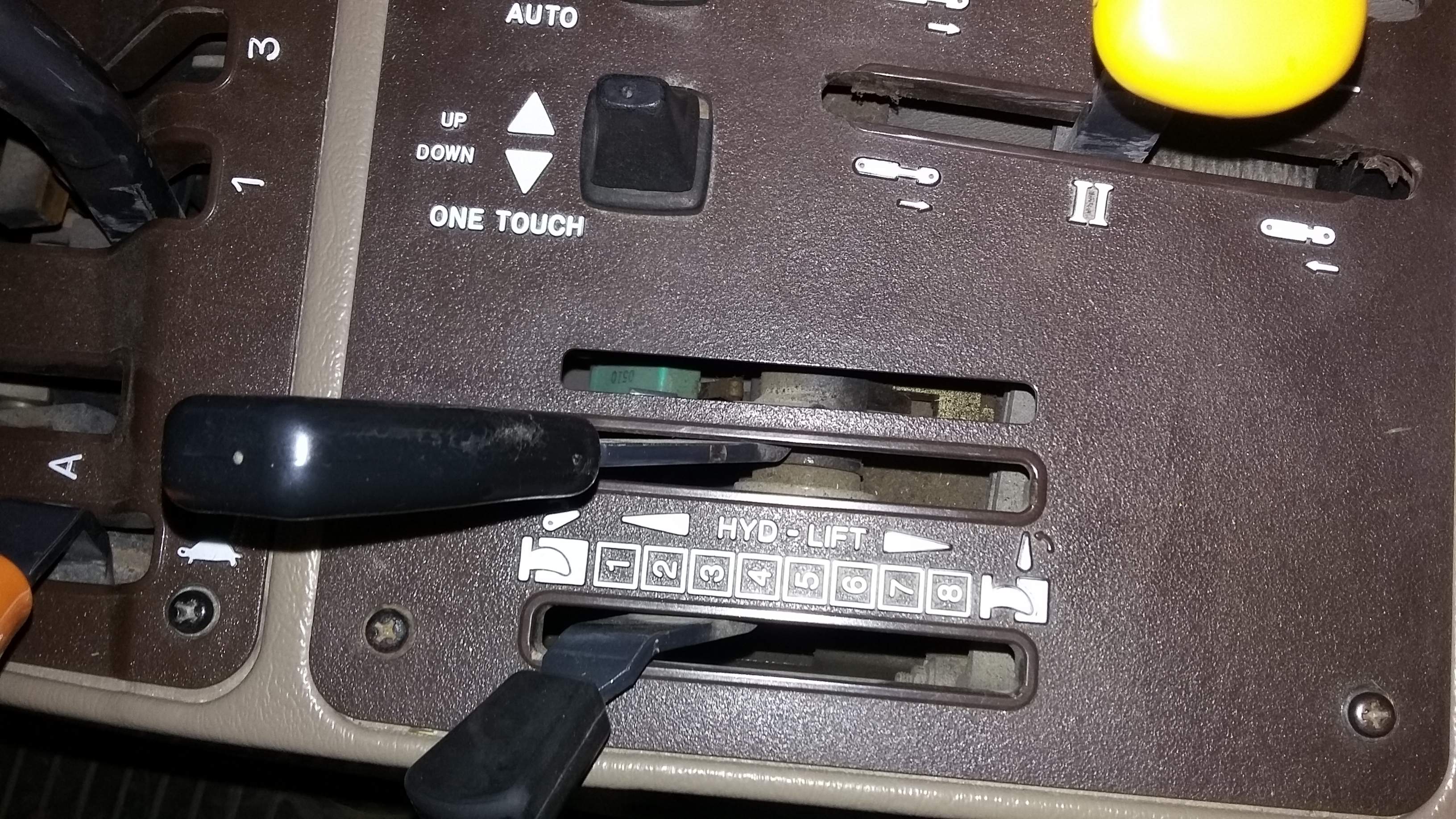

UP down toggle switch:
Auto Light (just above switch) off: Light on dash comes on immediately with UP toggle and extinguishes immediately with down toggle. Actual 3 pt position depends on speed of hydraulics.
Auto Light on, no toggling of up down switch, 3 pt down: If steering over 35 deg. or upon shifting shuttle to R, dash light immediately comes on and 3 pt raises at the rate of the hydraulics. If you want the 3 pt down once up, toggle down and it will come down, dash light off as soon as you hit the toggle.
I didn't play with what happens if you were up in auto, dropped it with the toggle, still have steering and shuttle in same position and you want it back up.....guess you just have to toggle back up manually as nothing changed to tell the auto circuit you went down....aka steering the same and shuttle still in R........buttttt I can check tomorrow if necessary.

Today's activities. Only addressing motor, rear mounted position lever, auto function, toggle switch, interior position control, 3 pt. position (everything else is already covered):
1. If internal position control is up, nothing else works because there is an arm on the control shaft (to the internal hydraulics on the right side of the main casting) that blocks the motor or external position control from changing anything....they are on a separate concentric shaft. The motor can move like it's going to do something but the connecting shaft is slotted and it just slides along the slot...no connection to any control arms.
2. For the auto function, toggle switch (regardless of light on or off), or the external position control to work, the internal position control must be down or somewhere other than full up. With it Full Down (or variances thereof) the following can occur WITH THE ENGINE RUNNING:
Auto light....................Toggle.................3 pt position
OFF.............................Up-Down..............follows toggle direction.
ON..............................Up-Down..............follows toggle direction.
ON.........................................................3 pt down, turning beyond 35 degrees or Shuttle in R, 3 pt lifts to full up.
Only way to get it down is to toggle it down, shuttle out of Reverse. If you have 3 pt. down and go back into R/steering position, it will come back up.
If Auto Light is off, F-R shuttle/steering positions have no effect on position of 3 pt.
A motor failure will prevent the toggle or the Auto function from operating the 3 pt when F-R and steering are in the active positions. Motor failure could include loss of power or return caused by a defective supply component.

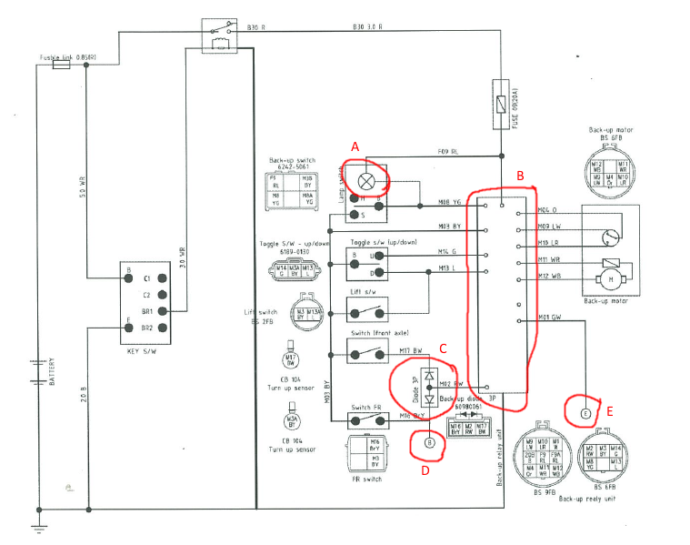

1. I assume the PWB you are describing in the Back Up Controller shown on pages 6-28 bottom and 6-29 top?
2. Page 6-25: Rectangle on right side of schematic to Lamp Switch pin B is YG (yellow green or grey stripe). Pin H of that switch is not connected and S is. Do you get continuity through the switch when the button is pressed...on off thing. Next, I need to know whether the connection to pin B brinds in 14v or ground from the big rectangle (assuming it's a relay).
3. I need a clear image of the top of the circuit card. Looking for a relay, pinout identification and part number if possible....somewhere on it should be/usually is the part number. Relays are cheap....like a buck from China. I just had a similar problem with an LG air conditioner....compressor relay was old and welded shut....wouldn't turn off. Got the PN off it, googled and had a replacement for a song.
4. When you measure 4.5 volts at the front axle sensors, do you have the plug removed, probing the power input pin? Do both read the same voltage?

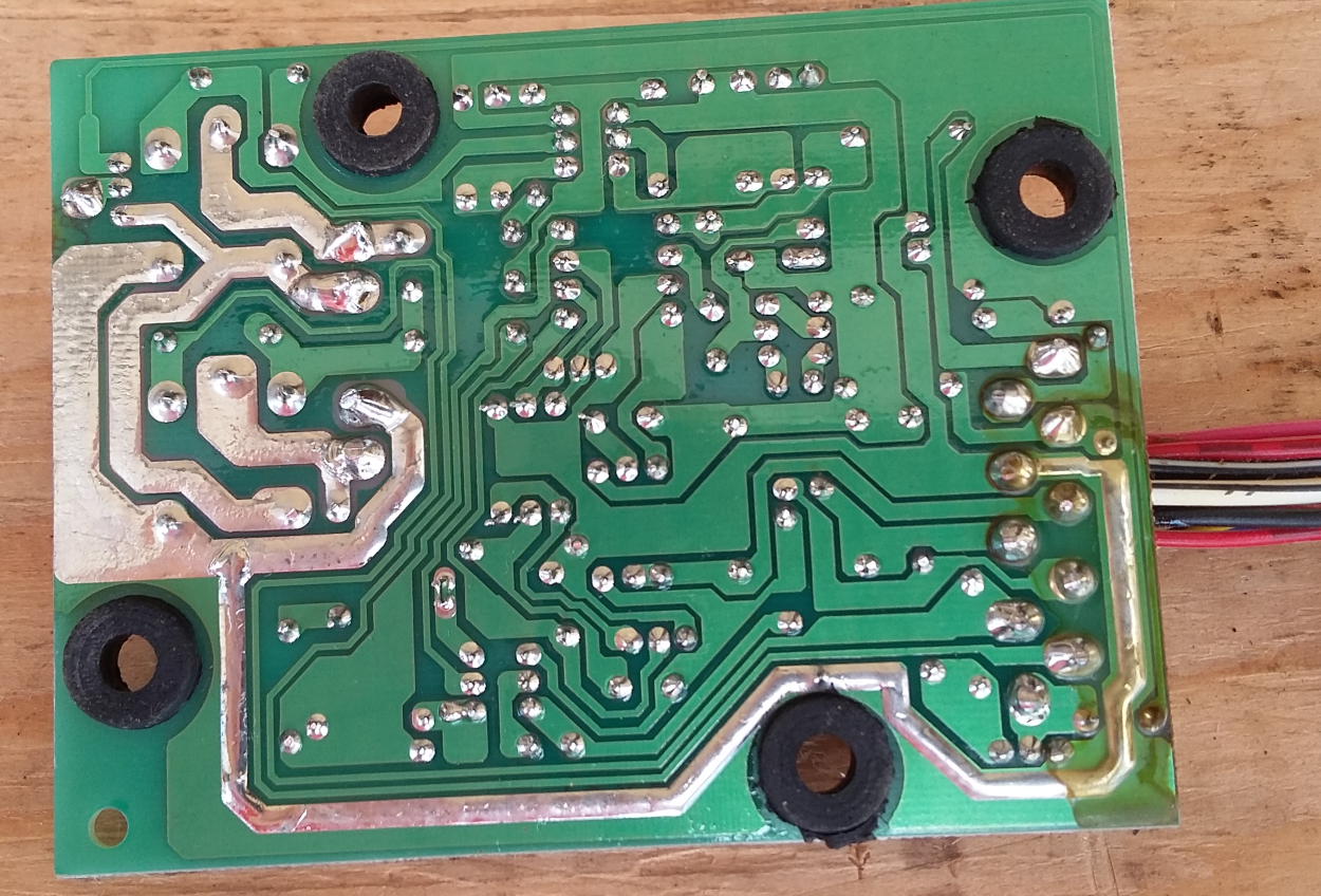

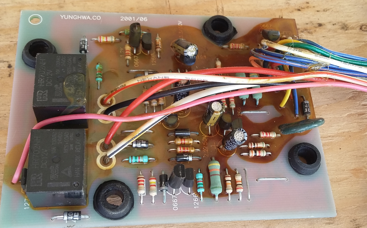

The control PCB is located in a plastic housing under the panel holding the tractor seat.
It has those two large connectors you spoke about and shown on pages 6-25.

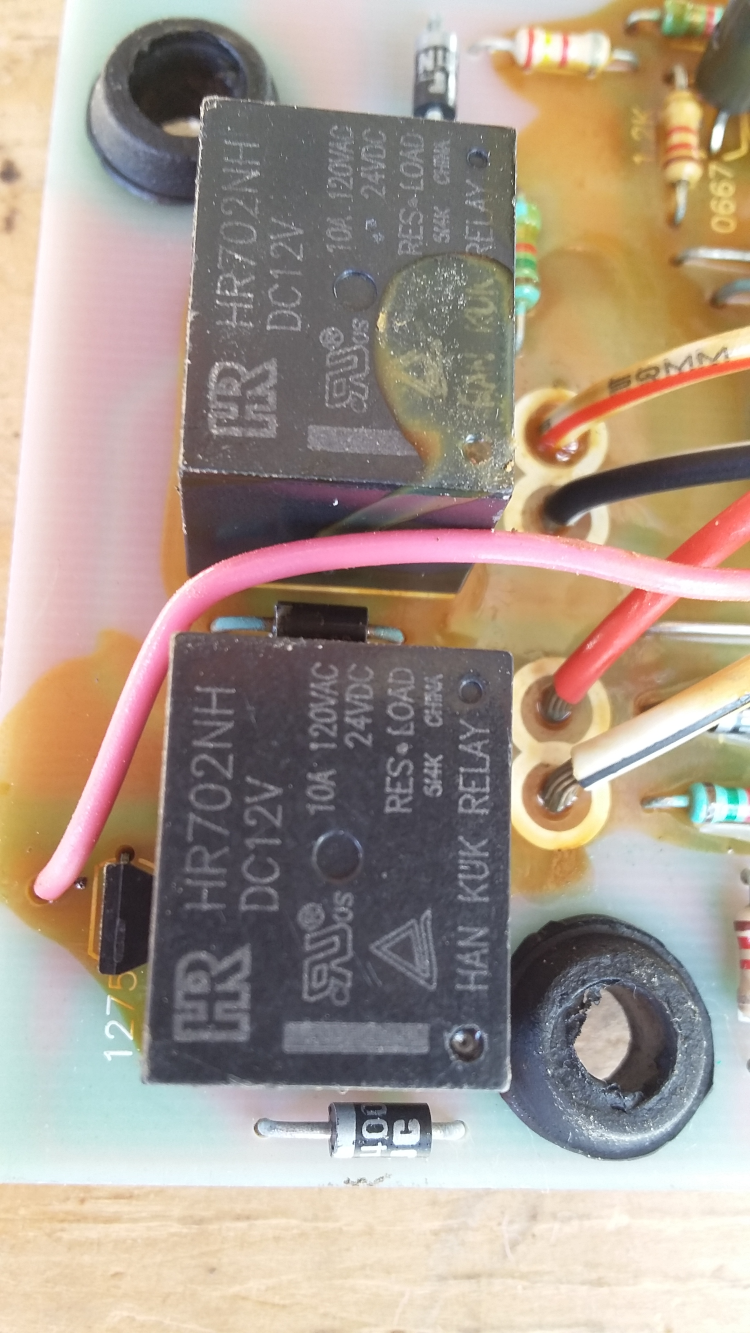

I have attached some photos. This PCB contains two smaller relays, and when you use the up down switch, you can hear them operate.
I tried to do voltage testing, but it lead me to more questions then answers and the voltage is only on most of the system while the motor runs, which is about 2 or 3 seconds so it is near impossible to trace and if you disconnect anything it changes where the voltage is found.
First for the back up switch, i see that the Red with (L) blue line wire, has a good 12 volts at it, but the Yellow Green line wires, (2 of them) have about 11.5 volts which seems to tell me that they are connected to other voltage sources looking for ground?
I find the wiring diagram lacking good information. On that switch they use the letters S, H and B, but do not transfer that information to the connector.
I find that the push on operation seems to connect the YG and BY wires.
Also i double checked all the switches and when disconnected you can test them for open/close and they all work as they should.
I don't understand the MO3 Blue Yellow line that interconnects all these switches other then they put the voltage to the MO3 pin on the PCB connector pin 11 connector B.
I did follow some of the debugging testing they laid out, and for one item, Connector A of the Back up Controller, it show that Pin 5 should have 12 volts when the key is off and Pin 6 should have voltage when the key is On, however i find power on both pins when key is on. And question why there would be any power back there when the key is off.
I have to wonder how correct this trouble shooting is.
As for wire B that you state goes to the back up relay, this wire must act as the ground for that relay to operate.
I know that I had to pull that relay, as the lights seem to be staying on, but having it removed, should in no way effect the operation for the auto up side of things, which again makes me think that the MO3 BY wire is use to ground out the switch connections.
I still have no idea of where to look for those two diodes, and not sure how they help if that path is to ground.

Looking at the PCB, I cannot see any damage, but since that board is almost impossible to understand, do I just replace it?

Edit 1: The rectangular box on the right side of the wiring diagram IS apparently this PCB.
I think we found the location of the steering diodes. You can disconnect the connectors and get across each diode to check it's integrity.
Nothing appears to be overheated/damaged.
The fact that they are using premium resistors (painted Metal Oxide), lends itself to resistors that survive the test of time without changing value like carbon composition.
You have the ability to setup a bench test station for that PCB? We can trouble shoot it and determine what's working and what's not if anything.
The puzzling thing is that we have found the "work center" like the axle of a wheel. The rest of the system consists of remote sensors, like the individual spokes. We have several functions that don't work from individual, remote sensors........as you said, confusing. Has to be common ground somewhere besides this PCB and the motor.
Edit 2: More about the card....on second thought.
There is your part number for the relay if needed and 10 ampere rating. Each has 5 contacts making them SPDT. That simplifies that.
What I don't like is that something has spilled onto the card and ran all over it, under the relays, and on the back side (opinion). Who knows what that is and whether or not it is conductive. If it were my card I'd take 91% alcohol and a wooden stick cotton swab (ebay has them with a long stick) and see if you can remove it from both sides......since your hay is up (assumption) maybe you have time to work on the problem/potential problems.
I don't think I would worry about what, if anything may have gotten under the relays since they are single pole and seem to be working as designed.
Edit 3:
"First for the back up switch, i see that the Red with (L) blue line wire, has a good 12 volts at it, but the Yellow Green line wires, (2 of them) have about 11.5 volts which seems to tell me that they are connected to other voltage sources looking for ground?"
I'd opt for steering diodes being in that circuit and you are seeing the forward diode drop.
"I don't understand the MO3 Blue Yellow line that interconnects all these switches other then they put the voltage to the MO3 pin on the PCB connector pin 11 connector B."
My take is that its a common buss, either voltage or ground. If we knew which it might help in locating the problem.
I'm still curious about your 4.5 volts at the front axle turn sensors.....That very well may be a clue to the problem, You just have a remote switch. If you measured it while closed then I can buy it as there are other components in the circuit and they are dropping part of the 14v. If you measure it with the switch open....(steering straight ahead I guess is when it is in the open state) then you should read full 14v......a piece of data that would be helpful.
"I did follow some of the debugging testing they laid out, and for one item, Connector A of the Back up Controller, it show that Pin 5 should have 12 volts when the key is off and Pin 6 should have voltage when the key is On, however i find power on both pins when key is on. And question why there would be any power back there when the key is off.
I have to wonder how correct this trouble shooting is."

The issue of the coating/spill on the PCB, in the photo you can see that the wires have some sort of paste on them, is thick and sticky, and i think that is what overtime and heat was rain across the pcb. I don't think it is the source of the PCB not working.
I am going to do a few more tests, and voltage reading.

After looking at the PCB picture you took, I checked wiring color codes vs the wiring colors posted on page 6-25 and the rectangle at the right of the diagram is in fact the PCB. Without a schematic to that one can only guess what all goes on internally.
As I mentioned earlier, with so many things being haywire and nothing else (excepting the PCB) but switches, relays, and insulated wire which you have pretty much checked out, it does seem that something is amiss on the card. If you were of a mind, you could take the circuitry side and copy that to a piece of transparent film. Then with the board component side showing and that film laid over it you could pencil out a schematic and maybe figure what on the board has failed.

And I should have looked here sooner, once I discovered that the PCB had been connected wrong when I purchased the tractor. Someone must have being doing so work on it and crossed the up motor and the control board connectors.
As you recall once I corrected this error, the up/down switch functioned correctly.
Also both you and I second guessed the low voltage at the front axle switch, which was only around 4 volts, but once working it reads about 11.5 volts.
Anyway, once I looked at the drawing on page 6-30, i knew it had to be something with this, as the backup buzzer and lights had been on all the time until I pulled the fuse for that circuit.
However doing that, broke the chain of the auto circuit so that it couldn't function.
