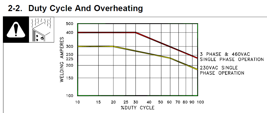

I have a High end Tig welder that will put out 300 amps on 3ph but it only does 200A on 1ph. I have a Mig unit that is the same. 400A on 3ph / 320A on 1ph. Not that I need the power on Mig but Tig welding it could sometimes help on thicker Aluminum. I was just curious if the converters were worth messing with.

The only advantage there would be smoothness or what not. With 3 phase you are splitting up the power across multiple cables rather than just 1 (ignoring the neutral part of the equation). That means you can get more wattage across smaller cables, although you have more of them. It's easier & more efficient at higher wattage to run 3 phase with smaller wires. But converting from single to 3 phase means you'll need a beefier wiring & a phase converter. You won't gain any watts on the input side of the equation. The machine could handle more watts though.

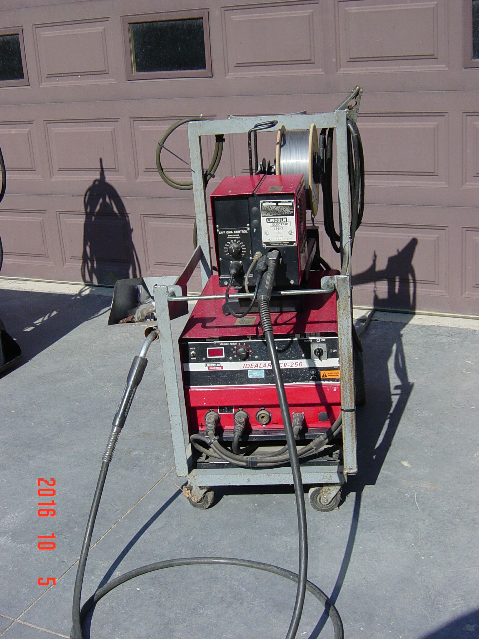

Some Millers can be converted from 3-ph to 1-ph using a model-specific Haas-Kamp conversion. This Spring we converted two CP200s and a CP300. The 200s required two caps ea, and the 300 needed four to go 'by the book'. (Each capacitor uses a bleeder resistor vs store a potentially dangerous charge when shut down.) <$50 to buy the bits for each, and Pat's employer was giving away old Millers.
If you get on the Haas-Kamp conversion sites and threads you should find the detailed instructions. Cheap as we are we're welding a lot here with 100% CO2 using beverage svc bottles and the thread adapters for such that come with some gas valves.
Rotocons need the legs balanced for load. Static converters are the pits w/o an idler motor added. Running extra motors/machines no-load can be a way to smooth out the phases. YMMV
Phase Perfect (TM) is best if pricey, costs way less than adding three phase service, and doesn't need tweaked for load like a RPC. Several $K to play.

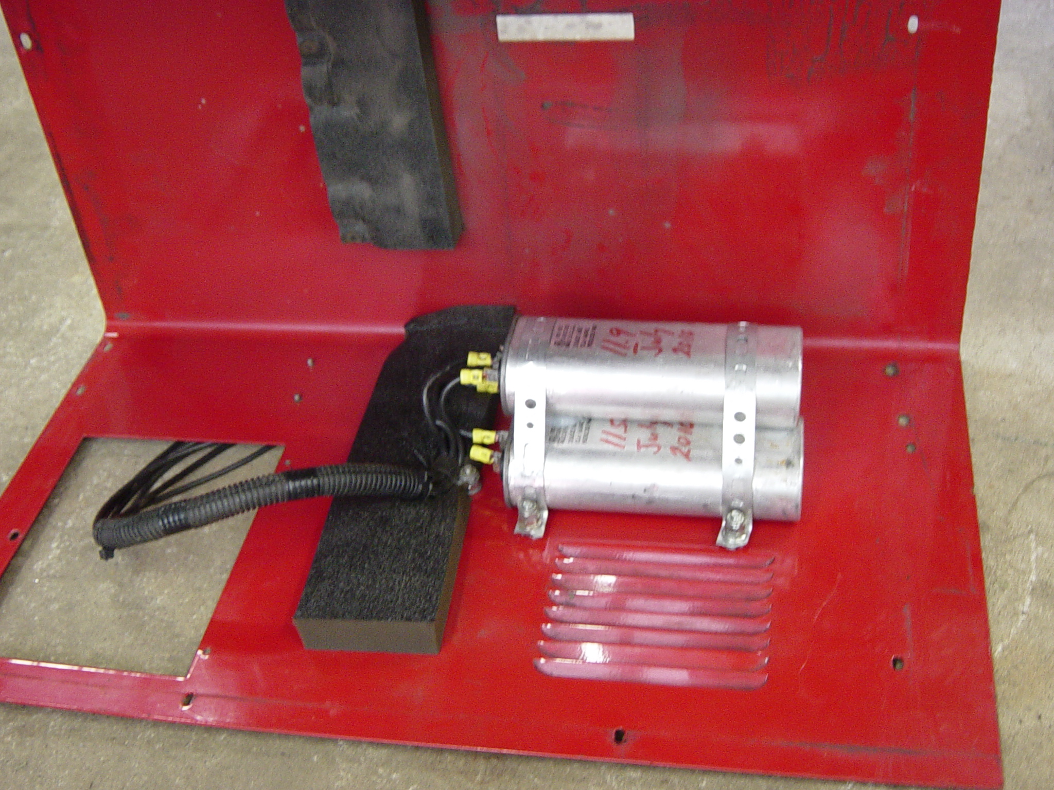

I added these caps good for the 600 Volt line, to try and correct the manufactured phase that the Lincoln Computer did not like. It helped, but the Math changes when the load changes.
Having to start and stop a Rotocon, everytime you want to weld was a giant PITA! And my 10 HP unit drew something like 500 amps or more inrush current!
