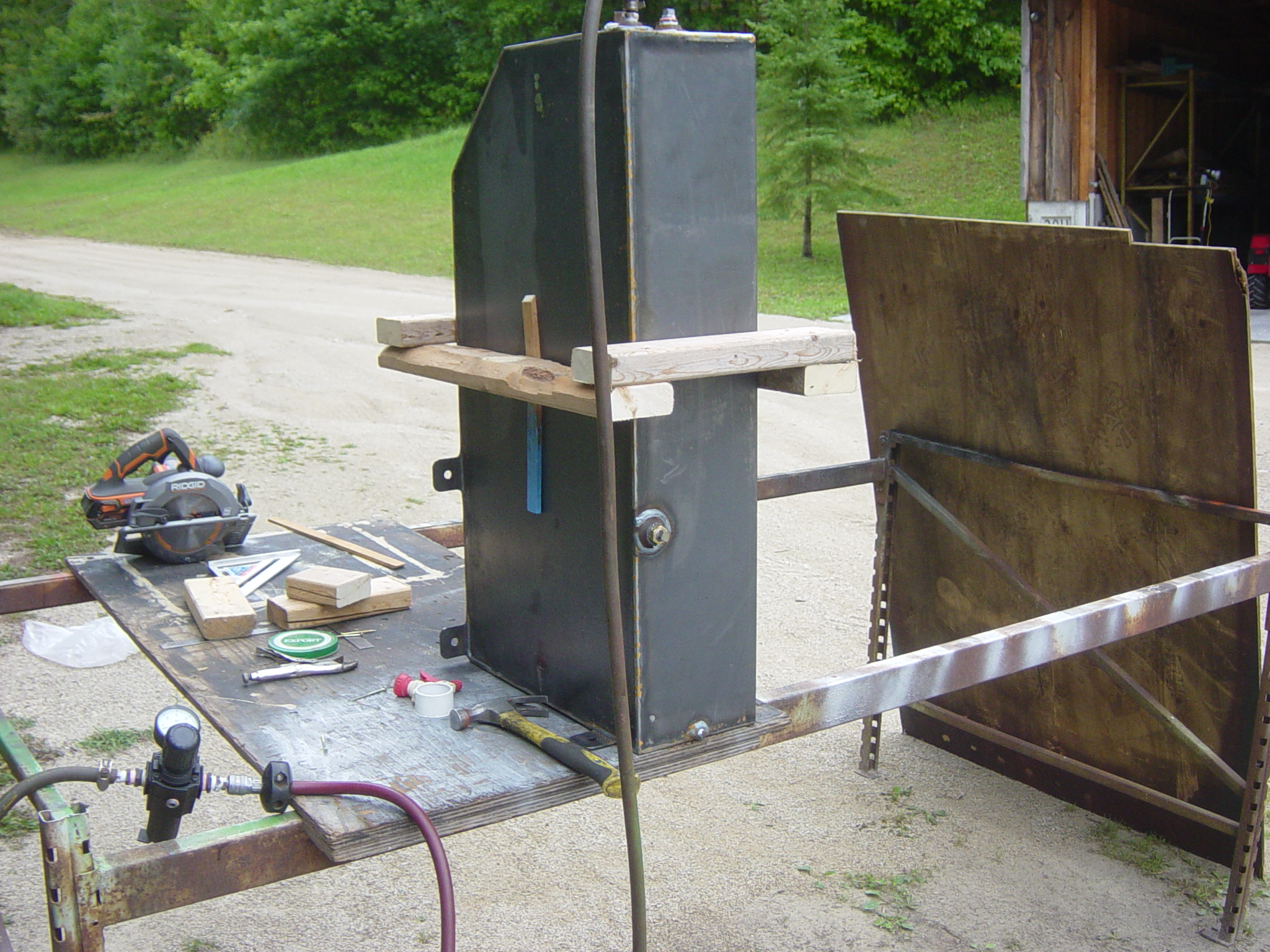

Not sure what a pressure relief on a heater is set to. I don't recall it going open. I am not quite that dumb that I would just put my shop air to the tank. Either just give it little shots of air, or I used a regulator. In any event, dumb enough to ruin my tank. Maybe on the verge of starting to leak anyway, so maybe a blessing. Who knows?

It always amazes me, how much squish there is in the air, before anything happens. And then having to relieve that pressure. It is a nuisance.
Pressure testing new Diesel Fuel tank Last year with various precautions. Regulator and appropriate bracing.

3 to 5 psi would be getting close to too much pressure;
27.72 inchs of water pressure = 1 psi
or 1 psi will lift water in a column or hose up 27".
Fuel has a density of about 0.9 compared to water so 1 psi will lift fuel approximately 30",
so it you need to lift your fuel 6 ft or 72" you would only need just under 2.5 psi of air to do so,
as long as the volume of air does not exceed the volume of fuel leaving the tank and the tank can handle the pressure it will work.
I have see empty oil drum distort and rupture with 5 psi in them.
   / Thoughts on using air pressure to push fuel out of transport tank to machine. #16
My only concern is the tank. Most likely its not designed for pressure. 3-5 psi is still a lot on a big tank. A 200 gallon tank would have 3900 pounds of pressure on each wall at 5 psi.
In my opinion you should find another way. If you have air pressure available, use it to run a pump.
