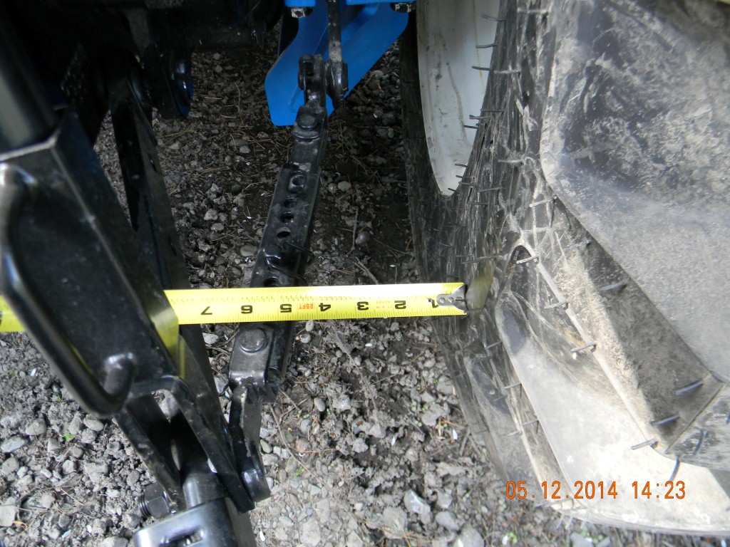

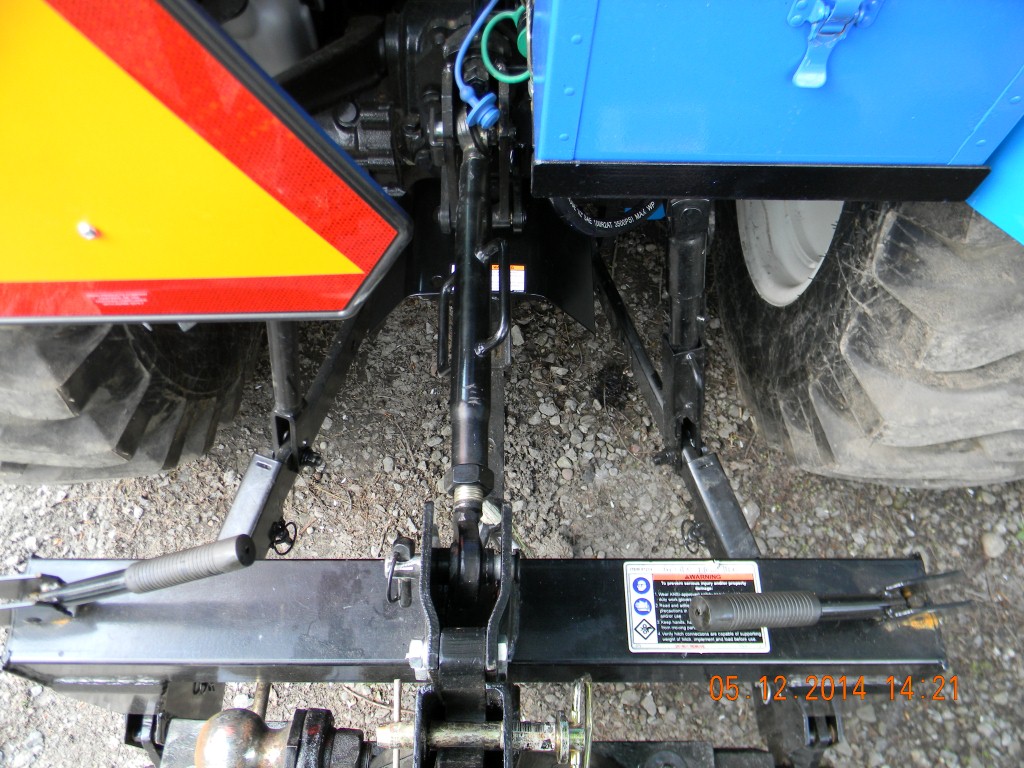

I am having a heck of a time keeping my 3 point arms out of the tire. They are either getting wacked by the knobs on the tires are rubbing hard on the sidewalls. Level ground, not much of a problem but my property has so little of it! Now I'm trying to push the implement over as far as I can and then tighten the link on the far side (which is a bit of a feat). Then doing it again on the other side. I'm still rubbing on side slopes.
I've tried to look at other stabilizer links on the 'net but can't tell if mine is inferior to other designs. I do see chains and turnbuckles but they're on smaller tractors. There is a lot of flex/slop in my stock links on LS R4041H. Is there an aftermarket design that is better and compatible? Is there some value of having a lot of slop/movement?
I thought I'd run the arms to the inside of the BB but the Cat 1 pins aren't long enough. OTOH, I thought the wider the stance on the 3 Point, the better stability of the implement.
Any ideas or examples of better ways appreciated.

Is you implement a cat 1 or 2? It looks like it is with the arms in the cat 2 space. Just the way it looks from my angle.
Ok no it isn't. Put the bolt on style cat one lower link pins on the inside and get them closer to gather. It really looks more like the spacing is for a cat two hydraulics. What is the spacing between them now.

Straighten the stabilizer mounting brackets at each end, and on each side, then set your rear wheels to a wider stance. They look awfully narrow in the pic (which I know can be deceiving, but still....)

Do you have a photo showing the entire tractor from the rear? It looks like the wheels are mounted inside, but not so much from the position of the fenders. Would be nice to see a little more.

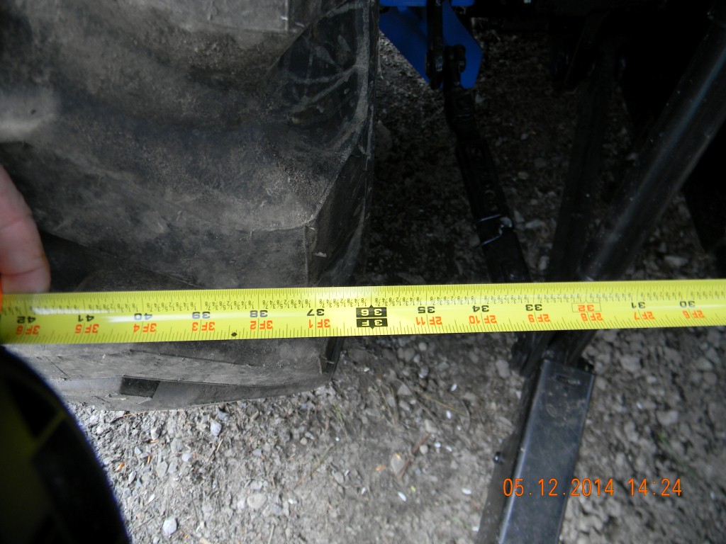

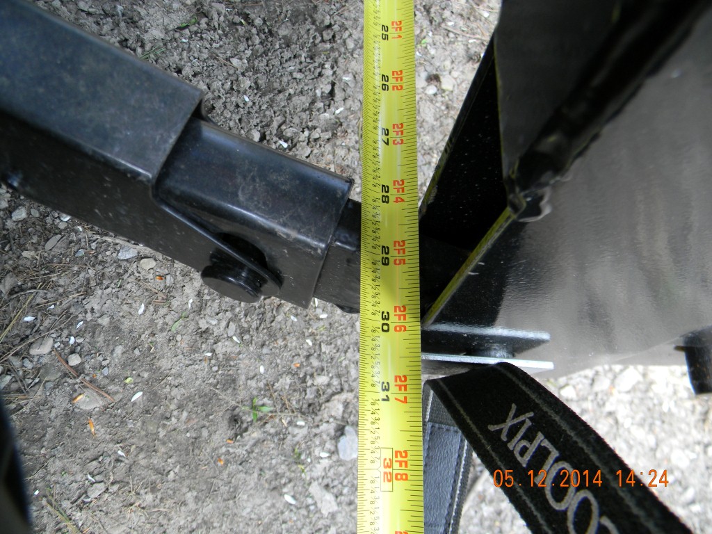

Looking at your 2nd pic it shows the arms are as far out (wide) as they can go in the attachment. If you pull the pin on the arms in pic 1 and push the arm on the attachment to the inside (closer together) they shouldn't rub the tires.

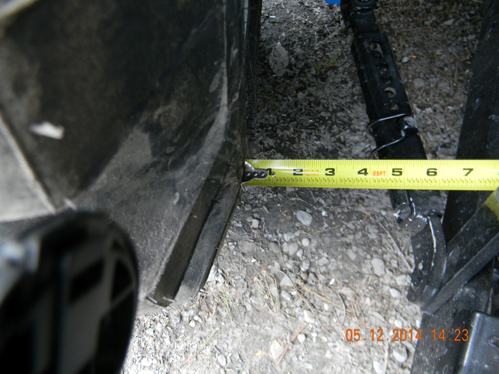

I have the LS XR3037HC and my arms don't come close to the tires. My distance between the rear tires is 37" and 66" outside to outside. With my Cat 1 attachment on I have 5" between the tire and the lower arm. With the Cat 1 attachment on I measure 29" to the outer edges of the arms. If yours is wider you might have a Cat 2 attachment.
I don't think you can swap tires side to side but not sure. Spacers would work to move the tires out further.

The inner side plates are just over 26" apart the way it mounts now.
They are not bolt on. The Cat 1 pins are too short to run the arms on the inside. Also, the inside surface is not flush. So not only longer pins but also a wear washer to run the arms on the inside would be necessary if that's the way to go.
Does the BB make my ***** look too fat?
Pictures lie a little. The BB extends 4" outside the wheel tracks.

Top picture you posted. See the kink in the inside arm (we'll call it the male side) where it attaches to to the tractor? You need to straighten that out. Pull the pin, straighten that joint and I bet you can get a whole nother hole of tightness in the linkage.
Ha! I see you run his big brother. The end-user modification you speak of is in your future, too. Back up the BB a few times and yours will look just like mine. For awhile I was thinking one of my links was defective as it was bent and the other was straight.
Now they're both bent to match without any effort on my part.
Thanks for taking the time in your reply. Interesting data points. My 'bigger' tractor is only 30" between the tires (total width is about the same with 17.5x24 R4s). Mounting the BB, the arms are also 30" apart on the outside.

Bob,
I am running R4's 43x16.00-20. My picture (#4) shows the 37" width. I measured from inside lug of the left to inside lug of the right. Tires are 16" wide across the lug edge to lug edge. Plus another 2" if you count the sidewall bulge.

It appears to me that Bob's sway bars are in "compression".. They need to be straight. Pull the pins and hit them with a rubber mallett, until they are straight not scissored in line like that.. When they are scissored in, they are shorter than they should be, so you are choosing a hole you can get the pins into and that is the wrong hole.
The bars work by as the implement tries to sway lets say left, the right bar should have extension forces on it, but since it is folded up it gives and lets the implement sway to the left and rub the tire. And when the implement wants to sway to the right the Left sway bar should be in full extension and not allow it to sway too far to the right so that it would hit the tire, but obviously in your photo your left sway bar is folded up . so it gives when the implement wants to sway right, and it allows it to hit the right tire. All you have to do is pull the two adjustment pins, raise the implement off of the ground, hit both sway bars with a rubber mallet to straighten the scissored joint, and put the pins in the correct holes to prevent the sway.. Check for sway now by pushing the implement side to side with your body and the bars should no longer hit the tires.. case closed.:)
