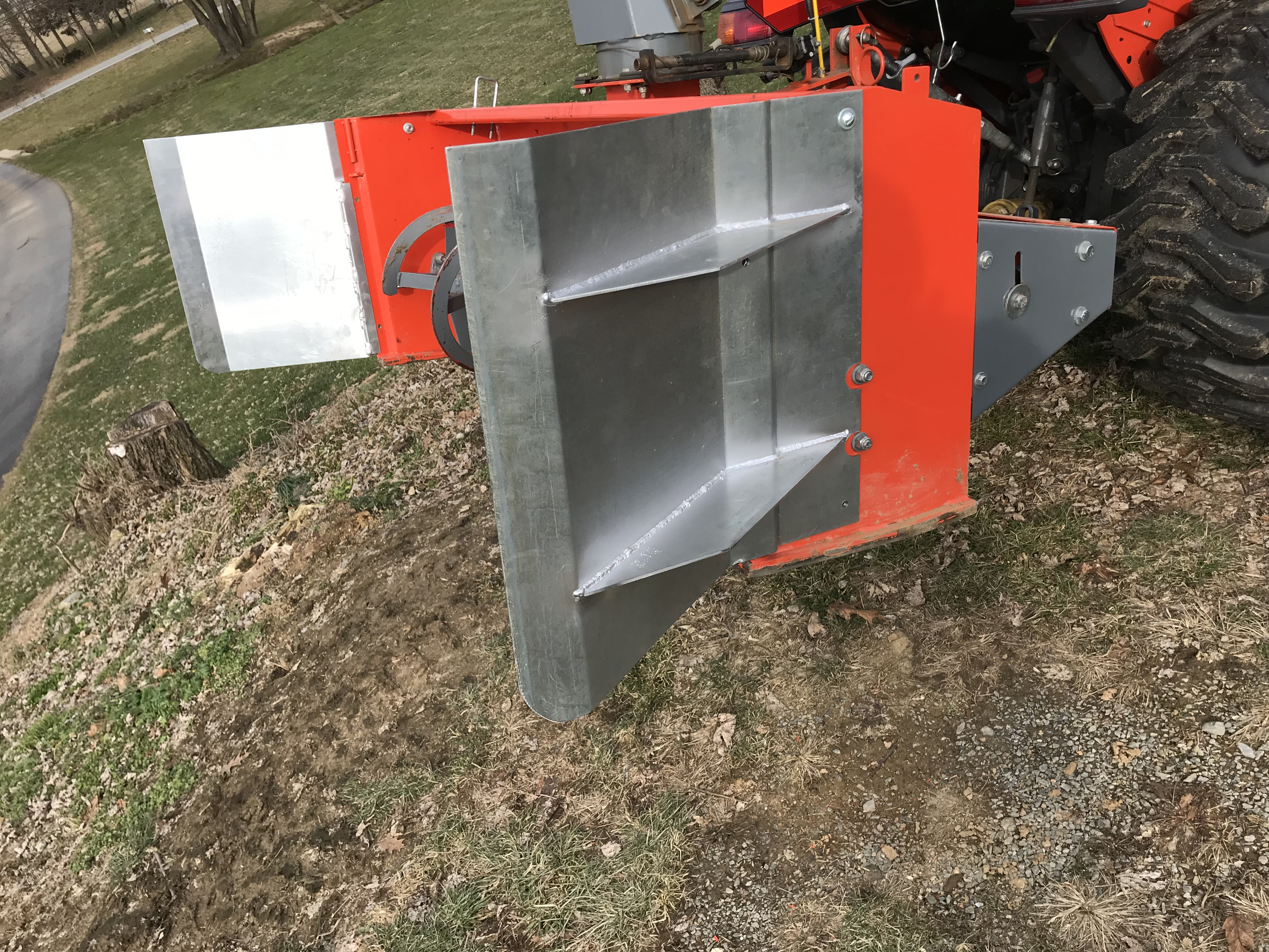

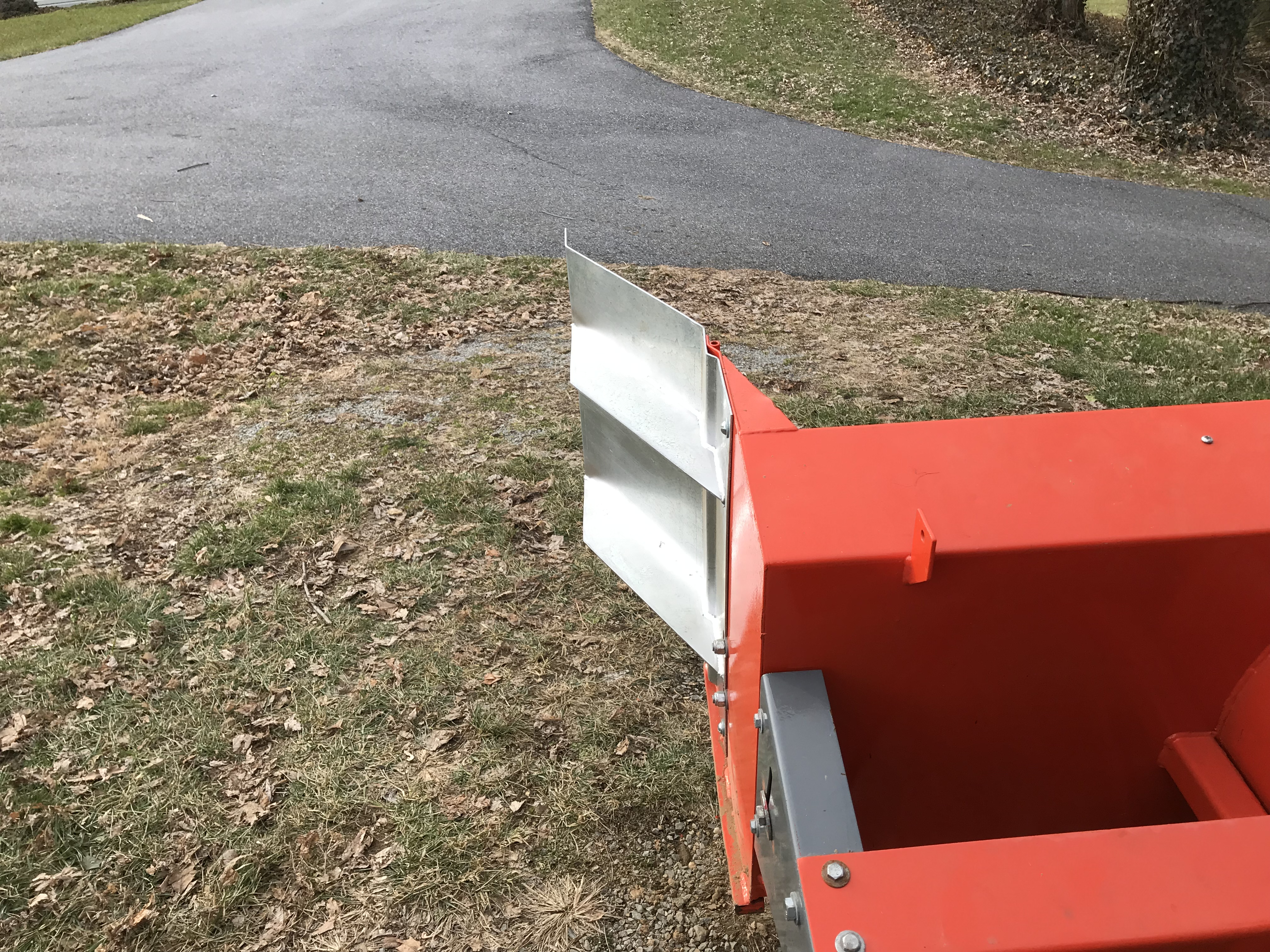

Good thought. I think a moderately clever person could put some modest wings on to increase the width to 66".
Made my 64" Pronovost wider. It was fairly simple. The extensions had a female end (three thicknesses of the steel, holding the middle one back) that slipped over the blower's sides. A couple bolts and it was good. There are reinforcements to prevent them from bending back.

Those wings look nice and will probably divert freshly fallen snow into the maw of your blower. I'd be interested to know how well they work in compacted, once (or more than once)-moved snow such as the plowback the highway dept. leaves across the end of your driveway.

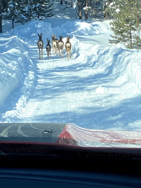

I live at 7,600' elevation in north-central Colorado on the eastern side of the continental divide. My tractor is a Kioti CK3510H with KL4030 FEL and R4 tires with chains, and a 900# ballast block out back. This is the time of year when we get our biggest snows and it is always wet, heavy, and comes down fast. This past weekend we got about 3' and I spent most of the day yesterday clearing our driveway and yard. I hope the road is plowed today so I can make my Covid vaccine appointment later. Following are a few thoughts and questions on using a tractor for snow work.
If you can push up a full bucket and dump it once in a while on a normal snow, a snowblower would be overkill. Fun yes, but overkill.
I move 95% of the snow I get driving forward with a backblade. If I get 12+ then I move the big stuff with the bucket and clean up with the back blade. Last time we got 24" overnight, I started on the right side of the drive with the bucket down, moved fwd and turned left a bucket width at a time. Then dressed with the back blade. Then plowed the neighbor out, then the other neighbor, then the other......... Getting a bucket so that I could move snow 10% faster once a year doesnt make sense to me.
I did make "feet" for the bb that hold it a little off the gravel at least until the gravel is frozen.

It worked well as long as the banks hadn't been there for any length of time. Thawed and refrozen piles were FEL work.
