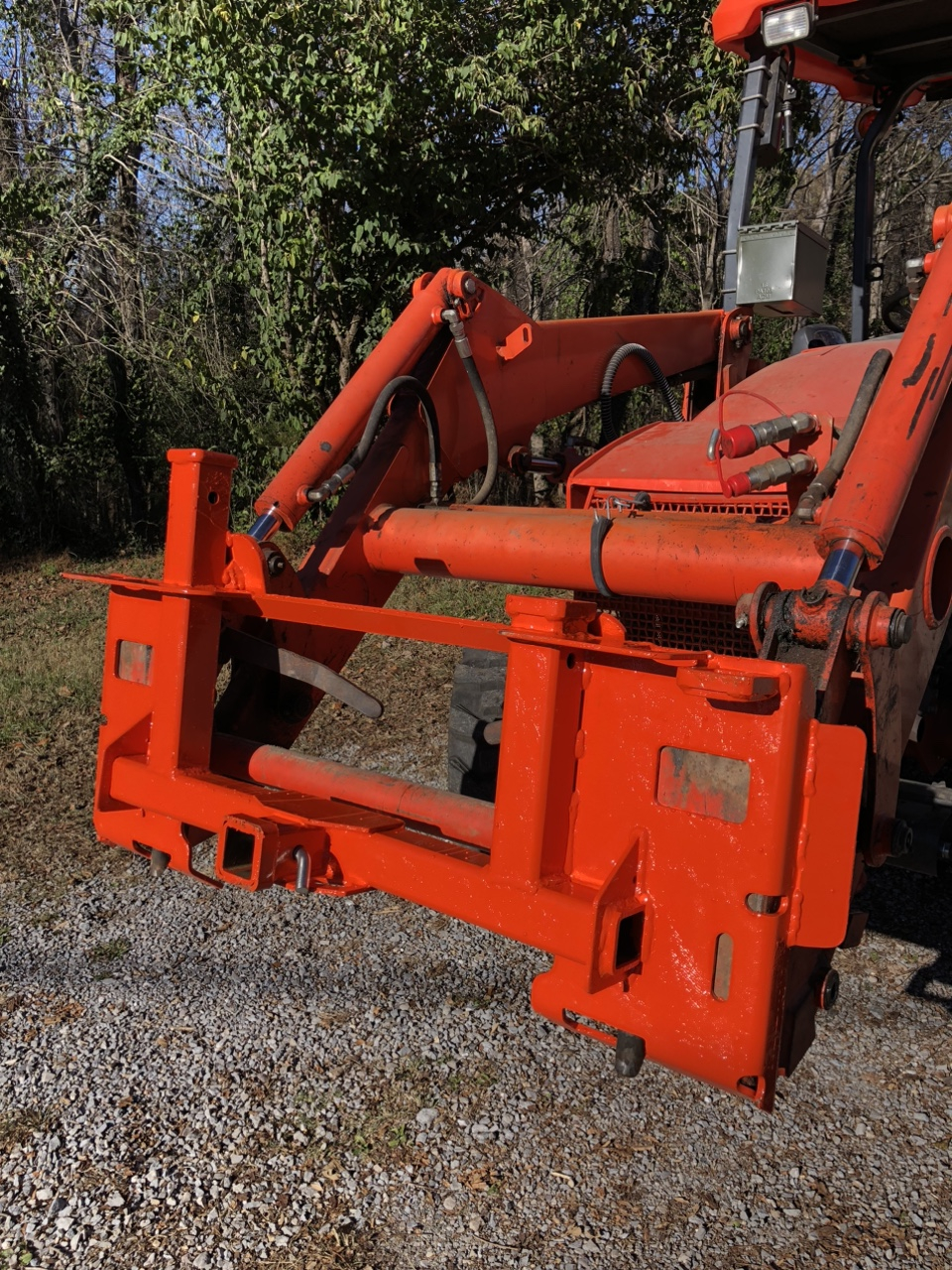

B26 ssqa bucket and backhoe qa buckets have flares or wings to help guide. Small tractor has a good site line anyway. They all should be made that way.

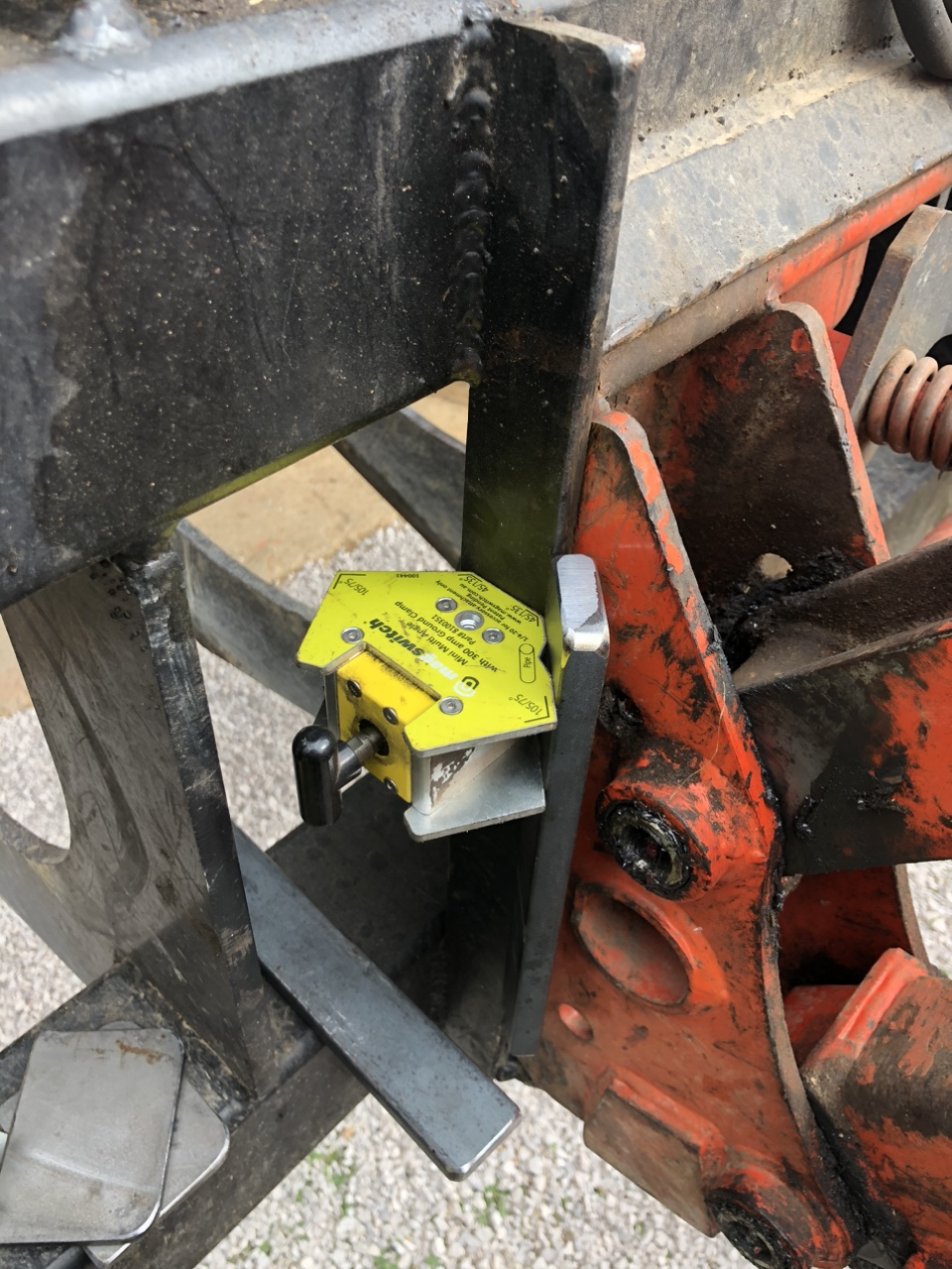

Bigger tractors I can’t see and often store FEL implements just inside the drip line of a barn or shed with uneven ground compounding the problem. Welding 1.5x0.5” flat bars on the sides at 45 degrees helped considerably. Attachment just want to jump on now. Greatly reducing time and frustration.
Grapple. Built with tight side to side tolerance that any unlevel up hook was hard.
Hitch plate. Added wings in build.
Just using a grinder and beveling the inside sides of the implement hitch helps some. Wings make it easy. Still have a few more attachments to fix.

   / Thoughts On Lining Up Bucket to Front End Loader #25
My Westendorf SSQA bucket has a vertically angled guide at each end so that as the loader lifts up it forces the attachment sideways to align the pins.
