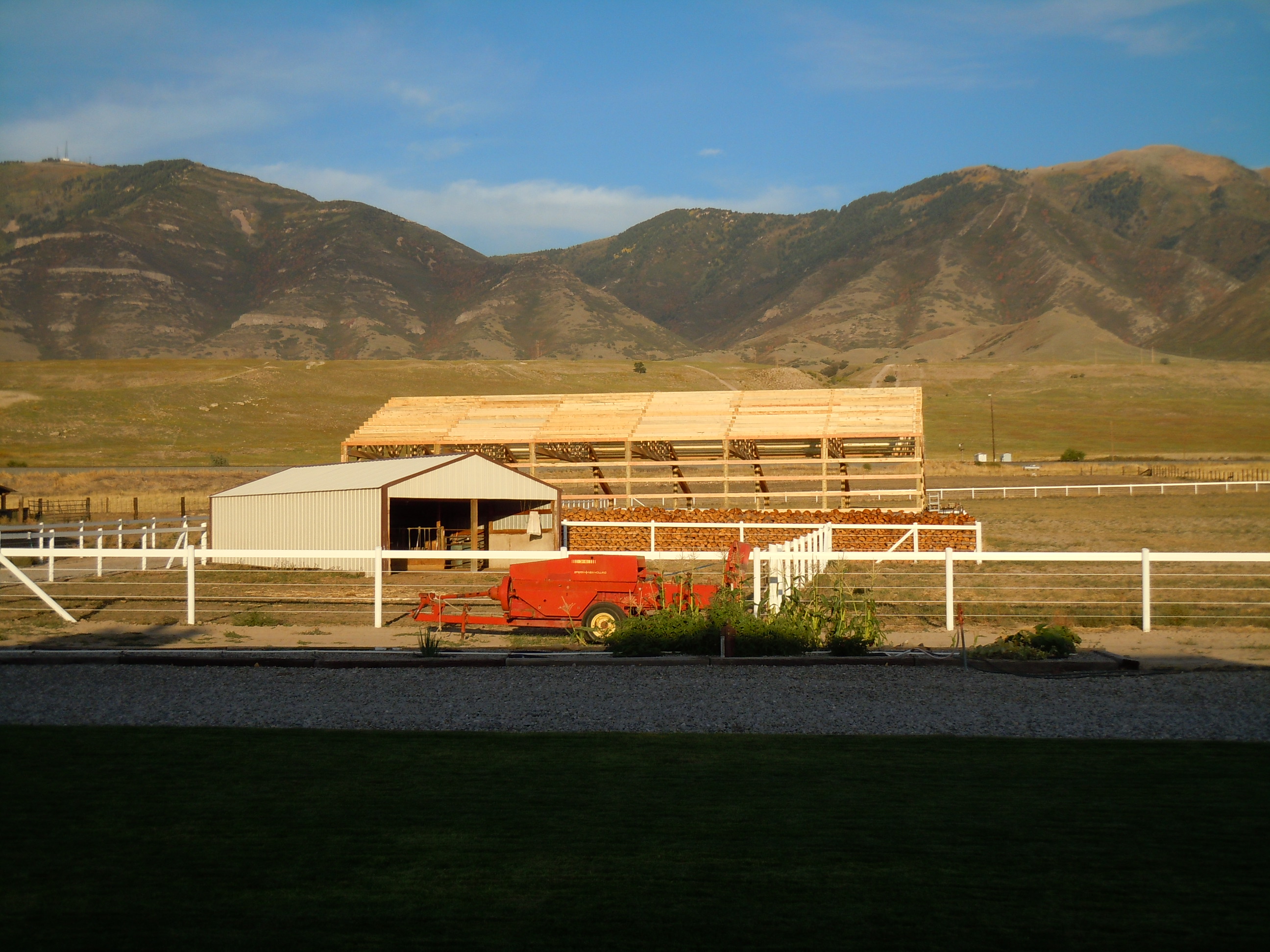

I think a pole barn style barn would be the best type of barn to build because you can just keep adding on as the need/money allows. Just make sure to leave enough room for the addition.
Flooring is different depending on area and humidity levels. SC I'm sure would be much different than Utah. I don't like pallet's only because of the mouse heaven it create's.
Here's a shot of my pole barn build, you can see how I could just add more post's and trusses and keep going longer.
Good luck and post lots of pics of your build.

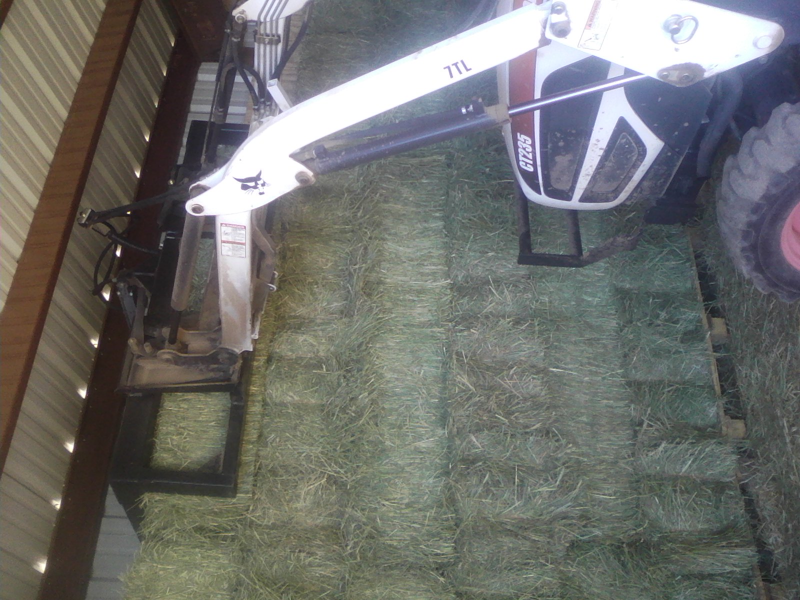

In the picture of me staking in the barn notice how close the roof perlin is. I haft to be very careful - thus my suggest to measure your max reach and add the 2 feet.
