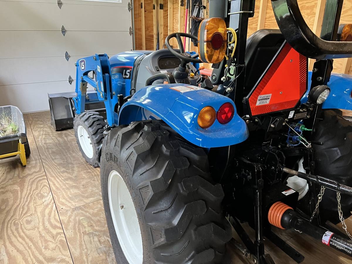

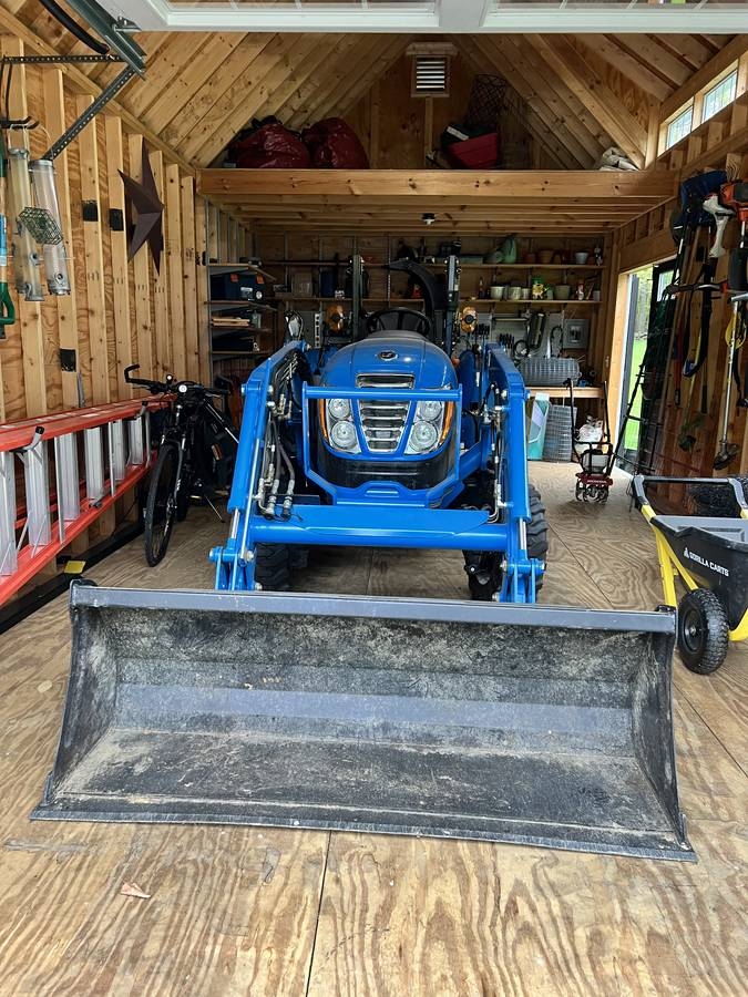

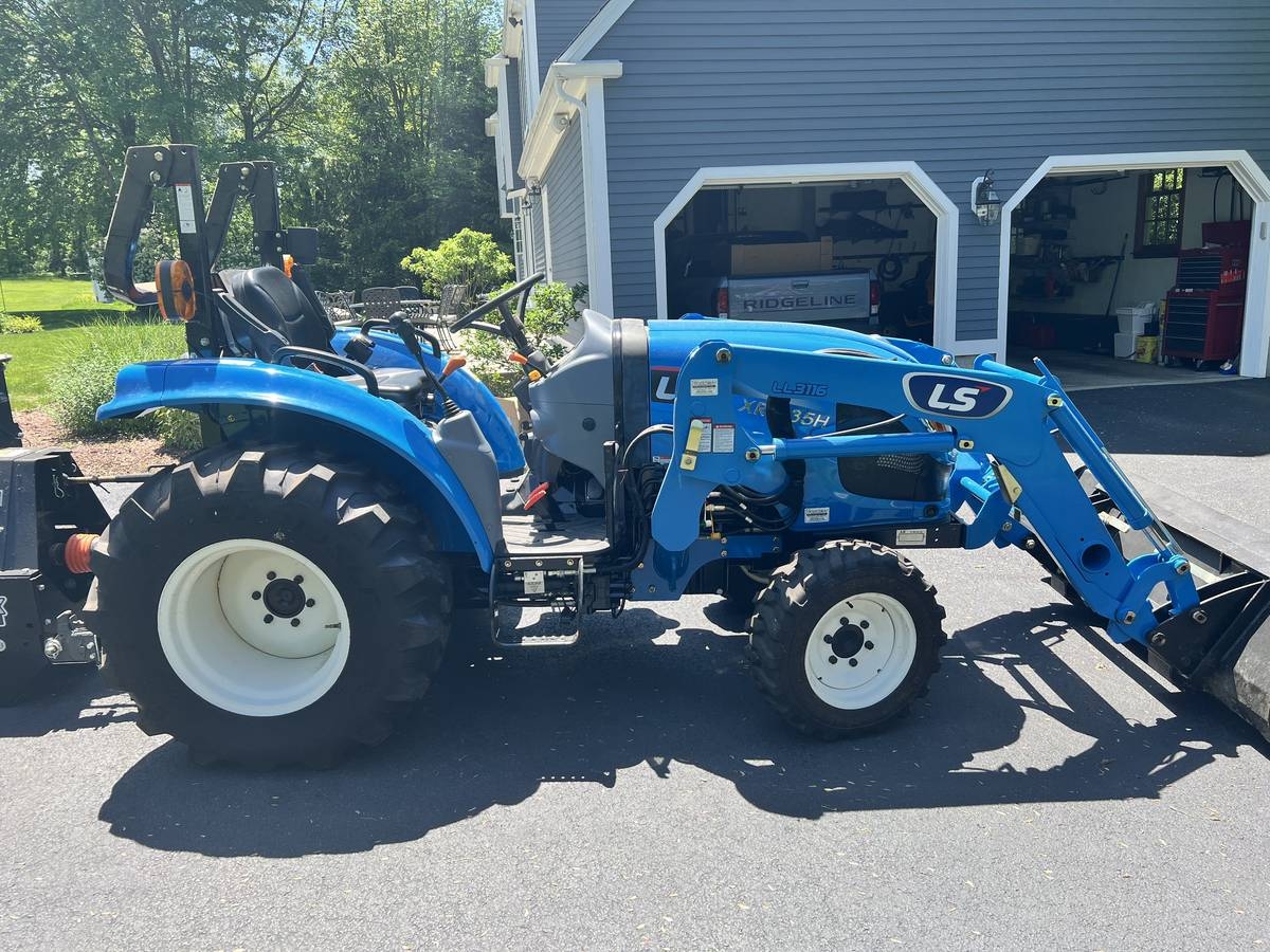

Here are some pics of the unit-

looks nice, clean, has dual rear remotes and 3rd function, hydrostat, suspension seat, etc. (looks brand new in those pics)
