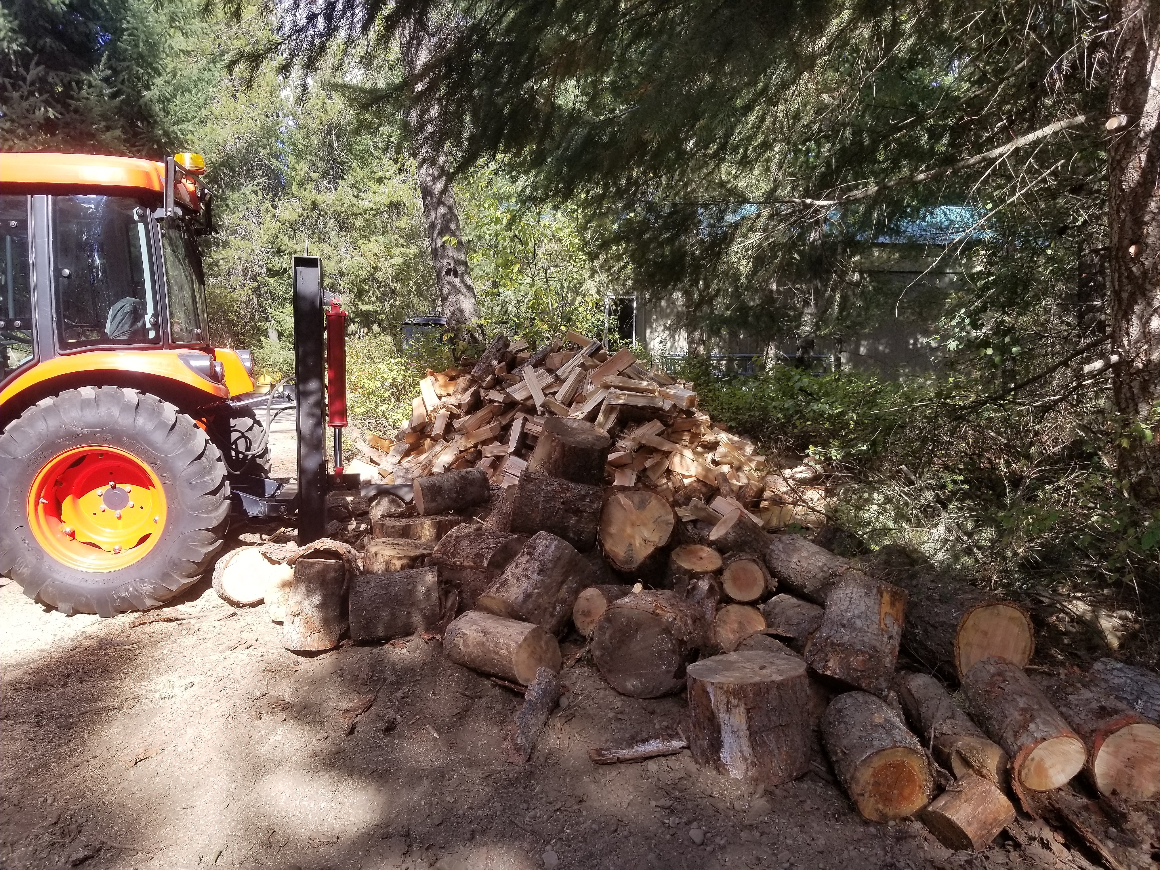

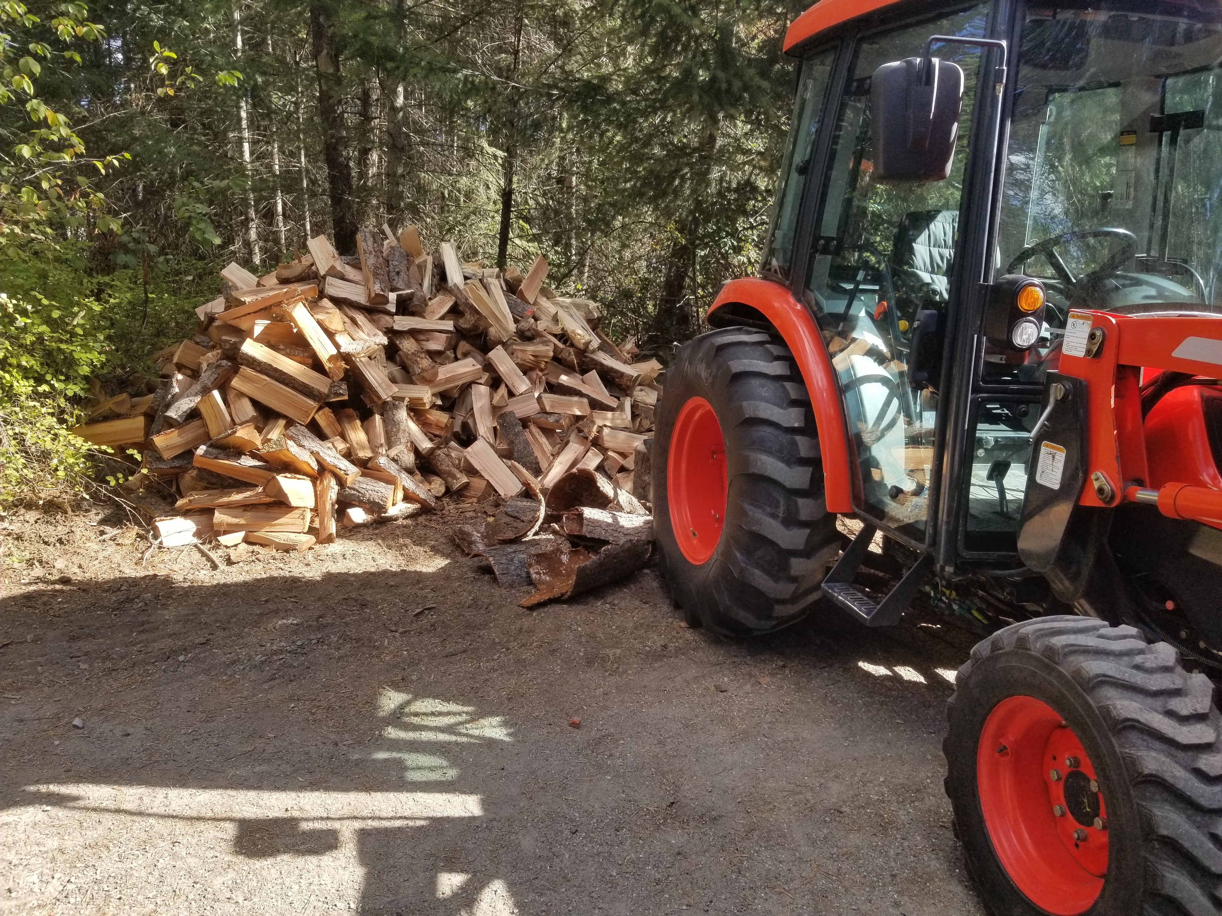

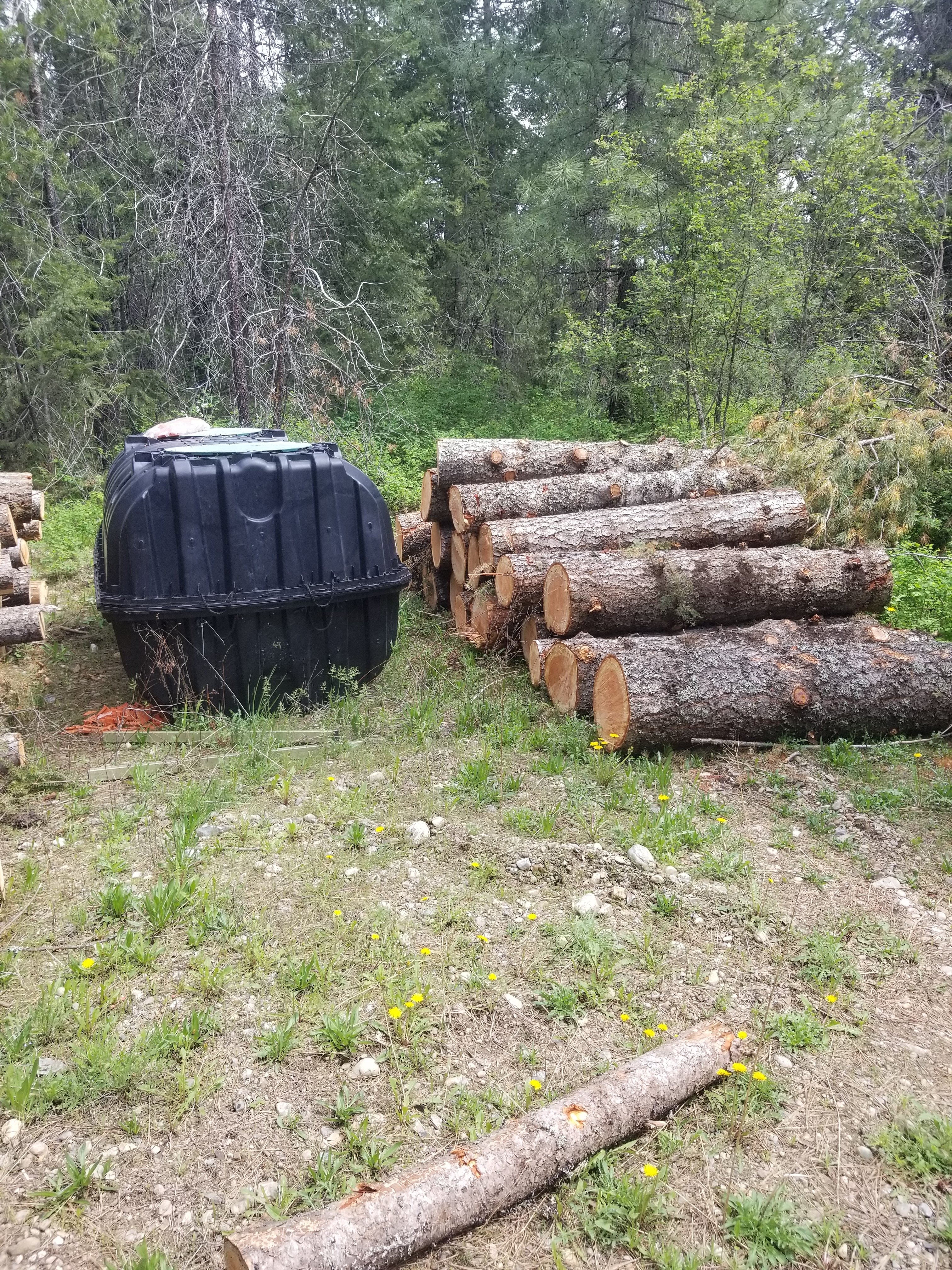

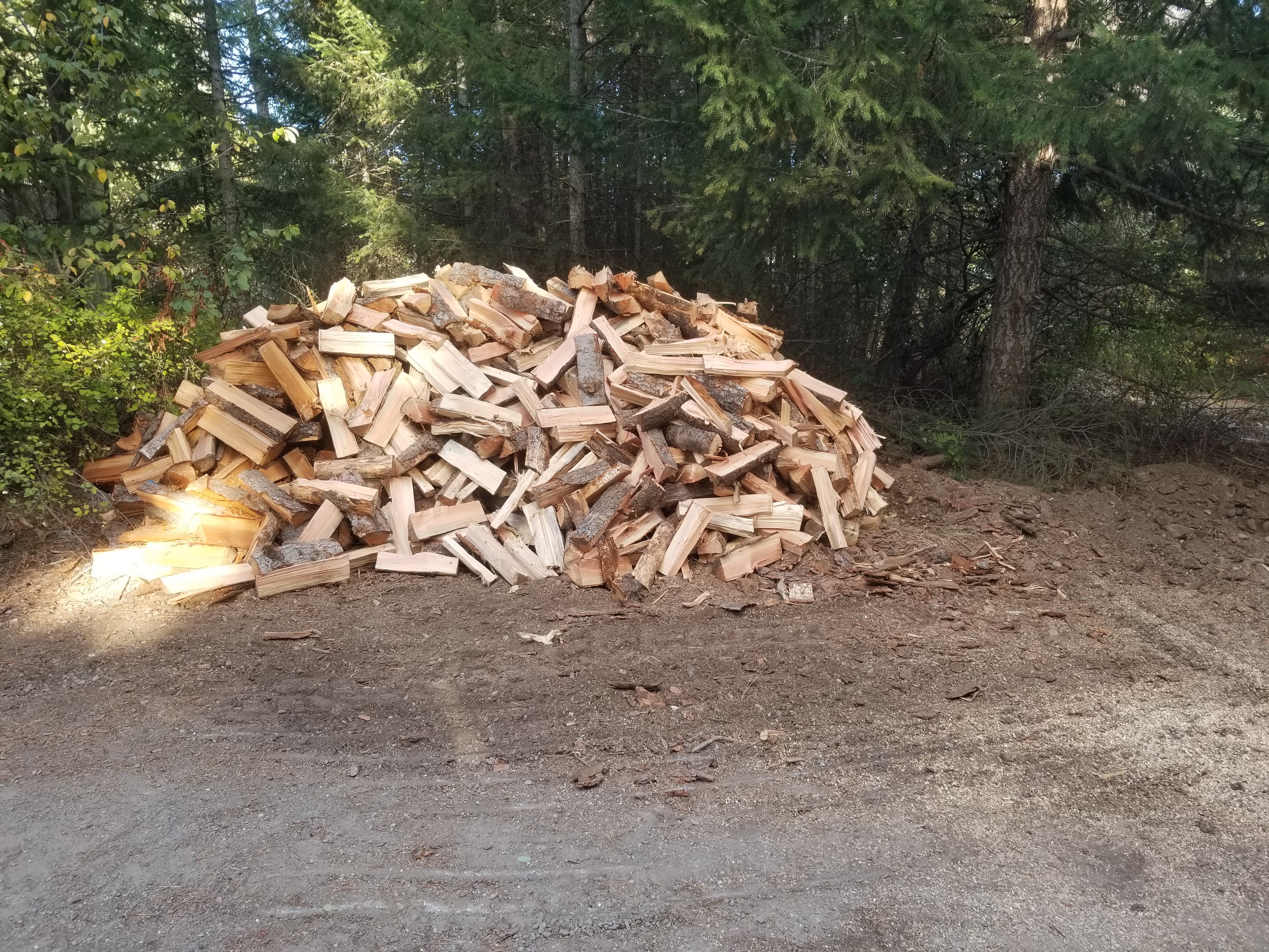

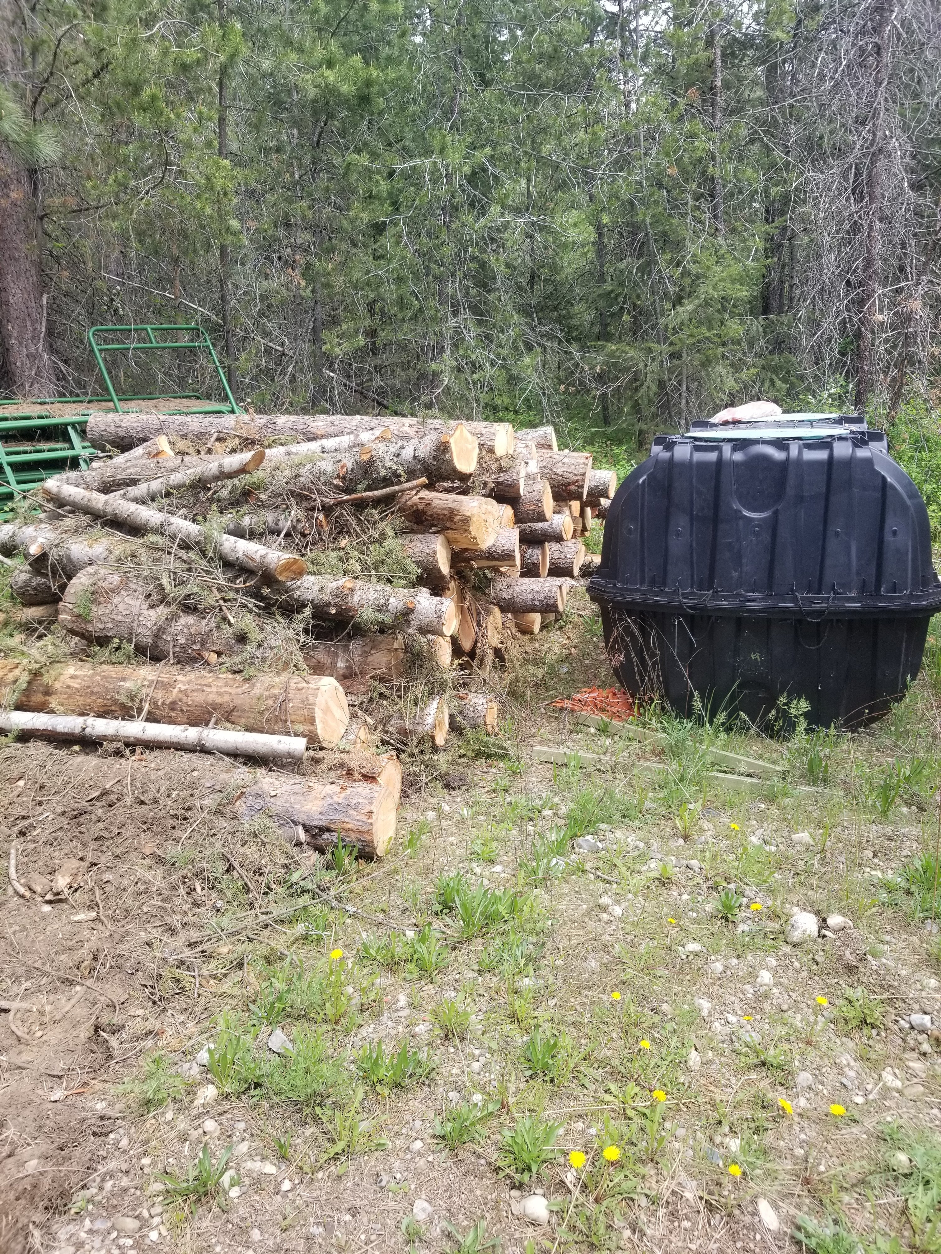

I made mine about 16 years ago. Absolutely love it. Its slower cycling than a stand alone, but i dont mind that. I still have all my fingers.
Its still plenty fast. Nothing to maintain. Mine stands up vertical so i dont have to lift the rounds.
These pictures were taken yesterday.
I always make piles of 60” long cut trees, than move these piles to cutting area. I cut the rounds there, than split and stack. Cover under tarp until it goes to storage area. I season my wood usually 2-3 seasons.

/ Thoughts on 3pt log splitters? #66
And i dont understand the tying up the tractor thing. When im splitting wood, i cant be using the tractor at the same time….
Also, i do all my logging, cutting and splitting by myself, so im not stopping anyone else from access to the tractor.
I can remove splitter in about 2 minutes if needed, or i can simply leave it on and do other chores.
Different needs for different people.
The 3 point fits my needs. The pile in the photo was made in just a few hours. Doesnt take too long. I just reposition tractor as needed into pile of rounds.
Come spring, ill use grapple and kawasaki mule to move pile for covered storage of wood.

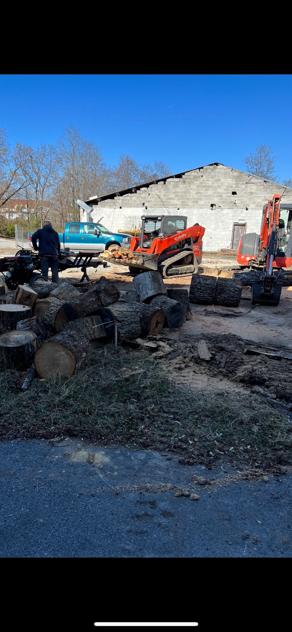

I make full use of my machines when I’m splitting wood. I load the split pieces into the skid steer bucket right off the splitter and I use the excavator to move logs for sawing and if I have a helper I’ll load the big pieces right on the log table. I don’t load every piece that way but I’ll set a couple pieces on the table and I’ll set a couple more in an easy position to roll on the log lift. That piece in the thumb is kinda small but loading them like that is a tremendous work saver when they’re 2-300 pound pieces.
