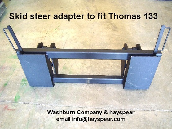

I am going to be inheriting a Thomas T133 s Skid steer. The quick attach bucket has a single handle. Is there a conversion that would convert it to a regular skid steer QA without removing the factory QA?

Is this a "mini" skid steer? Not that familiar with them but Thomas has a fair amount of dealers that should be able to help. I think you can get adapters from thomas to go back and forth from std to mini.

Will this one work?
Skidsteer adapter standardized to fit Thomas 133 loader

It would be easier to just do a quick mod to the attachments. You could just drill out the side plate (if it has one) or weld on locking tabs. This place may have a better idea.....http://www.thomasloaders.com/
http://www.thomasloaders.com/upload_files/manuals/133 Parts Manual (SN LE000537-LE002182).pdf (sec. 1.3)

Thanks Xfax. That may work. I can't believe how expensive they are.
DDbackhoe, thanks for the parts manual. I may be able to fabricate something from that.
