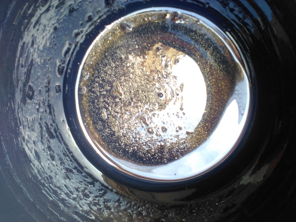

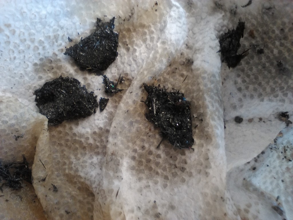

I changed the hydro fluid on my 4300 hst this weekend. I bought it used so I don't know the life it had before me. That stuff is not gold in the black bucket it is all the shavings after I poured the hydro oil out of the bucket. The other picture was the metal around the screen. It was caked in clumps. I even saw bits of blue from something I don't know.
/ this is very bad #4
how many hours? did everything work ? only thing really to do at this point is change both filters and if it has a cartrigage filter for 3 point up top change that and refill and use . I have seen some older tractors that have not had proper service with more metal or brass than that if you want you could wash with 5 gallons of diesel fuel then redrain and see if anything else come out
/ this is very bad
It has over 3000 hours on it. Every thing works. I changed removed the 3 point filter and it had metal shavings in it too. I found some blue bits in there too. I also stripped the threads of that filter so I have ordered another one.
/ this is very bad #6
I'm with the Marine. Fill her back up with new filters and run it. After a few dozen hours you might change the filters again and dissect them. But if it's still working fine that is only going to stress you more. Not knowing the history this could be from many things. I certainly wouldn't go on a hunt chasing a failure that isn't bothering anything up to this point. :)

There is good advice given above. Change filters, fill it up and maybe change just the filters in another month or two. Those probably were original filters and I've seen worse.
/ this is very bad #9
A agree that is a lot of trash and filings but why it is there is unknown. Before I did anything else I would want to assess the operation of the tractor and all related hydraulic functions. So if you have replaced the fluid, filters and cleaned the screen, how well does it operate now? I would also recommend you save out some clean buckets to catch the new oil again later.
While the shavings look bad this could have been left over from a previous repair, no way to know. There is also the possibility you have failing parts in the case or pump, I would conduct a pressure test of the hydraulic system and see how it turns out. If the tractor seems to perform well under load and everything appears to work well I would work it hard enough to get the hydraulic oil warmed up fully and then drain again to see how much trash I could get out of it. Check the screen again too. You should get a lot less filings the second time. If you get less filings then refill and use it for a few months and pay attention to any sounds of failure.
If you have refilled the fluids and operate the tractor and have problems then you will need to make the repairs. I would not jump to doomsday conclusions just yet.

I'd run it for a few hours then drain/pump out a quart or less, run that through a simple filter, like a handkerchief, and try to get a handle on the amount of particles found.

The blue stuff could be bits of permatex sealer, or parts of a seal (either the lip of the seal, or the body when it got pressed in place).
/ this is very bad #14
Filings are one thing, big chunks would be cause for some concern. But even if you found a big chunk of brass are you going to tear it down to find it were it came from, probably not.
I fly airplanes, and we are required to inspect the filters and have oil analysis done regularly. Even with airplanes there is an expected amount of wear, especially at break in. that's why we do analysis to find out which metals are wearing. If turns out not to be a wear part or we find chunks. That immediately initiates a complete tear down. Just be happy we are talking tractors 😊

Filters are there to do the job of catching the particulate matter. Job done. So, change them again according to regular maintenance schedule, or sooner and see where you're at with metal filings, etc. then. Wear is expected, it drops to the pan and gets caught in the filters, as designed. Not to worry, for now.:thumbsup:

I've read the posts on this so far and tend to agree with most, that likely little to no maintenance has been done. If you are changing fluids and filters to maintenance specs you would be unlikely to see the buildup of trash you're seeing. It is quite possible the oil has never been changed and you are seeing the accumulated wear from 3000 hrs of use. As others have suggested I'd be draining everything and changing filters frequently over the next few months.
/ this is very bad #19
If those are the original filters, then there's a good chance that the bulk of that debris is swarf and casting sand from manufacturing that the machine has cleared out of all the hiding places that stuff seems to find. Replace the filters & run a tank of fuel, then pull the filters and see if there's anything new. If it's wear debris it won't stop, but if it's original manufacturing debris, then you should see it taper off over a few filter changes.
