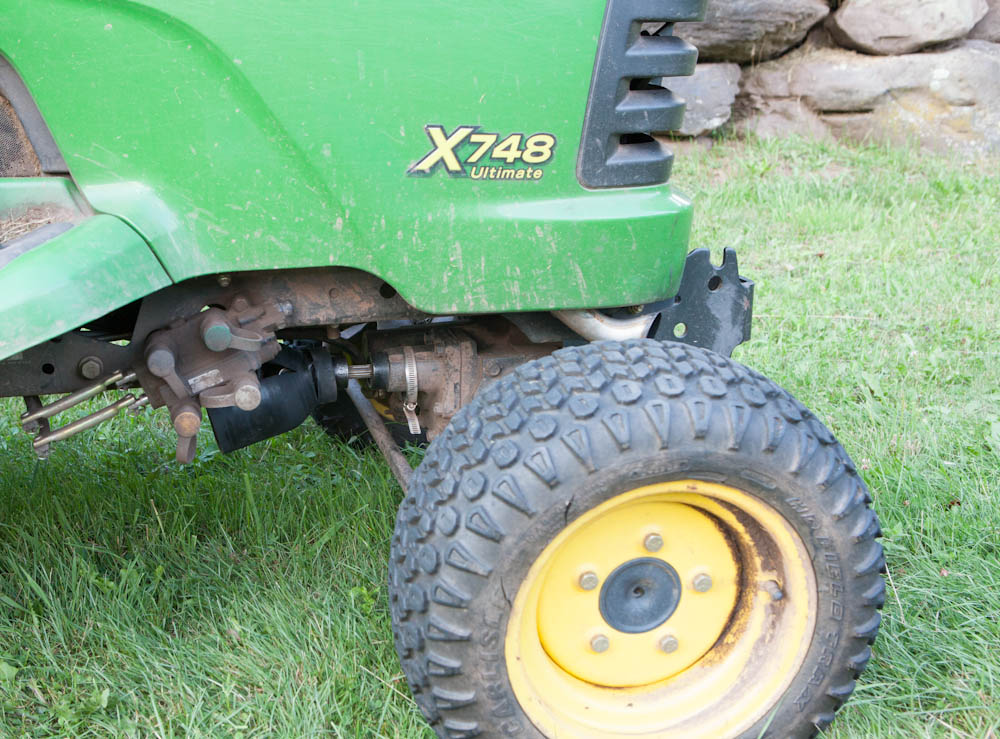

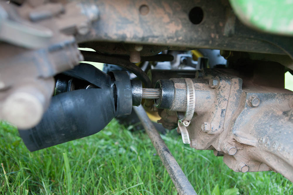

After a muddy session I was getting ready to power wash our JD 748 and saw that the rubber housing in the attached pics had been torn.
It looks to be more than a minor job to fit a new one, but also is there another piece of some kind missing where the shaft is coupled with the front axle? Just doesn't look right as I'm seeing it now but as I've never paid that much attention before so not sure what I should be seeing.
/ This doesn't look good (JD 748)? #2
Unless it is just hidden from view it seems to be missing the drive shaft. Should be something connecting from the transmission. Have you looked up underneath?
/ This doesn't look good (JD 748)? #3
The parts catalog leads me to believe that the rubber boot is there to keep the U-bolt clean and free of debris. The pipe collar "floating" ahead of it in your picture seems to back that up.
Try sliding the boot forward as you may find a release collar to pull the drive shaft back and that boot would then come right off.
That's it exactly. I had the service guy at the dealer take a look this morning and he confirmed that the rubber boot wasn't necessarily mission critical, but rather useful for the purpose you describe. I just was concerned that there may be another part or collar of some kind missing. He said if I can't get it back on in some fashion that it would be ok to remove it untill I get a replacement. Apparently the shaft itself has to be disconnected to do that given the boot is a solid piece.
Thanks to all for the input!

the protective boot is to to keep grass, weeds, fingers, etc. out of the u-joints. Is it critical for operation, no, but if you run in long grass it may wind around the drive shaft and become a real tangled messthat could lead to damage of some other components.

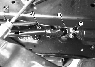

see if this helps:
1. Remove nuts (C) and bolts.
2. Slide the drive shaft (A) toward the front of the machine, removing the rear drive shaft yoke from the differential drive shaft (B).
3. Slide drive shaft toward rear of machine to remove shaft from the differential input shaft.
4. Inspect all parts for wear or damage. Replace any unserviceable parts.
Note: The U-joint yokes are not serviced separately. If either yoke is damaged, replace the drive shaft.
