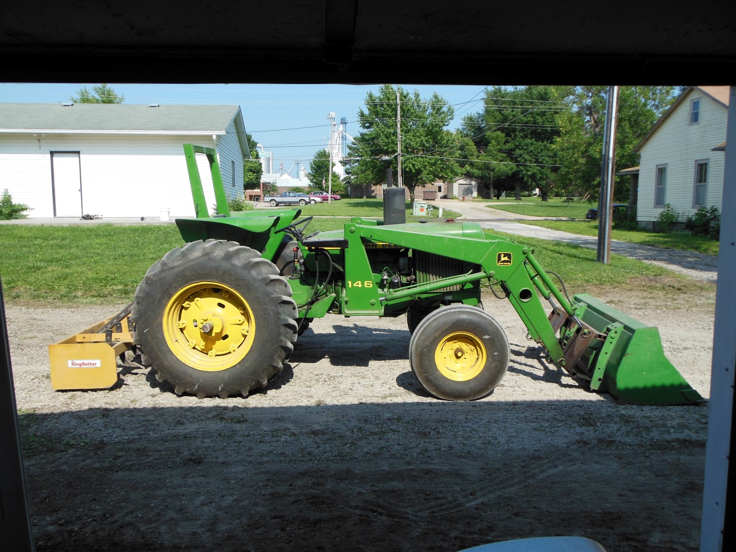

I took a few pictures when I did my project yesterday, but they mostly only showed before and after so I could see how good of a job I did and where I want to do some more work.
Here's one picture of the tractor with the blade. The tractor is a JD 2440 with JD 146 loader. A 7' blade would work better behind this tractor.

The welding shop looks like they did a good job! Do be careful using that box blade on a Cat 2 tractor. It's just not designed to take the kind of forces that a Cat-2 tractor can put out, as the previous owner learned. By reinforcing some parts of a smaller box blade, you usually just move the failure point somewhere else, so don't count on your reinforcements to make the blade Cat-2-ready.
For sure-just wonder if perhaps that box tube should have been welded to a plate instead of direct to the back plate-not so much an issue when pulling the box full of material but how about pushing with the rear blade???

That is a good point and I hadn't thought about it. I did push with it attached to the tractor above and didn't have any problems, but I was only pushing material that was already loose. If this blade ever gets K.O.'d again I'm probably going to let it stay dead depending on the damage.
P.S. I never mentioned what I have in this project:
-Blade $250
-Repairs $120
-(2) Cat 2 pins $10
-1/4th tank of gas $20.
Approx $400 plus 3.5 hours of time.
Price at Orsheln's Farm and Home is about $600 plus sales tax which would come out at about $45 to $50 in my area on that amount.

Hey Jeff,
Way to go!
Even if it is not the BB you eventually want, it sure is an amazing upgrade from what it was, worth both more than you paid out, and way more than the dealer prices you quoted.
As to going backwards to grade with it, be careful, even with Cat 2 lift arms, they are not as strong pushing as pulling and especially now that you have so greatly improved that aspect of the BB, the lift arms could be your new crumple zone.
