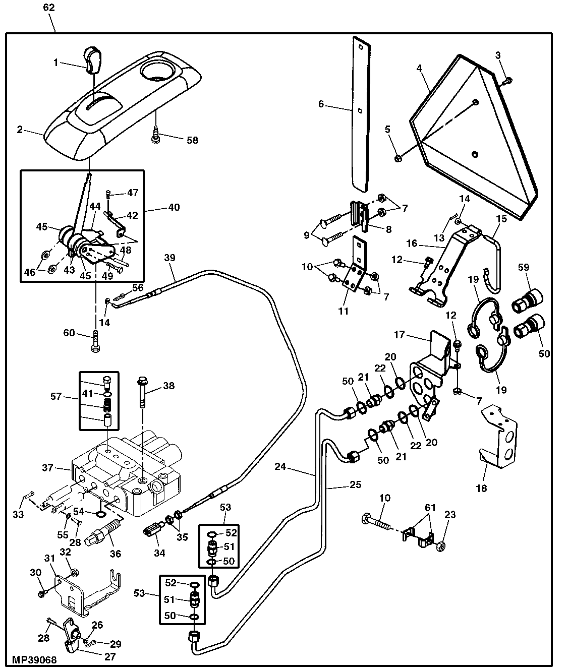

I have a 2001 JD 4200, and while prowling around underneath it and looking at the shop manual, I see there is a third spool available on the mid mounted dual SCV that controls the loader. There are two plugs for the hydraulic lines and the clevis on the spool shaft to control it.
JD does not list any upgrade kits that I have found to use the third spool; so my question is has anyone done so on their 4200, 4300, or 4400? If so, what did you run into with the project? Was it worth it to you after you were done?
I was thinking this spool could be used to control a grapple, a snow-blower chute, or other loader mounted piece of equipment.
It's tight under there, and getting a lever to work the spool could be a problem. Any thoughts on this are appreciated.
/ third spool available on mid mounted dual SCV #2
The 4200,4300,ect. already have the valve as you have found, but you do not have the means to control it. JD sold a kit that included a handle that mounted on the right fender, a cable that goes from the valve to the handle, hard lines that plumbed the valve to the rear, a bracket and QD's.
The kit sold for about $250.00. You could check your dealer and see if they can find one, they also turn up on eBay occasionally.
I can post a picture and part # from JDParts later when get home if you need...but if you can, look in JDParts under "hydraulics" and you should find it. There is also lot's of info here on TBN if you do some searching.

/ third spool available on mid mounted dual SCV #4
No problem...
I mis-led you a little though, look under "T" for Third SCV Kit Part # BM19694.
You will have to talk to a salesman though, not the parts counter because it's considered "whole goods"

Thanks for looking this up for me. I checked the 4th & 5th SCV kit instructions and one of the first things it says is to remove the third SCV if present, so it appears this kit will be of little use to me.
Now if I could just get the Quadrastat lever separately, I could run a third cable from the right fender to something of my choice. However, I was looking at the Deere online parts catalog, and they sell all the individual parts to the Quadrastat lever assembly....except the lever <GGRRRR>. The Quadrastat assembly is $100, which is a bit tough to swallow just to get a of piece sheet metal and have the rest sit in a pile collecting dust. I'll see if I can make my own lever to use with a third cable that I'll need to order.
The plastic fender cover has one slot in it, and the 4th & 5th SCV kit's instructions tell me to cut two more slots for the Quadrastat's levers. I checked Quadrastat's web site, and it confirmed what I thought that this particular set of controls was OEM specific to the 4200 - 4400 series of tractors.
