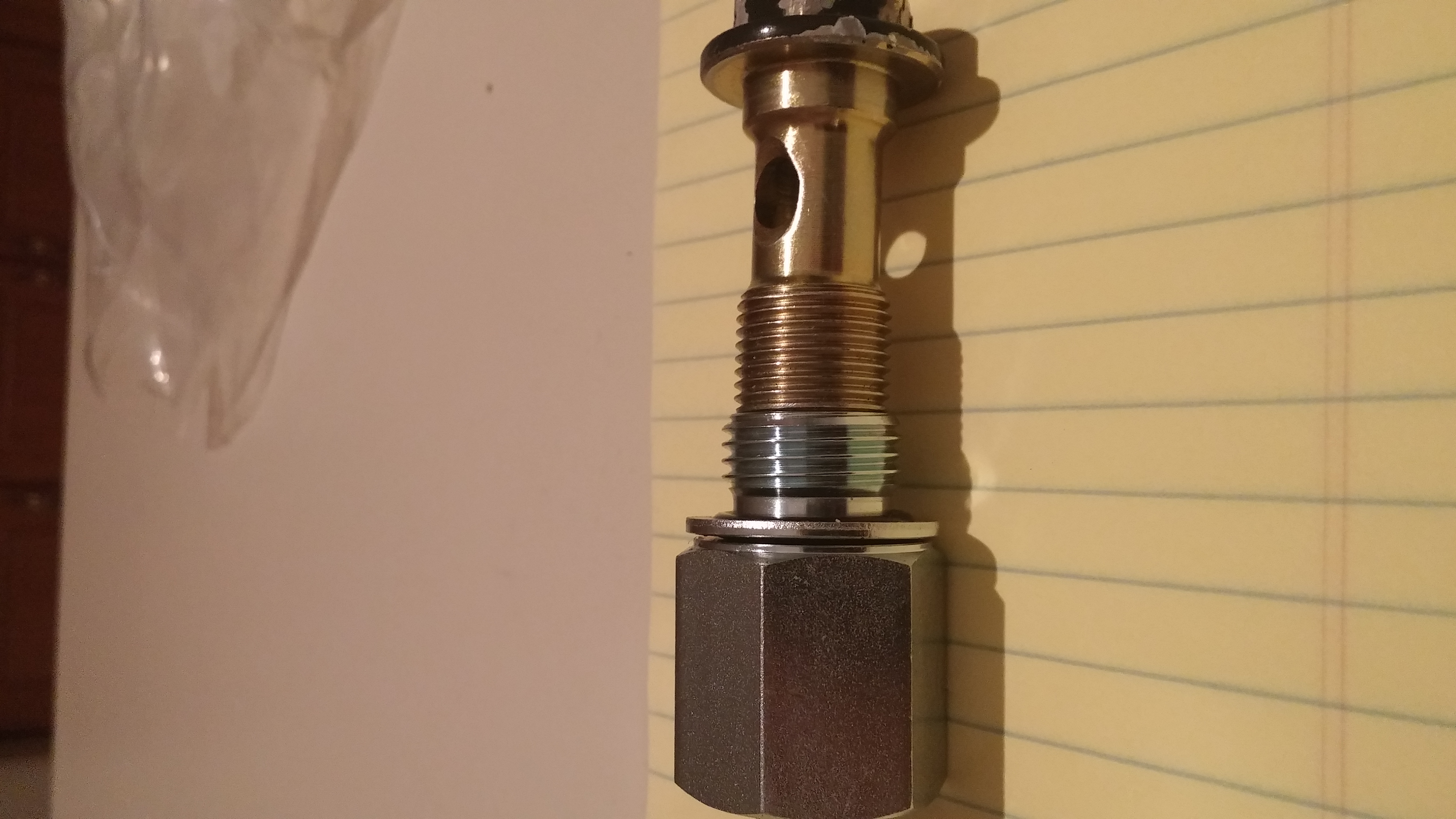

Well I did the test fitting today and these ain't it. :(
2 Things were clear though
1) The threads at least matched
2) 3/8" is too small
I did some more measuring (with real tools this time) and it looks like I needed 1/2" after all. I'll be placing a new order and sending parts back on Monday and hope to have better news by next weekend.
That would make the new part number 9035-08-08 for those following along at home.
/ Third function #15
Well I'll get to the good news another day in another thread.
The bad news is I STILL don't have the right fitting.
3/8" BSPP was too small. 1/2" BSPP (shown here) is too big.
I finally just yanked the bolt and brought it home with me and found my "good" calipers.
After several measurements the Max Dia is 17.73 mm and the Crown to Crown spacing on the threads is 1.5 mm leading me to believe this is in fact an M18 X 1.5
I will be taking the offending bolt to the local shop to see if they can measure / cross it with anything on Monday (which is probably what I should have done in the first place. :confused2: )
Further updates to follow.

Just to clarify the correct fitting to replace the Banjo Bolts & Hard line from the Loader Valve PB to the 3Pt Lift is indeed an M18X1.5 thread.
I finally bit the bullet & pulled the bolt and took it to a local shop that actually stocked Metric fittings (took a few phone calls to even find that). They verified the size & thread I thought it was by test threading it into a fitting.
Since I already had hosed made, I needed a M18-1.5 to 1/2" NPT (he only had 3/8" in stock) so he had them sent over from a store in another city and had them for me the next day (and he was also cheaper than any online price I found before shipping). Sometimes it pays to shop local.
Any how for the 1/2" version the part numbers are:
Parker - M18-1/2F8OHG
Discount Hydraulics - 9235-18-08
If you'd rather use 3/8" then they are:
Parker - M18-3/8F8OHG
Discount Hydraulics - 9235-18-06
