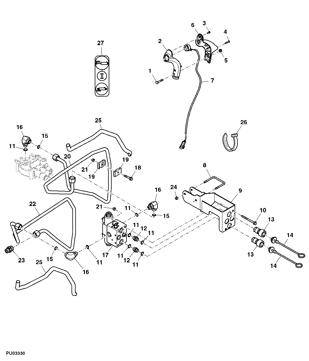

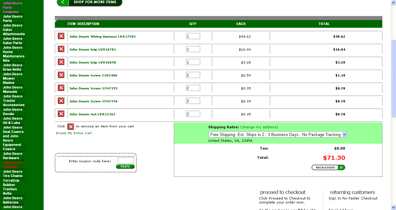

Have you received the parts? If so, a couple of questions:
How many wires, type of connector?
What is the diameter the grip fits?
Thanks!
Not sure what style of connector it is, I'll be cutting it off anyway.
There are three wires with two switches. One of the previous posters said he ordered one for a different tractor model and it had three switches.
The grip will fit a 5/8" diameter shaft.

My Kubota has a 1/2" diameter shaft so you'll probably need to make a bushing. Have you thought about how you are going to run the wires down the shaft? I think I would either use heat shrink or the nylon braided wire loom slid over the shaft before mounting the handle. I think the braided wire loom can be stretched to make it tight like the heat shrink but would be more durable. Either way I look forward to pictures once you get everything and assemble it.

Did the connector come uninstalled?
Can you post a picture?
I will measure my joystick diameter. Thanks for the info on size.
My joystick is hollow so I plan to run the wiring inside it.
I post a picture when I get a chance.
The connector is factory installed.
The wiring exits the handle from a separate hole not he shaft hole.
The wiring loom is about 5/16 thick, you may have a hard time getting into the controller shaft.
I'd bet it is metric, and if it matches mine it is 14mm (> 1/2"...), which I suspect should work with a 9/16" bore bushing, if you have a drill bit that big. Anything over 1/2" gets spendy and hard to find - no average hardware store will have it. It is a bit of a bummer that Kubota didn't use a 12.5mm or smaller shaft, but this is a special deal that not many will deal with. In my case, I ended up making a new shaft as it was the easier route. I used 1/2" rod, which worked just fine with a 1/2" bore bushing.
I'm sure it's metric and probably 14mm. But a 5/8" od 1/2" ID bushing would work well. Just put a slit in it so it can open up just a little then when the grip is tightened up it'll compress the bushing acting like a clamp.

The grip actually thru bolts to the shaft with two bolts.
So the bushings can be a hair undersized.
I'm ordering all of the loom covering,relays and master switch today.....oh yeah and diodes for the relays also.
Just need to order the valve, sub plate, hoses, and a couple of fittings. I'll have to wait until I can get up to the property to take inventory of my hydraulic parts and pieces left over from other projects beforehand.
You couldn't do that on my grip - the bushing threads inside the handle, so no way to split it and have it thread in place. It wouldn't fit.
