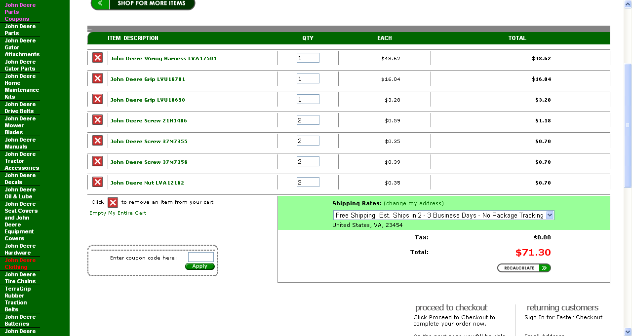

This is what I ordered for my L4240.
I did have to machine a bushing to adapt the JD control handle to the Kubota 13mm loader shaft.
The JD handle is nice ergonomic design.
You will need to use relays since the handle switches don't have a high amperage capacity.
There is another part number for the wiring harness that allows use of the third button on the control handle, but is quite a bit more expensive.

Paul,
Is there a brand name other than JD on that switch? JD buys them from somebody and marks them up from 50-100%. I hate to buy this type item on line as it is so hard to be sure it will work. There is a lot of stuff on line but hard to decipher what is made to fit a hydraulic valve handle and what is just a switch. Joy stick switches are used all over industry. A lot of the companies are foreign and it is difficult to find their US distributor. I really want to see one at the counter and determine its feasibility.

No other brand name on the switch.
For the price I thought it was a good deal.
Most all of the other control handles with switches are over $100.00
And the grip is a really good design.
