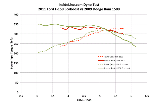

The hemi can do more work because it makes decent torque above 5252 rpms (remember the formula?).
So the HEMI doesn't make decent Torque below 5252 rpms yet the dyno graph YOU posted shows it's making the SAME Torque as the Ecoboost down to 3600 rpms. So I guess you don't think the Ecoboost makes good Torque either...

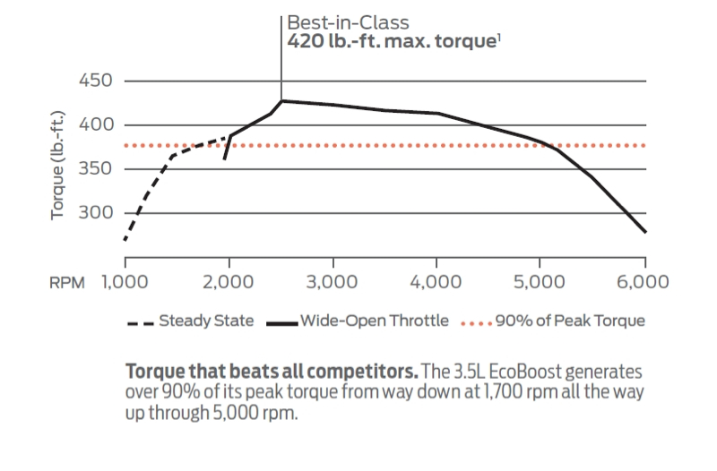

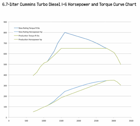

Exactly, thanks for bringing this back up AGAIN. Remember I said, just a few posts ago, that below 3700 rpms is where the ecoboost shines and the hemi flounders.
My ecoboost never gets into the 3600 rpm area even towing. It creates peak torque at 2500 rpms and over 400 lb/ft at 1800 rpms. It has a sweet range rather than a sweet spot like you mentioned your hemi has. I don't consider 3600 rpms low. Attached are the dyno curves for each motor as published in each manufacturers brochure. Plot these three engines on the same chart using the same scaling. You will then see what low rpm torque looks like.
