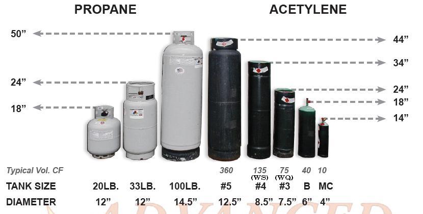

I use the WQ acetylene tank which seems to be the largest that can be owned from TSC. Although there appears to be a WS tank for ownership in some jurisdictions that would be much better ?
   / Thinking of propylene #9
Better, but still not big enough to use even the smallest rosebud - here's a comparison chart, I have the size 5 and have listed the two letter size you mentioned - you now have a size 3, the WS is a size 4. HTH... Steve
