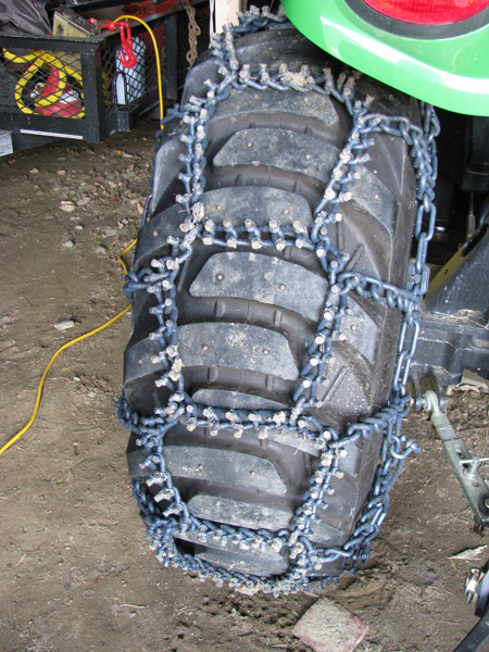

I agree that it is handy to have chains with bite (unless you have a paved driveway)...I have always gotten mine from Canadian Chain in Skowhegan Maine Canadian Chains [Agriculture Charts]. The type I have is what they call Agricultural Ladder Type.....they can custom fit these to any size tire,,,View attachment 307260....they are great on snow, more and ice...useful after an ice storm to "rough up" the driveway.
My chains are very similar, bought them at the same place you did. :) They are real beasts for traction and chewing up ice. The only drawback is they weigh a ton to handle but since they only get put on once a year, that is minor. In five years of use, only once has a coupling "c" link dropped out, and that was back in the woods on some very rough ground. And I found it!
