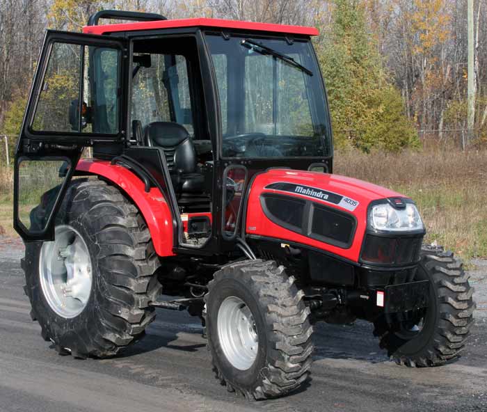

Sims cab (Cab Depot) Makes a cab for the 4035, its no cheap but it will fit without modifications.
