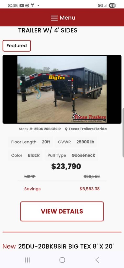

Love my dump truck. Took me a year to find one like it, but I’m thinking about replacing it with a dump trailer. Registration on my truck alone is $1,500/yr in PA. Then theres insurance, fuel, repairs, etc.
I would need a GN dump trailer with a payload of 10 tons to match the dump trucks’s payload.
I am buying a tandem axle 25’ flatbed dump truck and I’m out of room to store 2 large trucks.
Most GN dump trailers peak at about 24,000lbs. That leaves a payload of about 7+ tons. Not enough.
My Ram has been used to haul 18+ tons for the last 6 years, so a 10 ton payload + weight of a new dump trailer will be well under that.
Comes down to cost. I *think* I can get $30K + for my dump truck. I think a dump trailer built at 30,000lbs will cost about $25K.
Thoughts? I know I will miss maneuverability and toughness of a single axle dump with 4WD.
