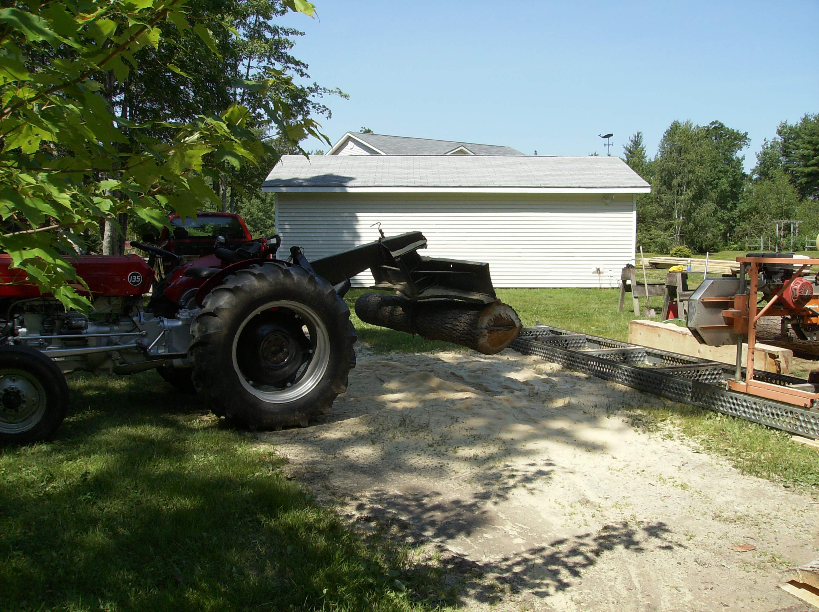

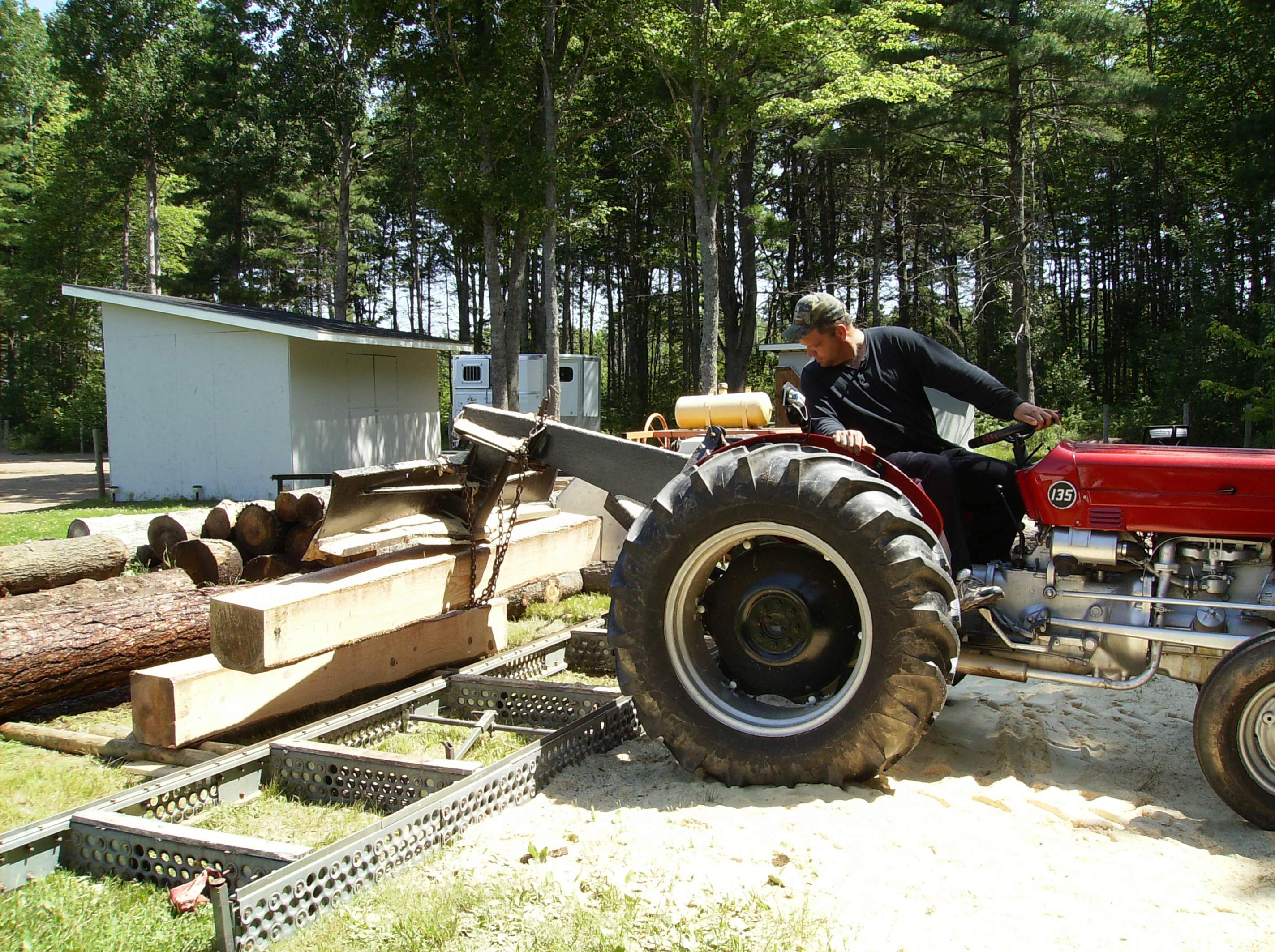

With my MF 135 I use my 7' back blade, two 10K chains/clevices. Have lifted white pine 12' length 28' butt, no loader so it does get light on the front end. I use it for skidding the logs as well, keeps the front end on the ground when the terrain gets a little uneven. I do have the tires loaded and the 135 is a very stable platform to use for this kind of work.
