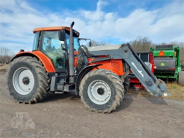

This would be the answer to my constant issue of needing to load square bales, while at same time needing to mow fields with the CX-15. Pretty much everything I want in a tractor.
Only thing holding me back is the hours. I usually stop looking at 6,000 hours. This one has well over 7,000 on original engine & CVT.
It’s pure grunt with an oversized Sisu diesel, Fendt CVT, Quicke/Alo loader, suspension and nice rubber.
Very similar to my Challenger, except it has a Sisu while my Challenger has a Perkins.

Nice looking tractor, front tires are getting down but still good for a while.
Agree. And I kind of like worn (like 50%) tires because they don’t dig up the hay fields as much-especially on turns.

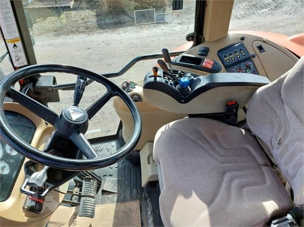

As I understand it the Agco tractors have the more intuitive CVT controls compared to CIH and JD.
I have 2 of them now. My Massey 7495 and Challenger MT535B both have them. There’s a fingertip reverser on the column that changes direction and speed, then theres a knob on the armrest that changes speed. Really nice.

The condition of the interior is “like new”. My tractors look like they are trashed inside compared to this one.

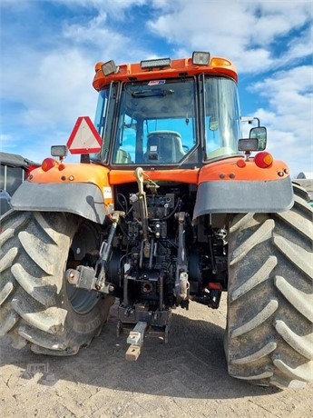

Wish it had front 3-point/PTO, but…..
